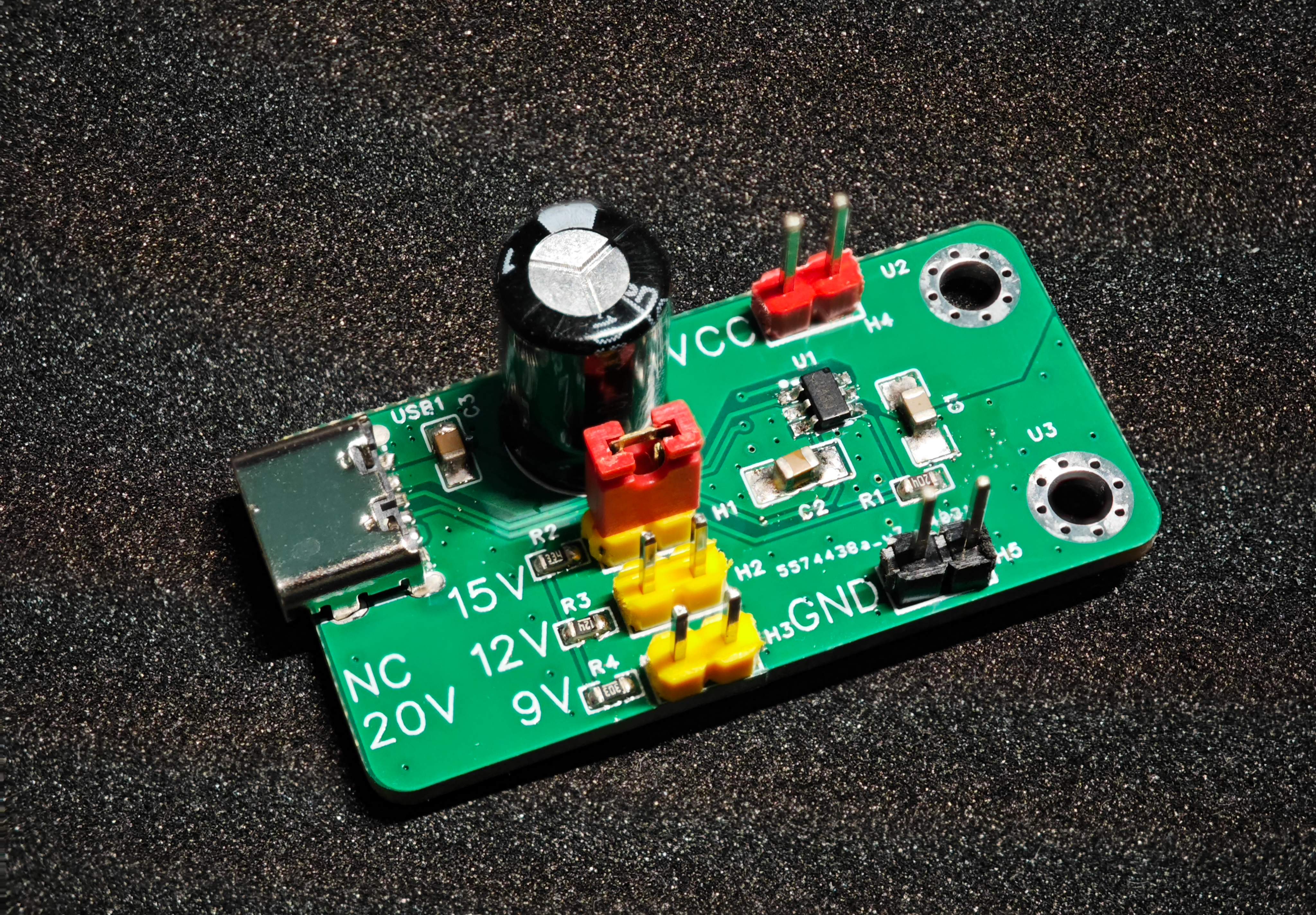

ECP5701 PD deception
 ECP5701 PD Spoofing
1. Introduction
For more details, please refer to the datasheet

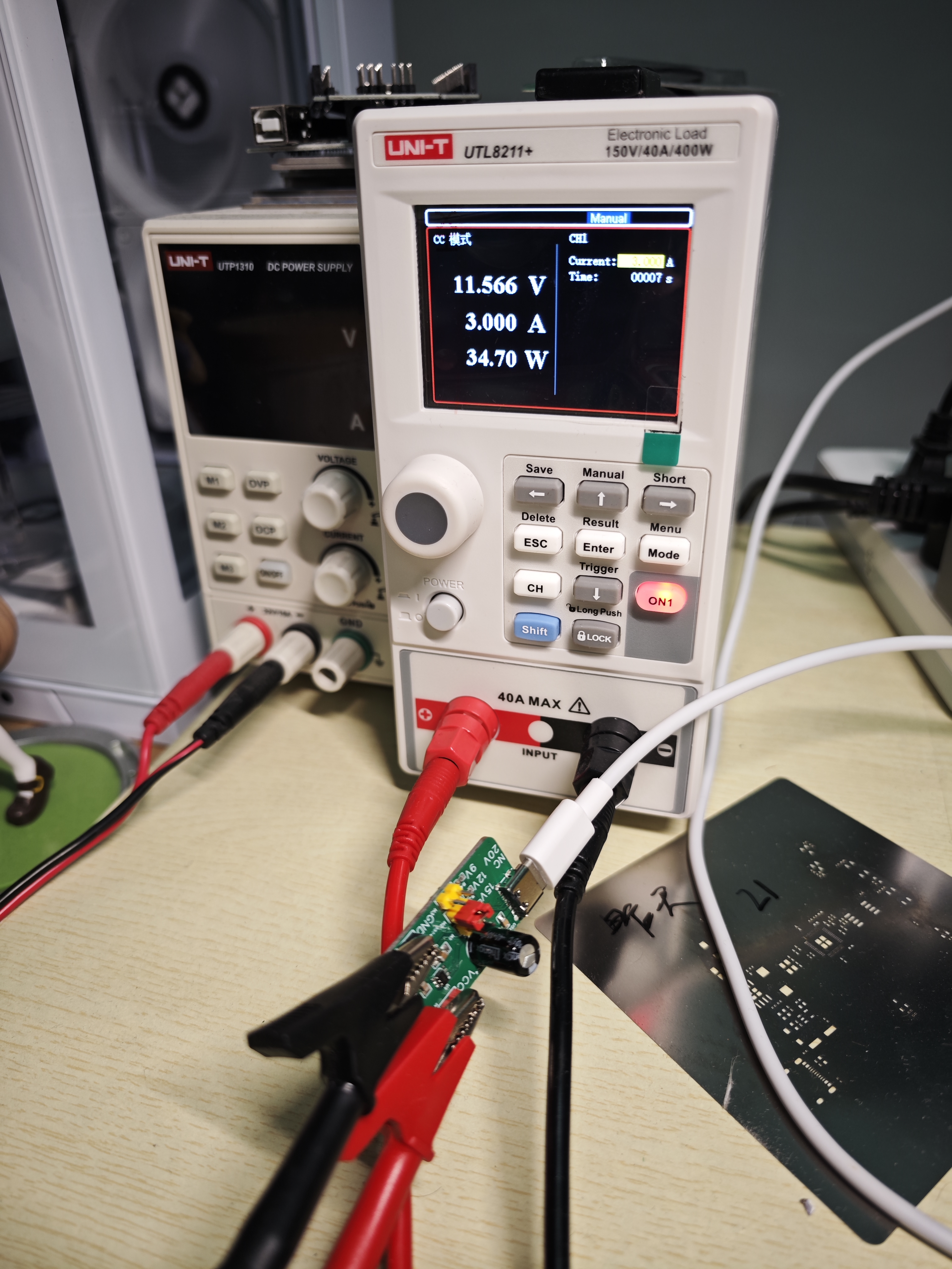

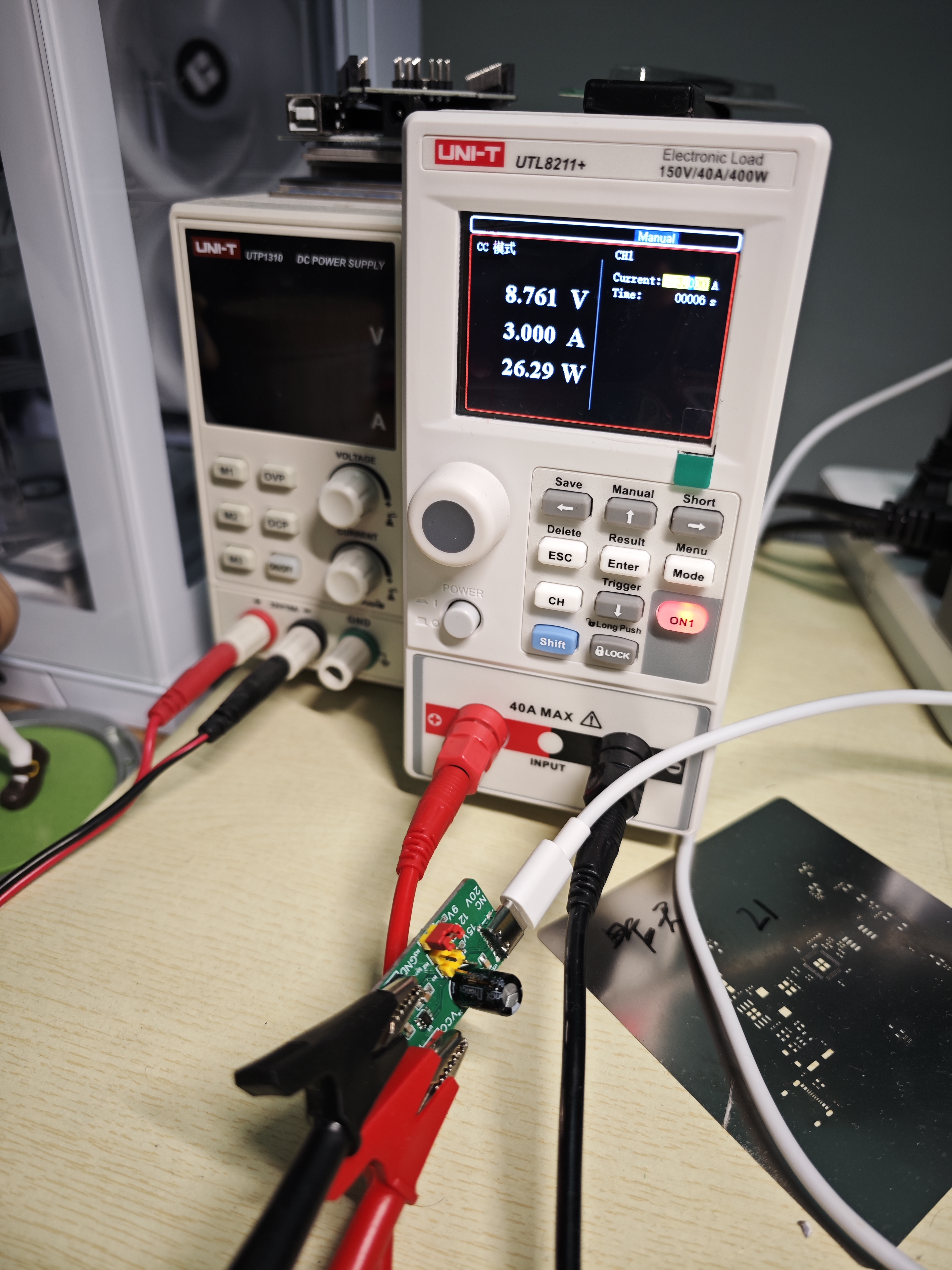

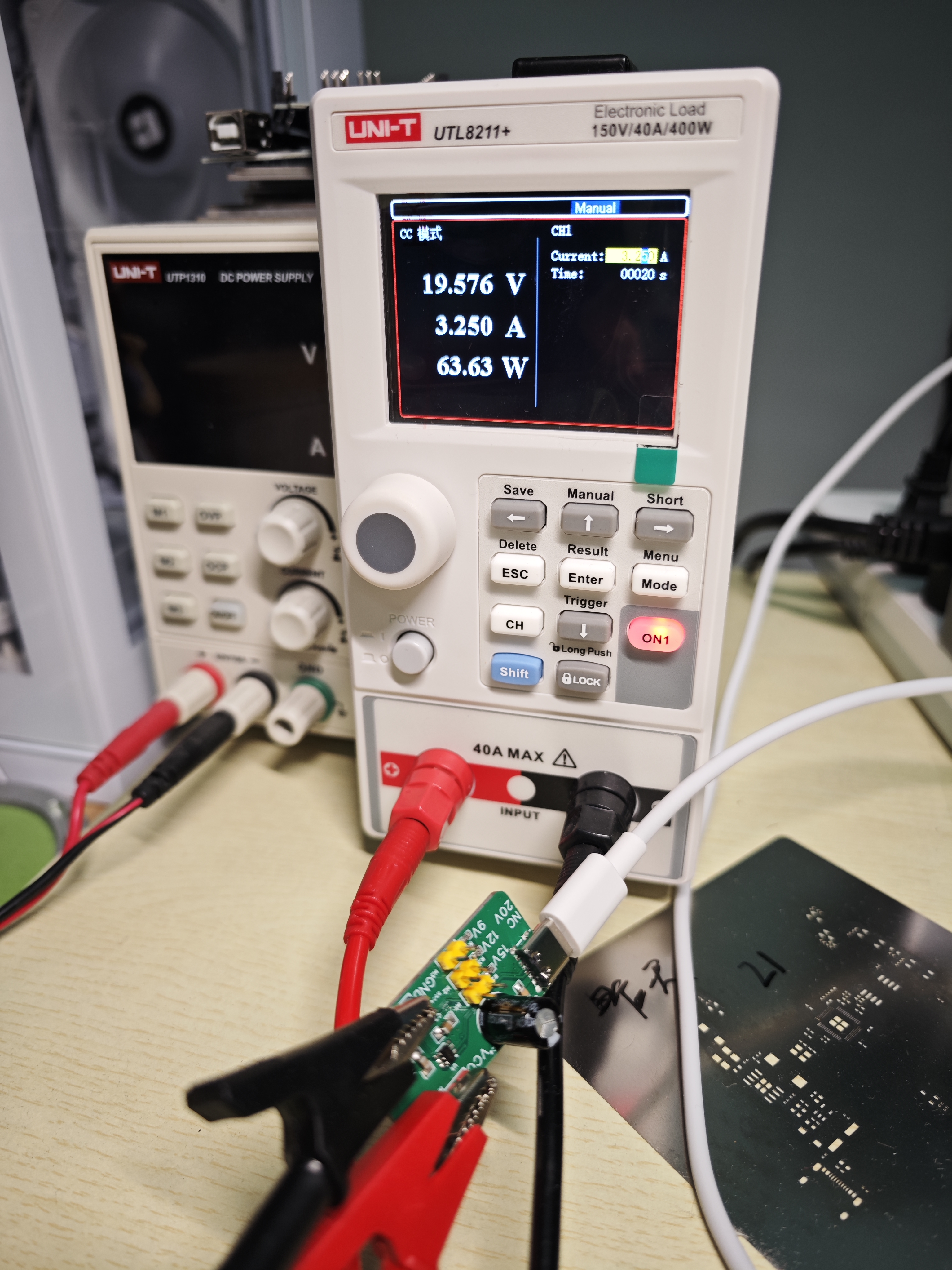

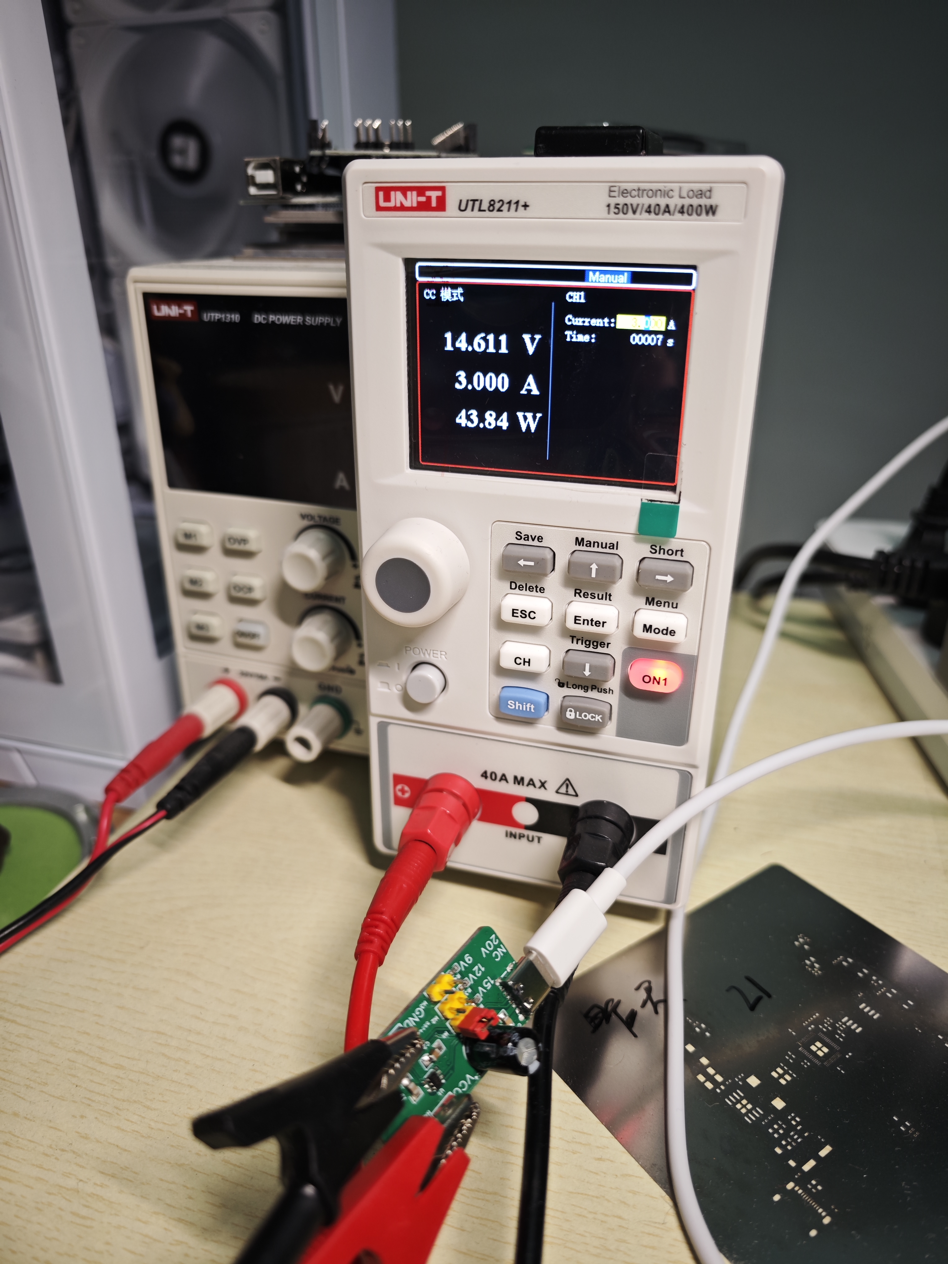

. 2. Testing
During testing, shorting different jumper cap positions will produce different voltages.
Note! Changing the jumper cap after powering on will not change the voltage; you need to unplug and replug the USB-C port for the change to take effect.

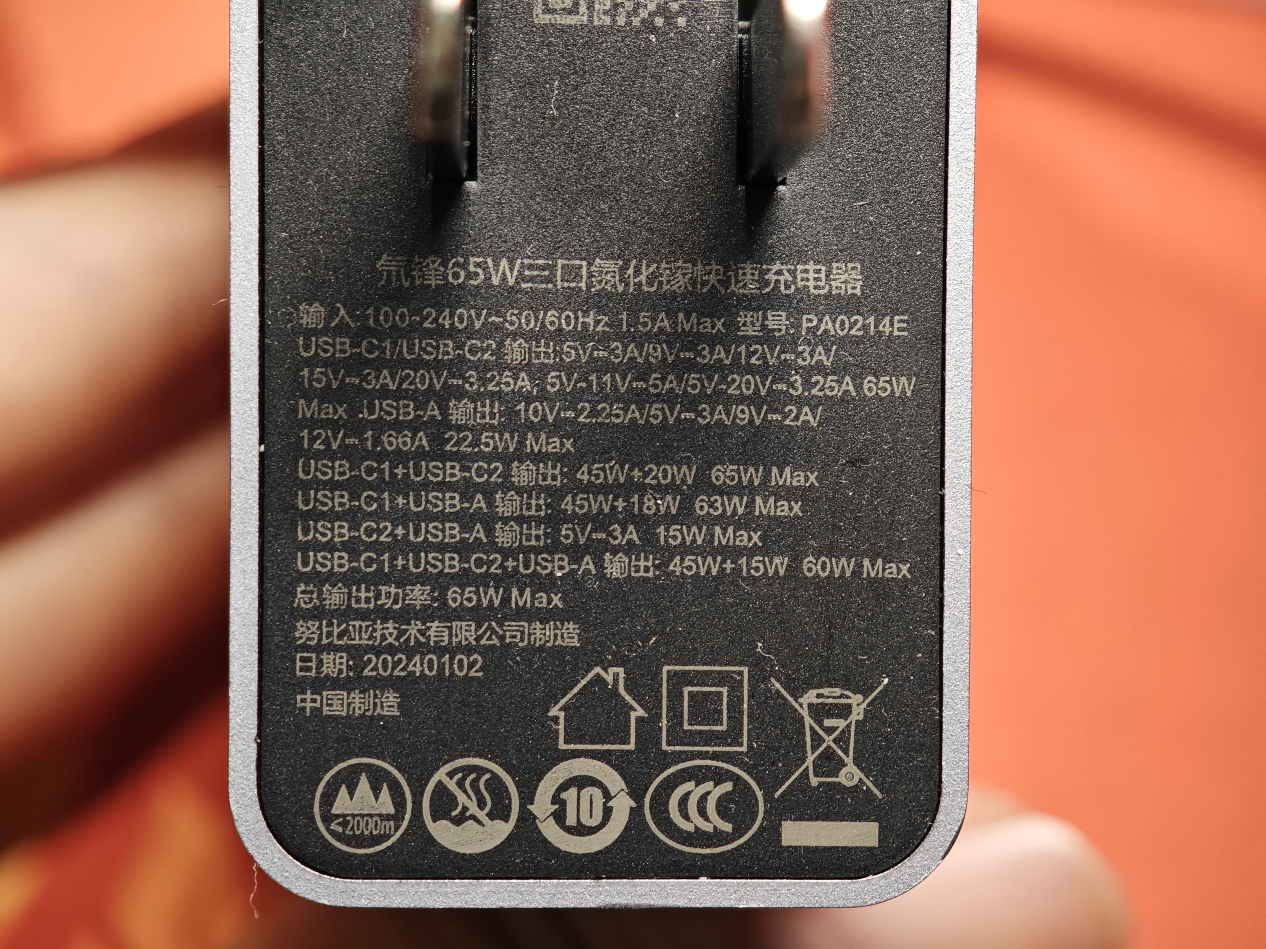

I used a Deuterium 65W charger with a Type-C 2 port for testing.
The specifications are as follows:
20V 3.25A
, 15V 3A
, 12V 3A,
9V 3A.
I also tested and verified a ZMI 65W GaN charger, but I won't include pictures here.
