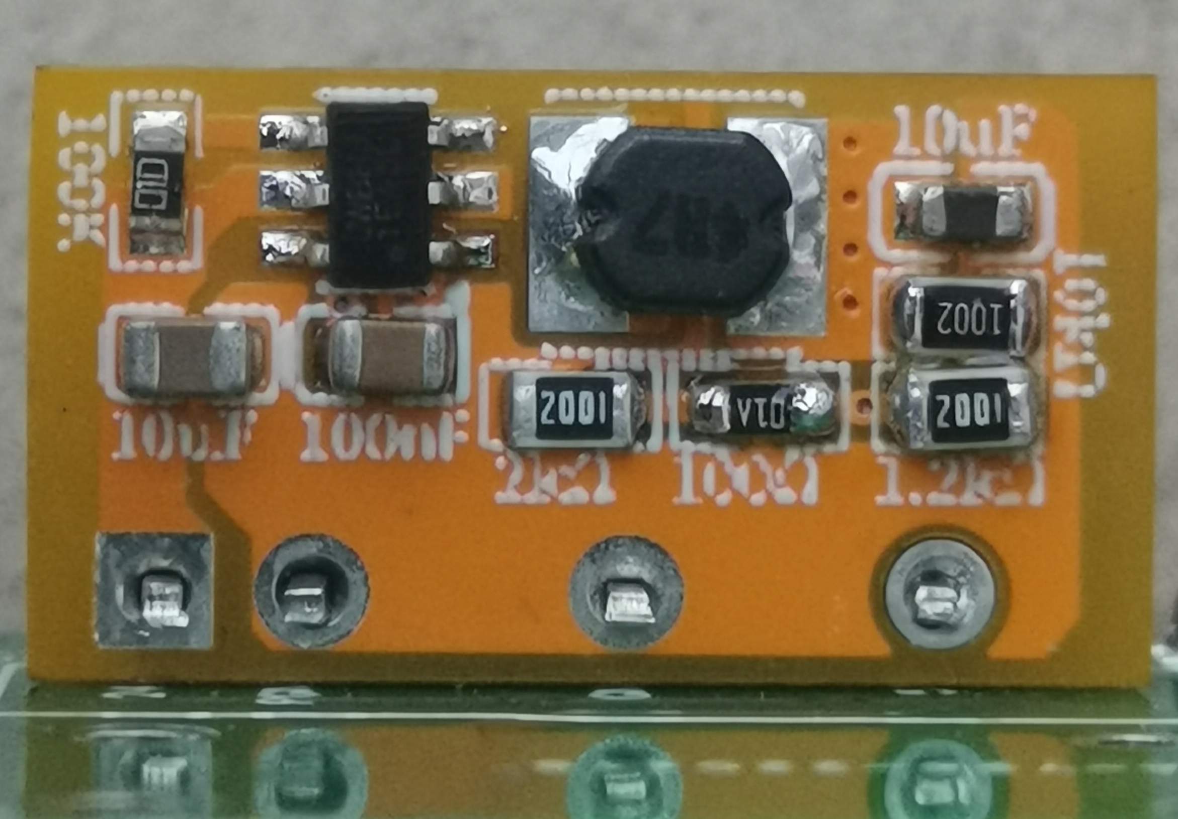

The module has been tested and the output power is about 3w. It is a 5v step-down module for the T12-858 two-in-one universal soldering station (Address: https://oshwhub.com/mojinyinhu/t12858-tong-yong-han-tait ). Of course, it can also be used for other purposes.
Please pay attention to the withstand voltage of the capacitor during installation. BOM please follow the schematic diagram. The actual picture does not have the appropriate resistor superimposition, so it will look different.
