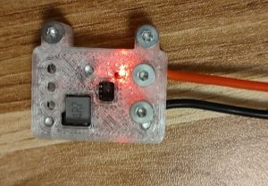

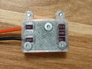

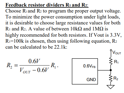

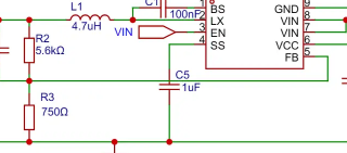

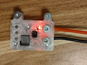

supports 4.5V-30V input voltage. R2 and R3 in the schematic correspond to R1 and R2 in the datasheet for adjusting the output voltage. The datasheet recommends using resistors with a value of 10kΩ to 1MΩ. It is recommended to adjust the 5V output before soldering the 3V3 section. M3 screws are screwed into the holes on

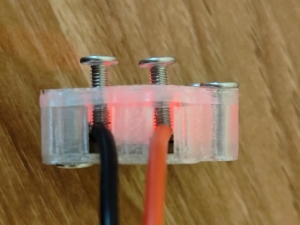

back , and
sides
of the casing to ensure the wires are flush with the pads; soldering is not required in these cases.
