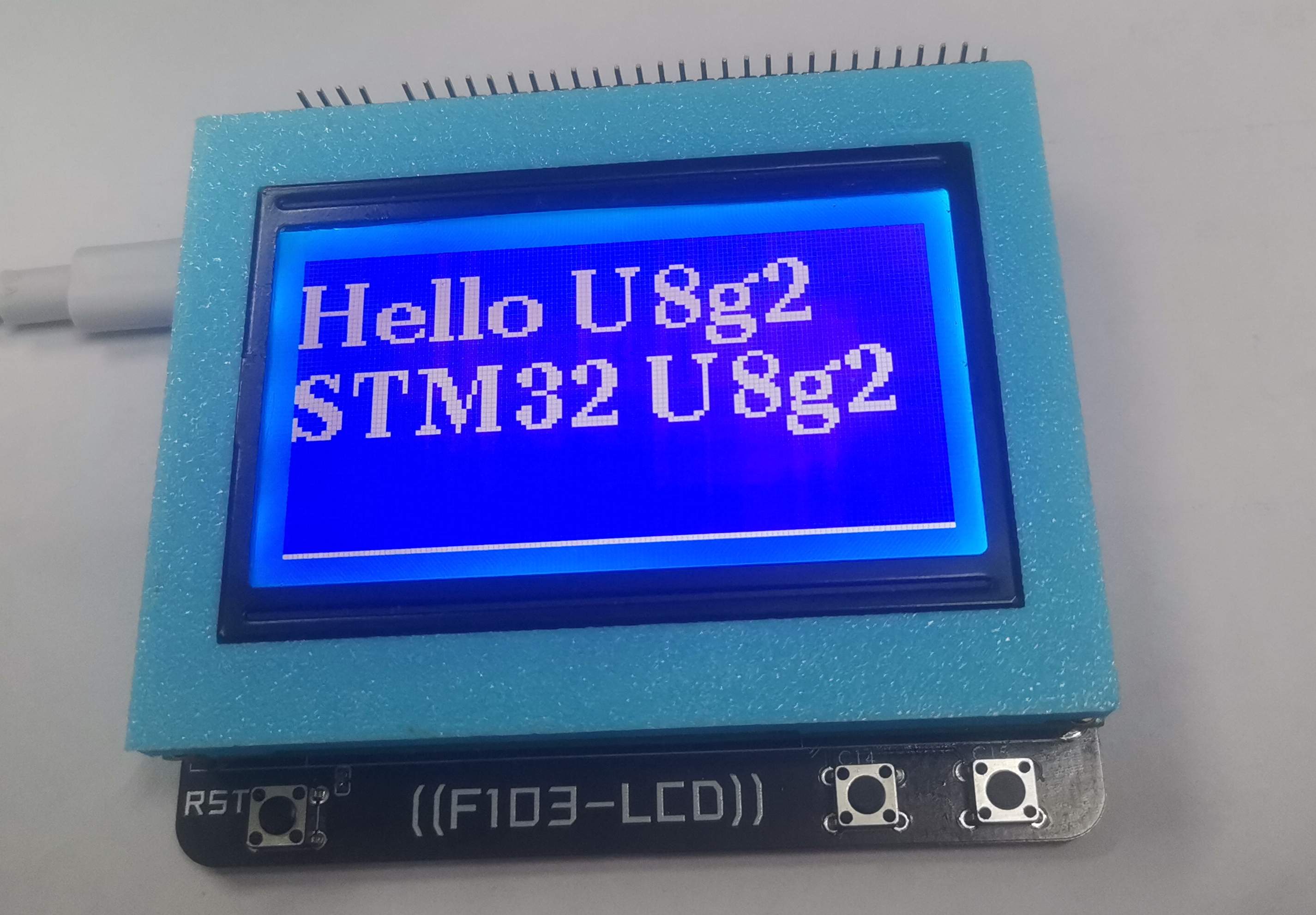

STM32F103 U8G2 Development Board
The main controller is an STM32F103C8T6
, and the screen is an LCD12864 (ST7920). With the 3D-printed casing, it looks quite good.
The screen driver is a built-in serial
CH552G, used for DAP-LINK
development with U8G2. For learning how to use
the CH552G as a link, see the LSPIClink tutorial: LCSC Liangshanpai development board with DAPlink using the CH552G as the downloader controller. LCSC development board official website: lckfb.com (gitee.com)
