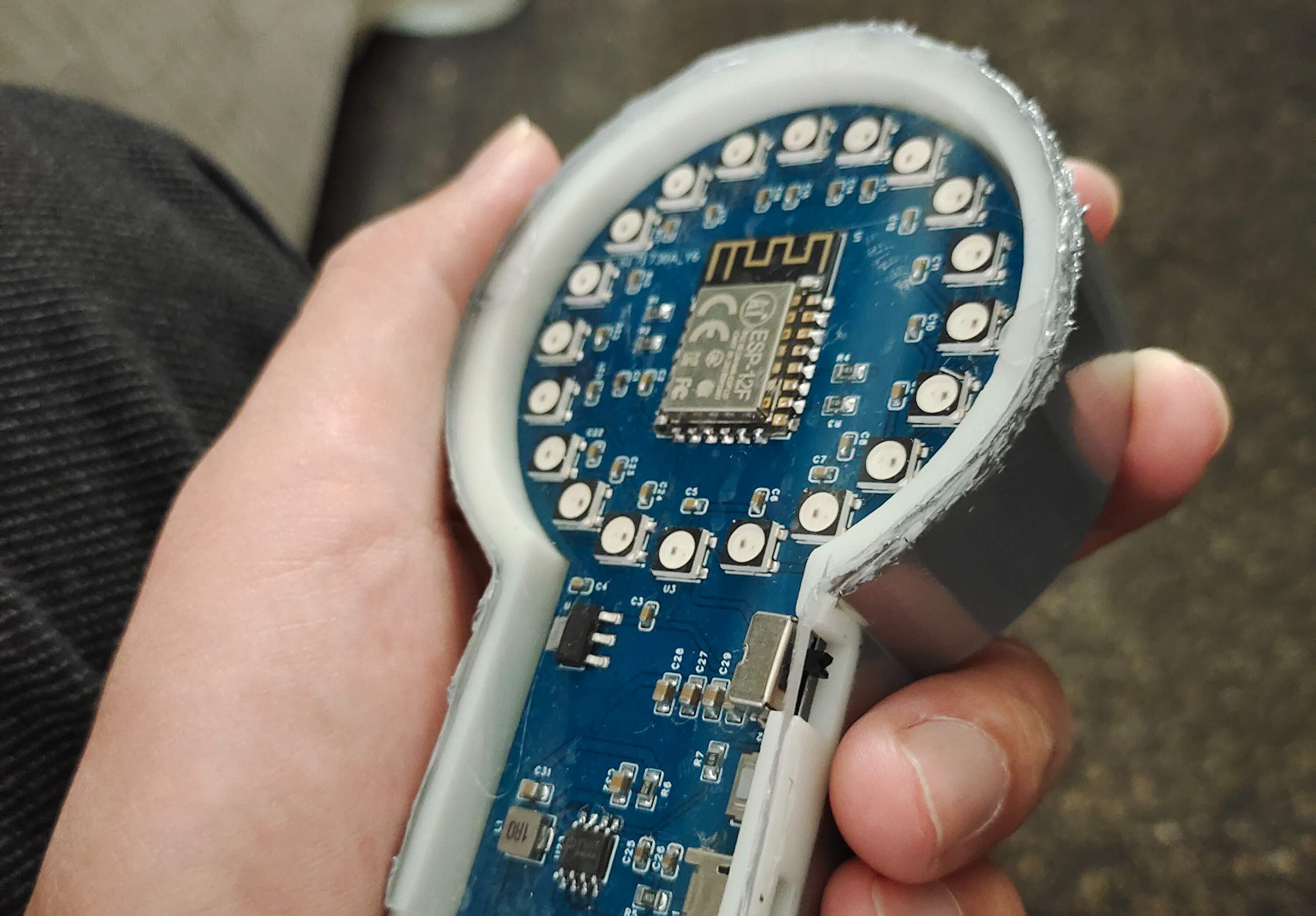

A small mobile lantern.
It uses esp8266 master control and micropython language to control 20 ws2812 lanterns. The shape is set to circular. Using one section of 18650 for power supply, the light viewing
program can be run on the esp8266nodmcu + color light strip anytime and anywhere.
For the sake of aesthetics, the PCB does not leave a programming interface.
First, use a programming socket to program the esp8266 module, and then solder it to the PCB.
Estimated functions:
1. Display 15 different ring-shaped lantern dynamic effects. (Implementation)
2. Via esp8266 WiFi Functional mobile phone-computer connection realizes control of mobile phone and computer. (Implementation)
3. MQTT control is connected to the mobile phone WiFi, and remote control allows friends to watch the lights (Implementation) Video 5
4. Select 12 colored lights to achieve the clock effect. The (implementation) video is demonstrated on a homemade burning socket.
--Red is the hour, yellow is the minute, and there are 5 colors for the second, which are used to display the single digits of the minute, such as video.
You can also choose WLED and LEDFX projects on the network. Video 4
B station link: https://www.bilibili.com/video/BV1GM411u7zy/?spm_id_from=333.999.0.0
Before 40 seconds it is your own program, between 40 seconds and 50 seconds it is WLED, and after 50 seconds it is LEDFX that beats with the music.
Disadvantages: After the esp8266 module is welded, it is troublesome to update and burn the program. Be sure to test it on esp8266nodmcu or a homemade programming socket.
Complete verification that the following video
attachment has WLED firmware and LEDFX installer. Please try it yourself.
