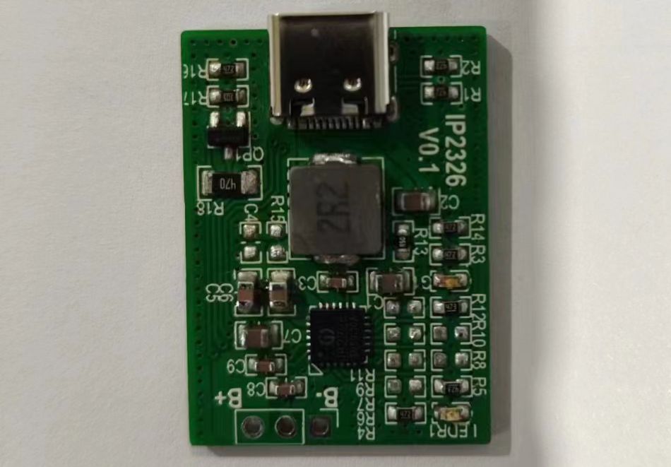

2-3 battery cells charging: IP2326 (2 cells with charging equalization)
Function Description:

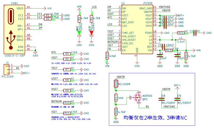

USB 5V input, synchronous boost, charges 2 or 3 series batteries, maximum current at the battery end is approximately 1.5A, maximum charging power is approximately 15W.
Input voltage:
4.5~9.5V. 25V Max. 4.5V triggers undervoltage protection, automatically reducing charging power.
Output voltage:
2*(4.25/4.35/4345/4.65V±0.05V) .
Trickle charging
threshold: 2*(3.0V±0.05V), trickle current 50mA~150mA .
Full charge cutoff:
300mA±10mA. (When the chip output reaches 2*(4.25/4.35/4345/4.65V±0.05V), and the battery output does not reach it, the charging process switches from constant current charging to constant voltage charging. The higher the internal resistance of the battery cell and wires, the longer the constant voltage charging time.)
The LED
output is high during charging and low when fully charged. It flashes in case of an abnormality.

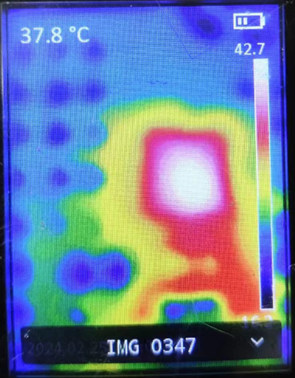

The NTC chip

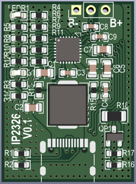

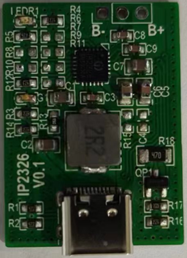

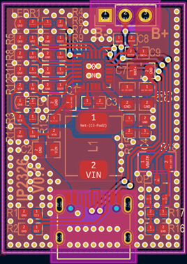

supports over-temperature protection with a built-in over-temperature protection up to 135℃. Input Voltage Input Current Output Voltage Output Current Power Supply Power Efficiency 5.95V 2.51A 12.62V 1.10A 14.94W 92.92% 5.87V 2.28A 8.46V 1.50A 13.41W 94.63% Charging Temperature Schematic PCB Layout PCB 3D Preview PCB Physical Image Data Download https://oshwhub.com/saber.lily Other design files can be obtained from your supplier.
