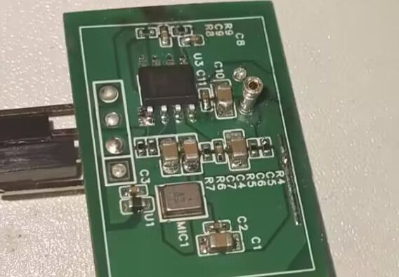

MEMS microphone
The MEMS microphone's analog output is amplified into an AC signal after DC bias by an NE5532, with an amplification factor of 11, producing output 1. This output 1 is then filtered through a 1kHz low-pass filter to obtain output 2.
In actual testing, the module's overall current is approximately 4mA under a 3.3V power supply.
Laptop microphone power supply ports have an output current of 40~100uA, so they cannot be used directly. Laptop
testing method: The laptop's USB port is used to power the module via an LDO to 3.3V converter. The microphone input signal interface is directly connected to the microphone module's output pin. (Note: The last two sentences appear to be unrelated and possibly machine-generated text.)
