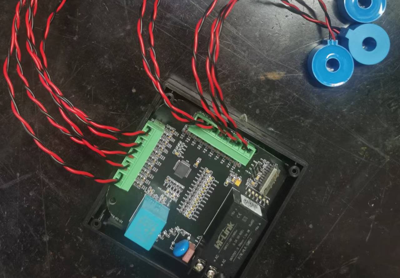

ESP8525 controls BL9010 to collect 10-channel power data.
This design is based on polisher's [Hardware DIY] "DIY ESPhome: Homemade Multi-Channel WiFi Power Meter for Beginners". The original hardware was for 6 channels. This design was adjusted and rearranged, with external components modified according to the Belling BL0910 PDF, and register parameters modified as described in the original. It was prototyped and successfully tested at JLCPCB to achieve 10-channel power acquisition. Components meet Belling's accuracy and parameter requirements. The WiFi chip used is the ESP8285. Status indicator lights and overcurrent indicator lights for each channel were added for easier monitoring of RXD and TXD transmission/reception. Other issues can be found in the original author's documentation.
