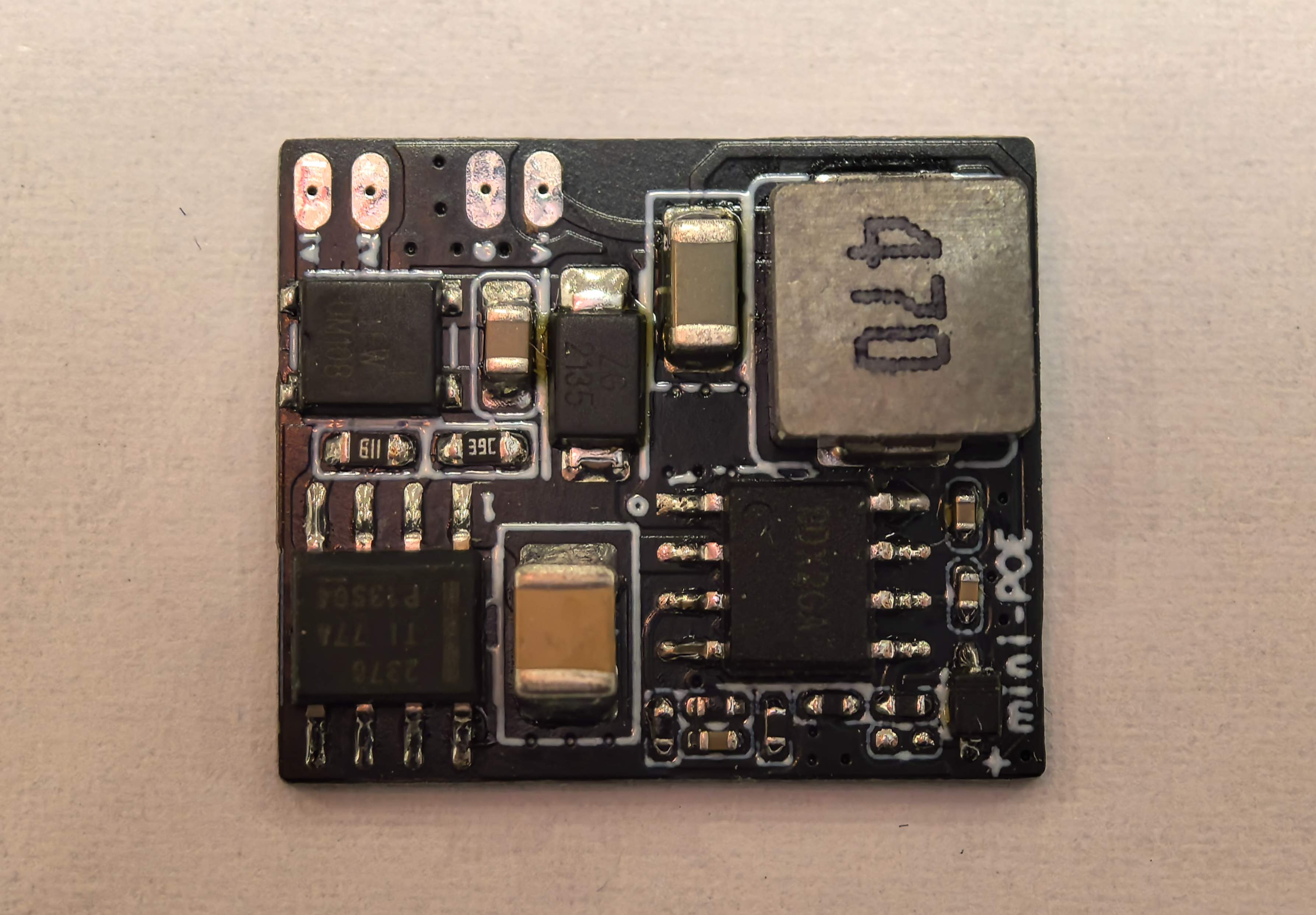

Background:
I've been upgrading my smart home system recently.
Since there are excess network cables pre-installed on the ceiling, I considered mounting the gateways ceiling-mounted and powering them via PoE.
However, Xiaomi's central gateway and multi-mode gateway both use external adapters, and the PoE splitters on Taobao are bulky and unsightly.
Therefore, this project was created to build a PoE power module installed inside the gateways.
I measured the power consumption of the central gateway and multi-mode gateways and found that the central gateway's maximum power is no more than 5W (12V), and the multi-mode gateway's is less than 3W (5V).
Therefore, the AF standard is sufficient for PoE.
Design:
The design power only needs to meet 5W for continuous operation. Considering the module needs to be integrated into the network management system, a non-isolated DC-DC solution was chosen.
1. Choose a chip that integrates PD and buck controller, such as the Si3406. 2. Choose an
independent PD chip + high-voltage buck chip.
Previously, I tested the Si3406 non-isolated solution, which had a relatively high temperature rise. Therefore, I prioritized an independent PD chip + high-voltage buck
chip. Selection:
1. There are many PD chip options. The most commonly used are the TPS2378 and XS2100S. For cost considerations, the 2100S was chosen.
2. Choosing a high-voltage buck chip is more challenging. Considering voltage withstand, size, and temperature rise, I searched for a long time before finally choosing the SY8502. Although it's not small, its performance is quite good.
Debugging and Testing
(To be supplemented
) Gateway Modification:
1. After disassembling the gateway, locate the center tap of the network transformer.
2. Measure the two center taps (1, 2, 3, 6). If they are connected, they need to be isolated from the PCB.
3. Remove the Bobsmith circuit
. 4. Connect the center tap to A1 and A2 of the module, regardless of polarity.
5. Locate the gateway power supply circuit, find the large input capacitor, and connect it directly to the module's G and V+. Pay close attention to the polarity here; do not get it wrong.
6. Apply thermally conductive double-sided tape to the back of the module, find an empty slot on the motherboard (near the power supply), and attach it directly to the motherboard for heat dissipation.
7. Directly plug it into the PoE switch and power it on for testing.
