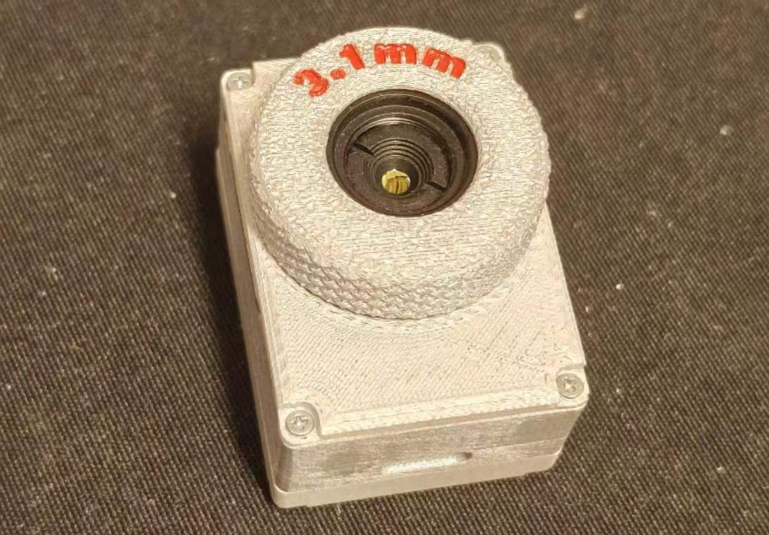

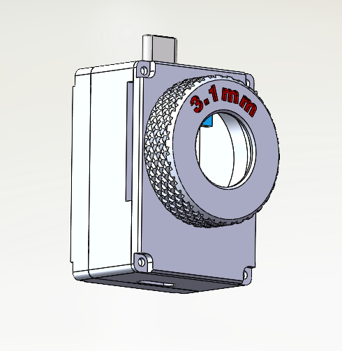

Using the Hikvision TB-4117-3/s thermal imaging module, the original outer shell has been discarded and the internal modules have been redesigned for a more compact structure.
It provides FDM printing and CNC machining of parts, and recently it can be used with JLCPCB for one-yuan CNC prototyping, resulting in an exceptionally high-quality finish!
It supports Type-C male/female connectors for easier expansion and
is compatible with 3.1/6.2/9.7/15mm lenses, basically covering most lens types on the market.
It provides FPC cables to avoid the hassle of using external cables.

The shell consists of four parts: lens ring, top plate, middle shell, and base. Please download the corresponding model from the file for CNC machining or FDM printing. Model
parameters

The PCB uses a 0.8mm thick double-layer board and does not require a half-hole process. Any residual copper from the half-hole can be removed and trimmed.
The top side of the PCB is marked with an upward orientation during assembly. The resistor below "debug" is for debugging purposes and does not require soldering under normal use. To enter debug mode, short-circuit the pads or solder a 0Ω resistor. The
FPC cable adapter board pin length can be trimmed to the appropriate length according to assembly needs.
The FPC cable motherboard pins are marked VCC and GND; align them with the markings on the motherboard for the correct orientation. The outer
casing requires injection-molded nuts; use a hot soldering iron to melt the nuts into the printed part.
Due to printer variations, the lens ring uses a clearance fit assembly. It can be glued or adjusted until an interference fit is achieved so the lens fits snugly.
