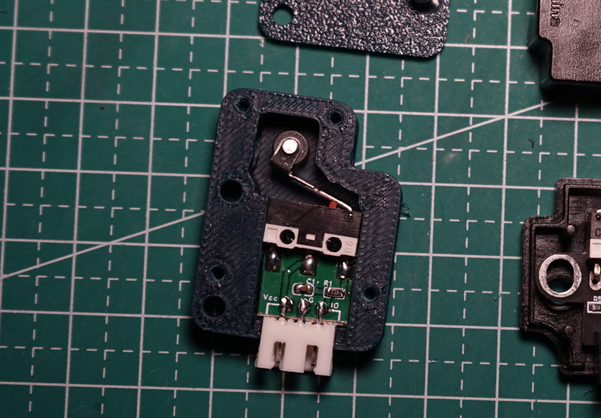

Material breakage detector
Suitable for 1.75mm diameter wire, this design uses a microswitch with a roller and a low-pass filter built with resistors and capacitors to reduce false alarms. It performs well in actual use.
PS: Compared to a wire breakage detector bought online, which uses a 0-ohm resistor and a capacitor of about 100nF for filtering, this design uses a 47kΩ resistor and a 1uF capacitor for filtering, resulting in a significant improvement in performance. On my homemade automatic wire reel, the online-bought wire breakage detector frequently gave false alarms, causing the machine to stop, while the homemade one did not have this problem.
