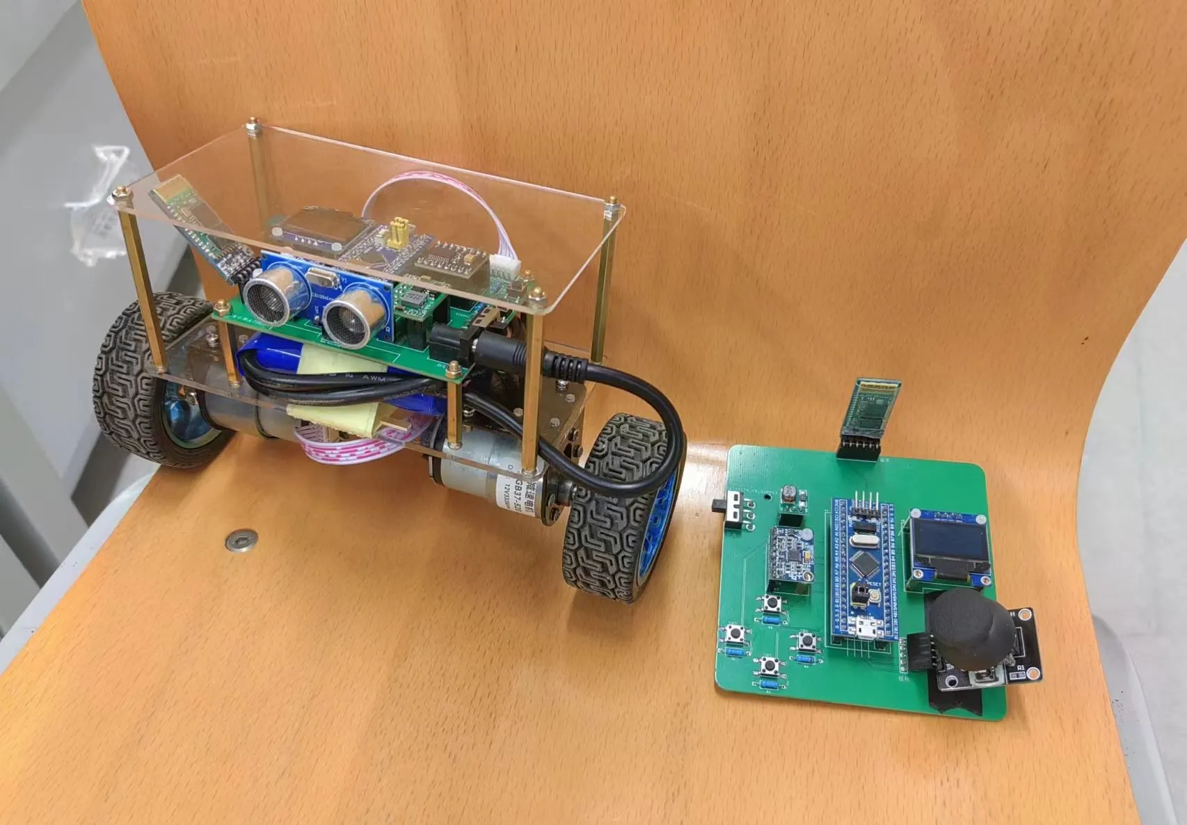

Project Overview:
This project is a remote-controlled balance car built using the LCSC STM32F103C8T6 development board. It features both joystick and gyroscope control. The components
used include an MP1584EN step-down module, a TB6612 module, a 0.96-inch OLED display, an MPU6050 module, an SR04 ultrasonic module, a joystick module, a 3V3 to 5V upgrade module, and an HC-05 Bluetooth module .
Project Functions
: Ultrasonic obstacle avoidance: Blocks forward speed when too close to an obstacle to prevent collisions.
Pick-up detection: Automatically detects when the car is picked up and disables balance.
Placement detection: Enables balance when the car is placed down and pushed forward.
Joystick and Gyroscope Control: Supports both joystick and gyroscope remote control modes.
