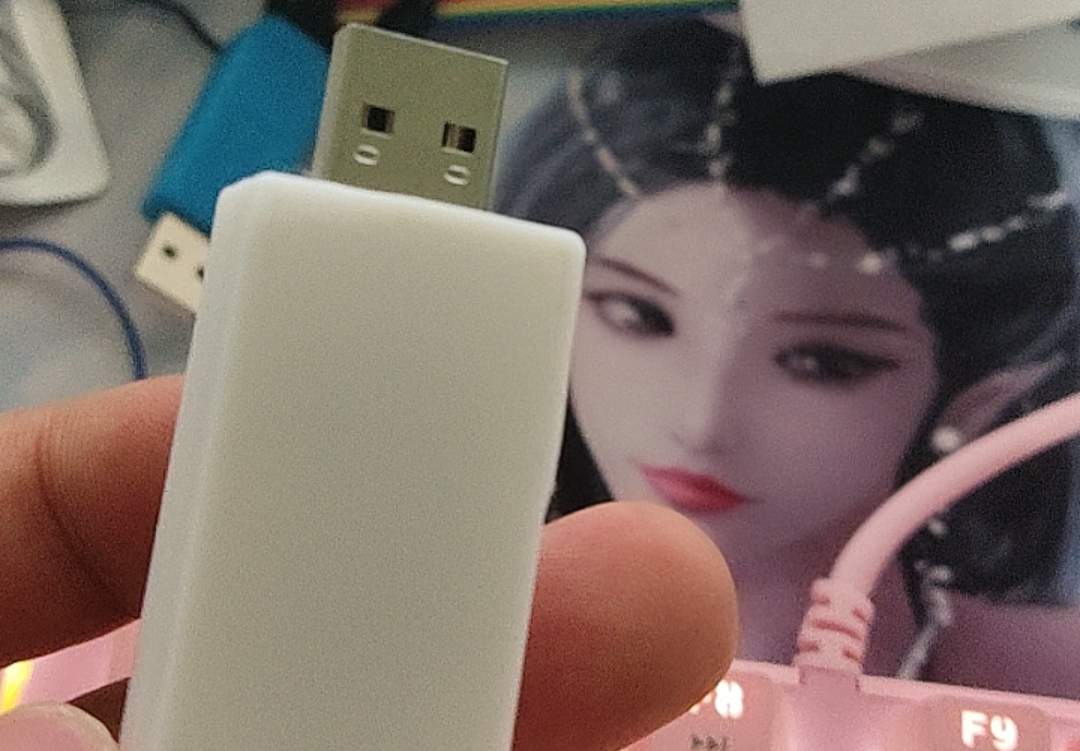

This is a USB flash drive made with a GL823K-HCY04 and Genesis SD NAND storage. It's plug-and-play and includes a casing. Those with a printer can export and print the data. The Genesis chip, although advertised as 4GB, doesn't mean it has over 4000MB of storage. It has a unit; I selected 4GB, and it showed over 480MB. If you want to use it properly, choose a larger capacity, like 32GB, which would be close to a true 4GB capacity, but it's not cost-effective as it's quite expensive. It's better to use eMMC. Note that the casing in the project doesn't have screws; don't forget to add screws if you're making a replica.
