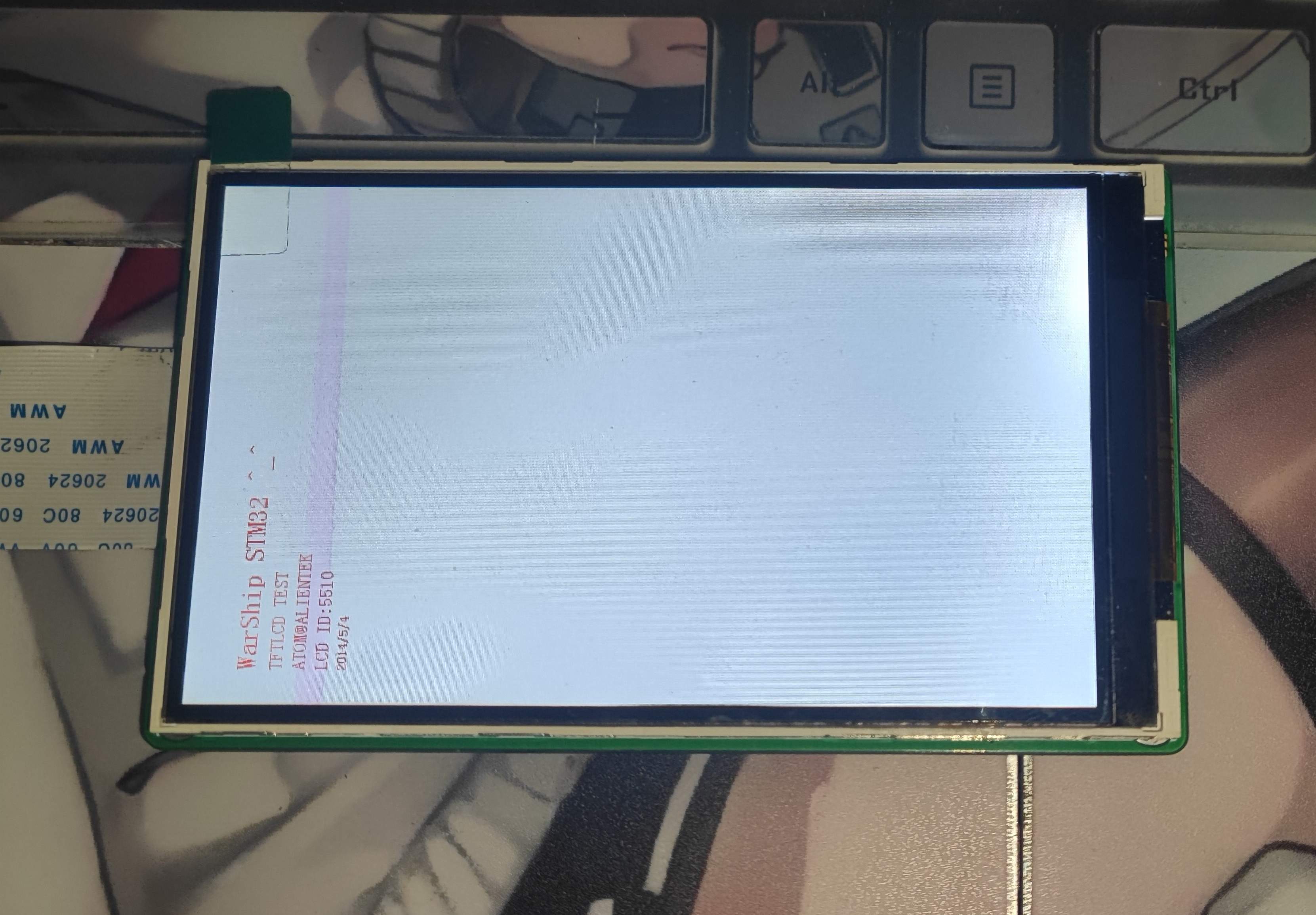

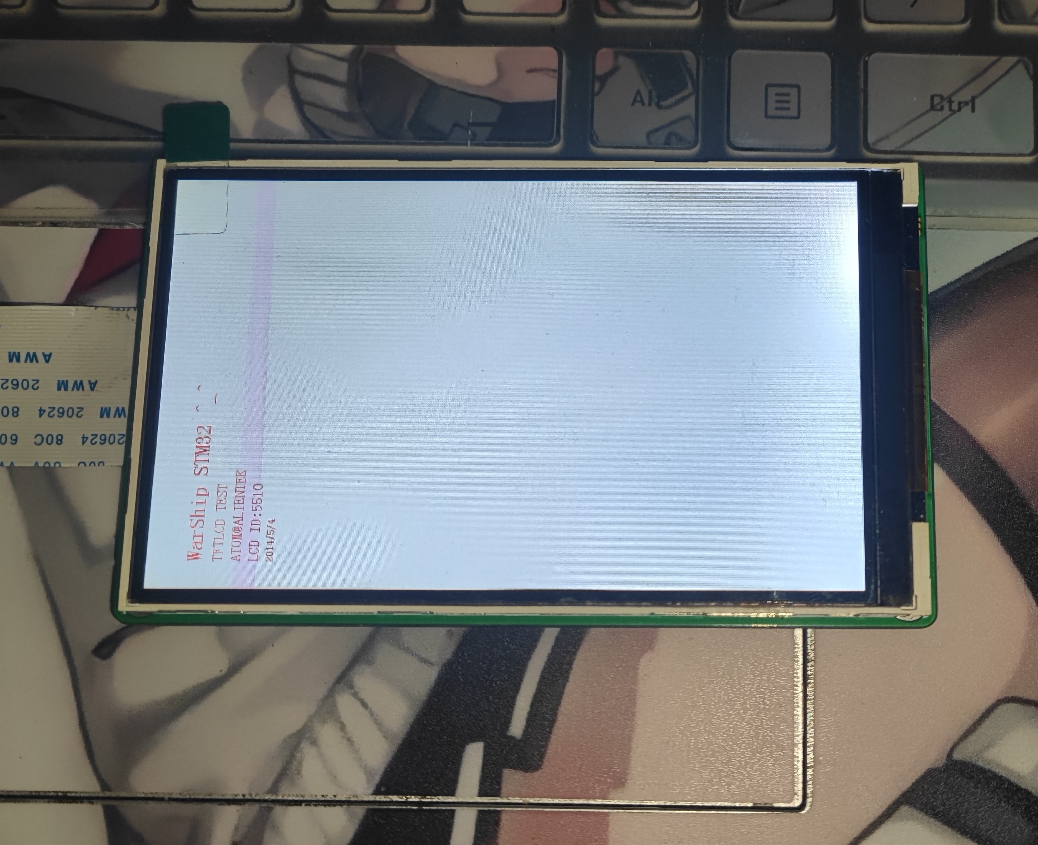

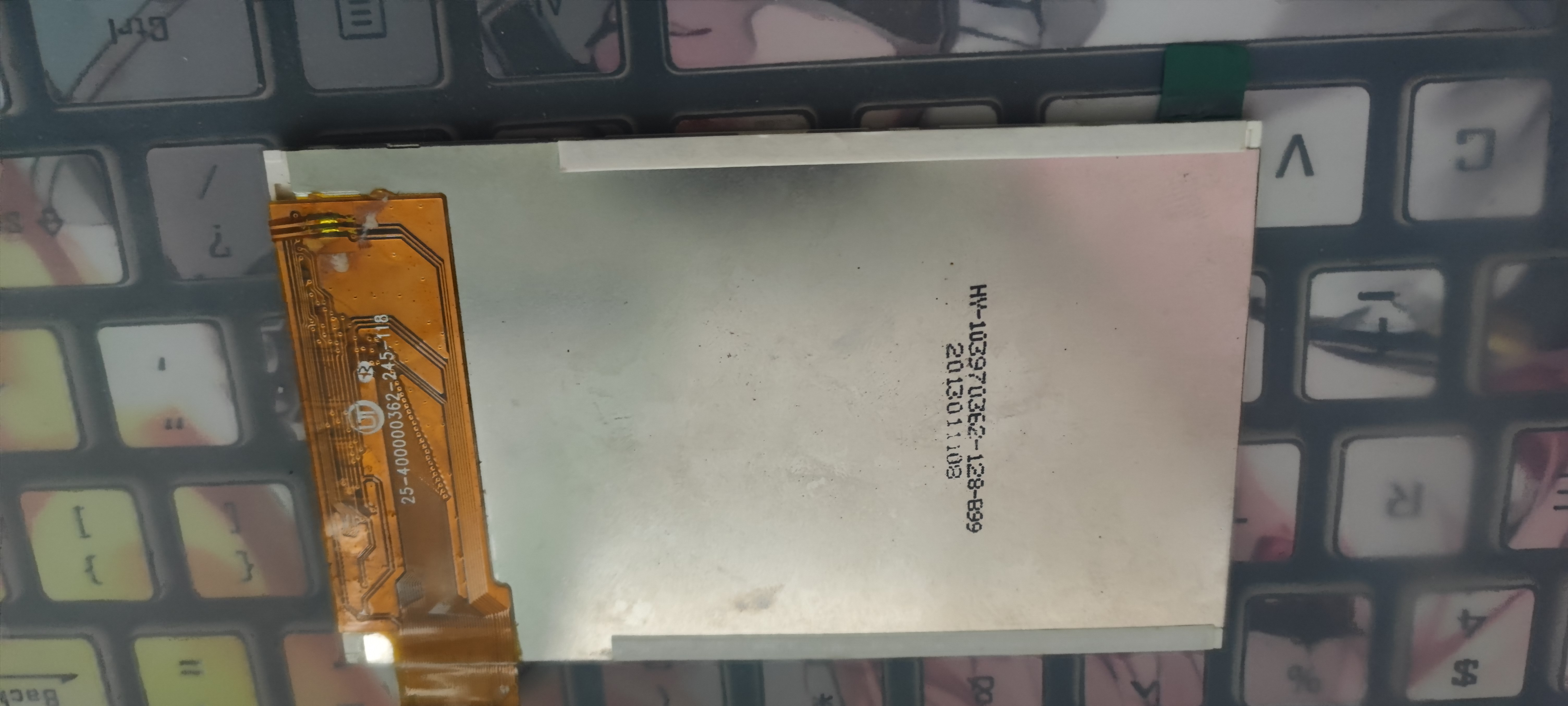

The screen
was obtained from Xianyu (a second-hand marketplace). It's a 4.0-inch, 480x800 resolution screen with an NT35510 main controller, using an 8080 parallel port 16-bit. I couldn't find detailed information...

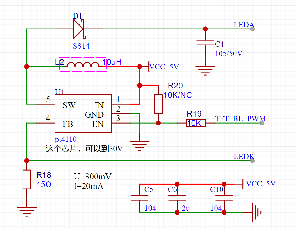

the backlight boost
converter is a PT4110. The TFT_BL_PWM here isn't actually connected, meaning the backlight control isn't brought out from the socket. Therefore, R20 is a 10k resistor.

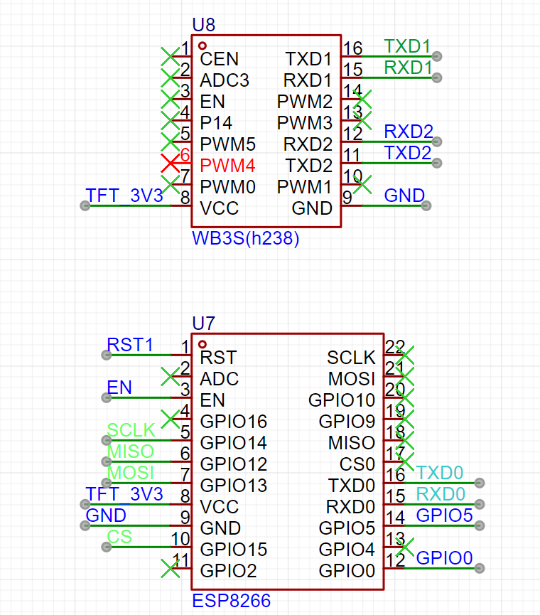

For the modules,
there's an ESP8266 and a WB3S (a custom module). I included them because the backplate is there, and leaving it empty felt wasteful.

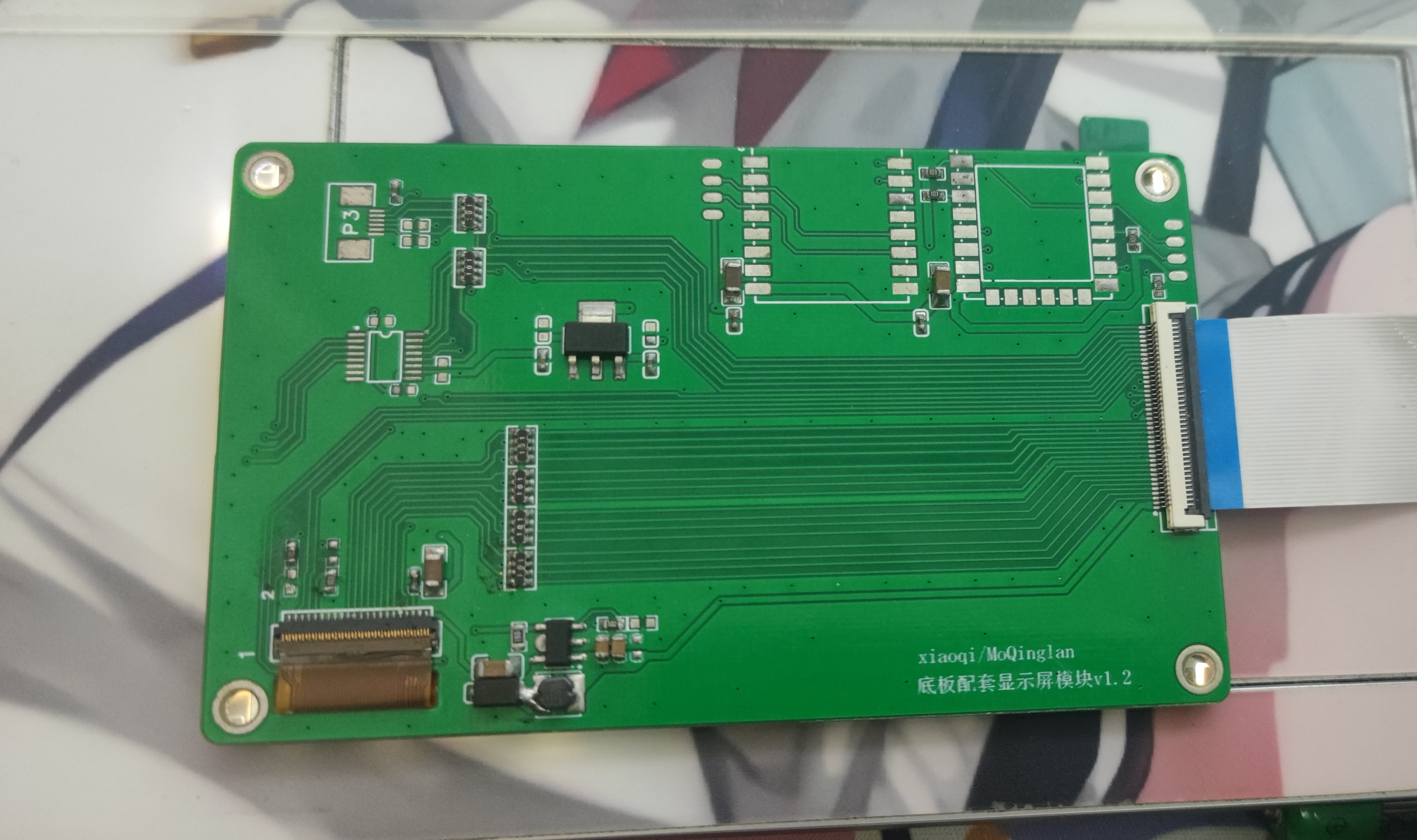

I also made an adapter board to connect to the Zhengdian Atom socket.
This PCB is 60x100mm, using a 40P FPC. If you want to use it with the Zhengdian Atom F1 core board, you can modify the FPC yourself.
The drawing might not be very good, please excuse the poor quality.
