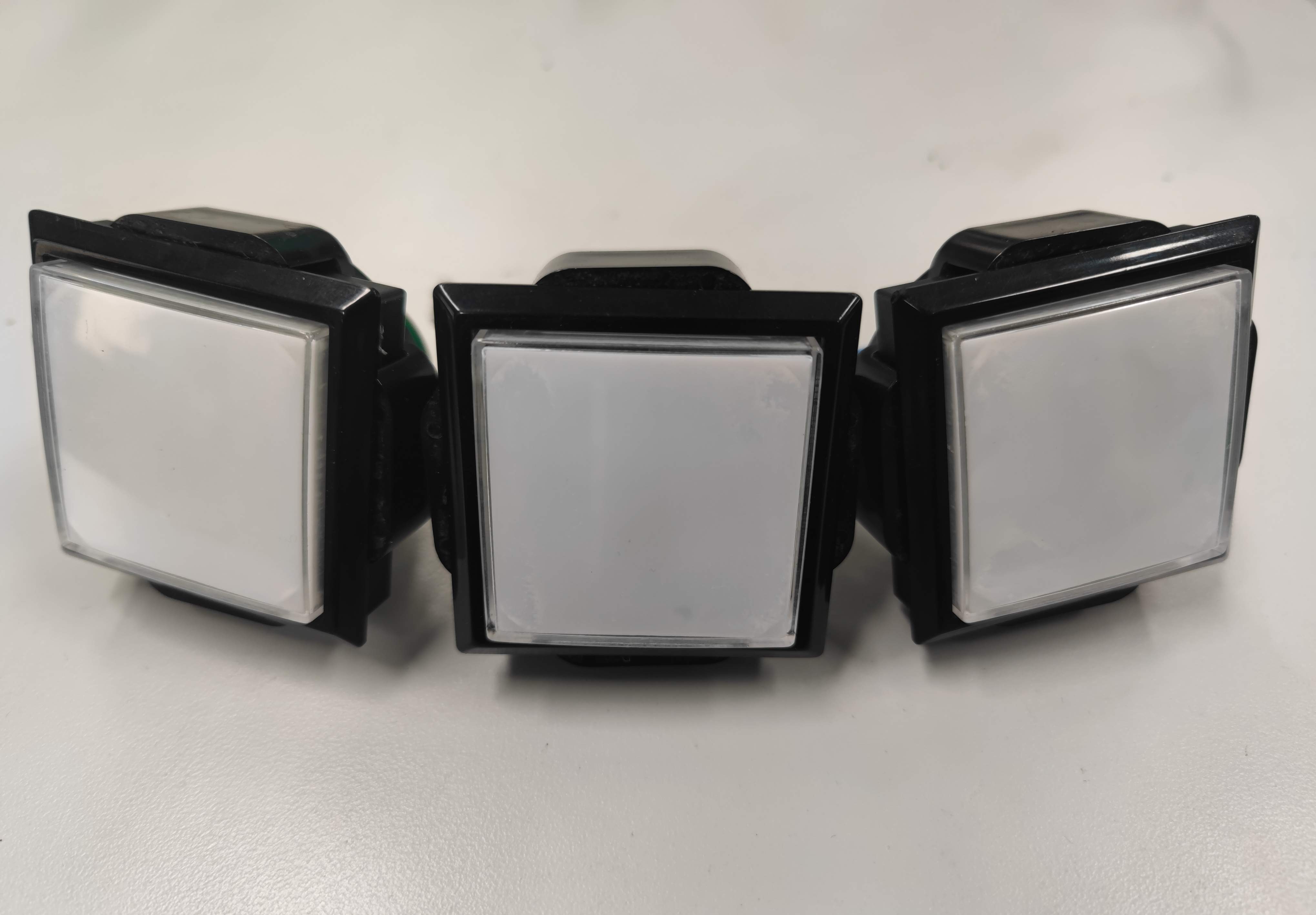

ONGEKI Hall Effect Button
This switch completely replaces the microswitches attached to the OBSA-60UK Sanwa buttons, such as the LHS7F. While retaining the original switching and lighting control functions, it adds support for adjusting the trigger travel (using a precision adjustable potentiometer).
Specifically, it uses a linear Hall sensor to detect the distance the button falls and converts this into a switching pulse via a comparator.
