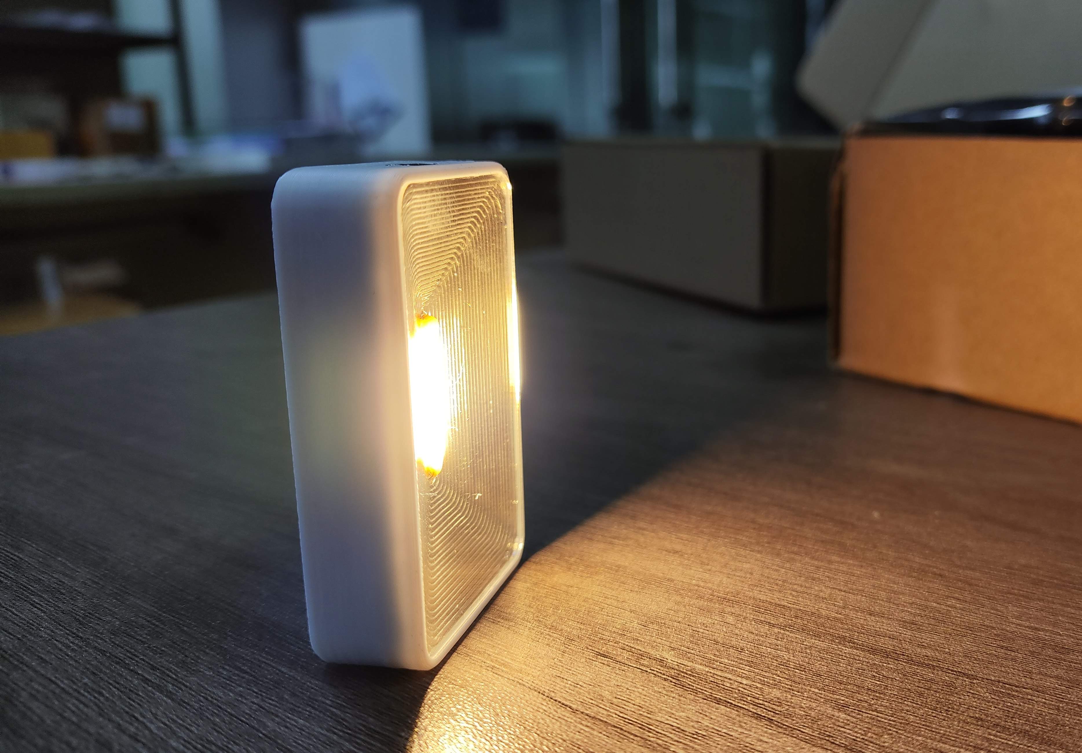

cozy night light

Notes:
1. Acrylic thickness is 1.5mm
. 2. Battery thickness is 30 x 40 x 4 mm.
3. The reflector needs to be painted with silver spray paint to increase its reflectivity; gold is also acceptable.
4. The video shows the casing printed by my own 3D printer, made of PLA.
5. The colored version has been verified; the casing is not perfect and will be updated later.
