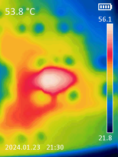

The NTC chip

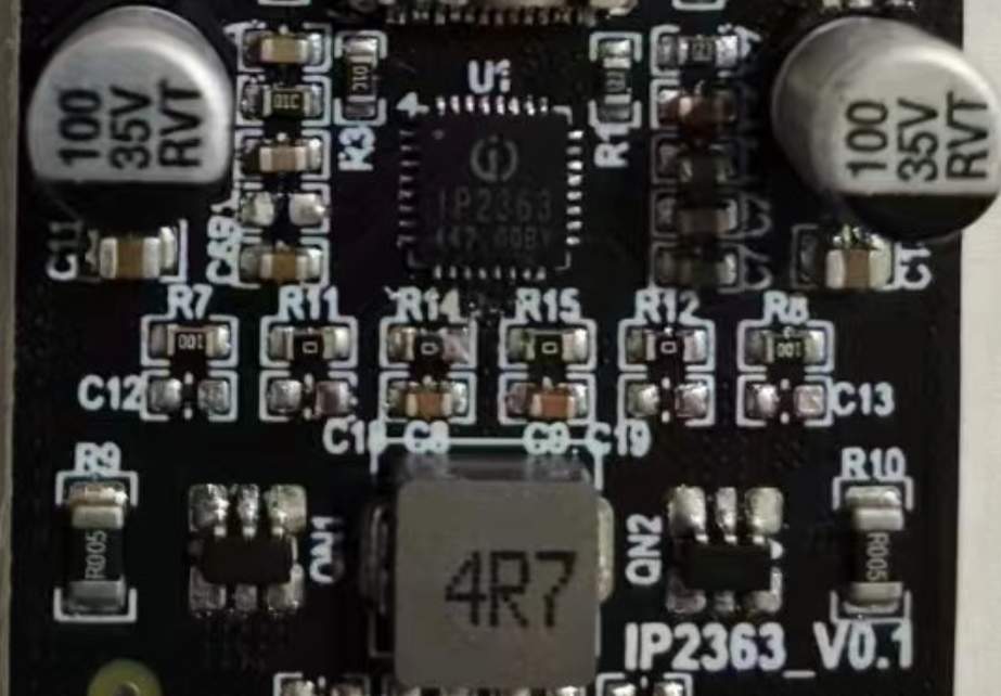

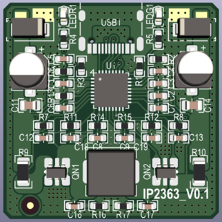

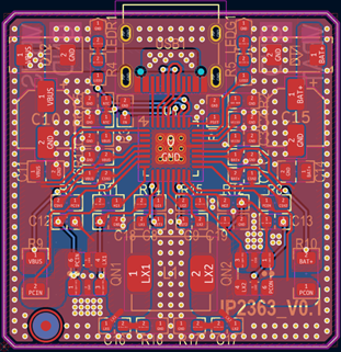

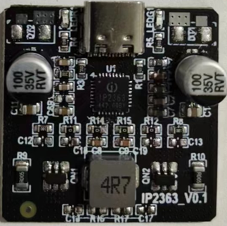

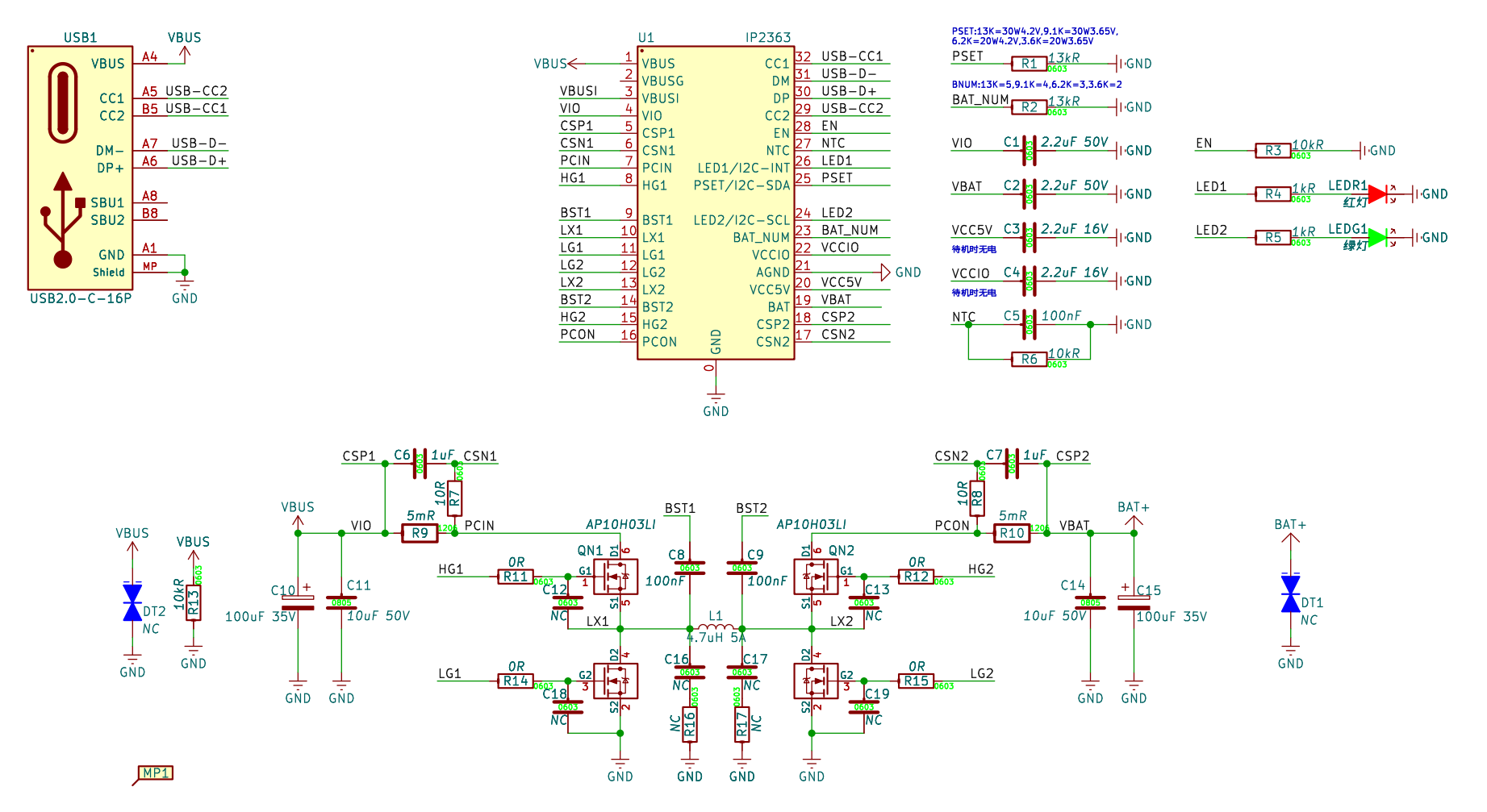

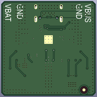

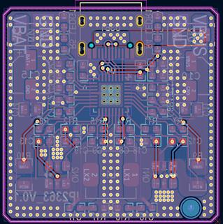

supports over-temperature protection (125℃). USB voltage, USB current, battery voltage , battery current, charging power , charging efficiency : 4.92V 2.94A 18.86V 0.7A 14.47W 91.24%; 8.94V 1.99A 18.90V 0.9A 17.78W 95.67%; 11.96V 1.48A 17.10V 1.0A 17.76W 96.17%; 14.94V 1.89A 18.85V 1.45A 28.16W. 96.94% 19.95V 1.39A 19.03V 1.40A 27.77W 95.79% Charging Temperature Schematic Diagram Important Notes: 1. The IP2363 chip contains firmware. Please carefully confirm the firmware's functions, version information, etc., with your supplier. 2. The MOSFETs used in the IP2363's external buck-boost circuit should not be easily replaced. The precise parameters of the MOSFETs will have a significant impact on the overall buck-boost efficiency. Unless your IP2363 supplier ensures that there are matching MOSFET models available in large quantities, do not easily change the PCB layout diagram, PCB 3D preview image, PCB physical image , and other design files . Please obtain these from your supplier.
