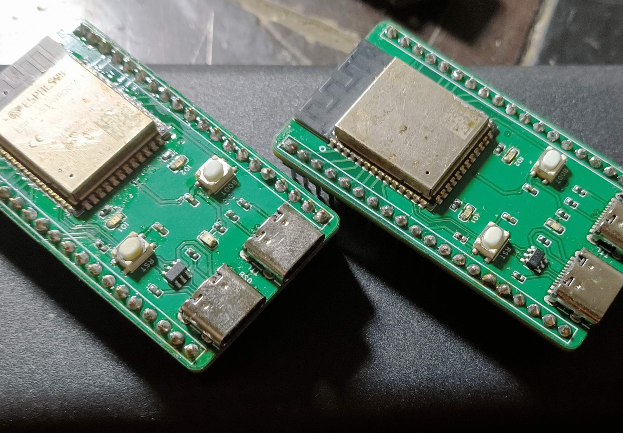

8T313j
esp32s3
The board itself doesn't involve much technology; this has already been verified.
ProProject_esp32s3_2024-01-23.epro
PDF_esp32s3.zip
Altium_esp32s3.zip
PADS_esp32s3.zip
BOM_esp32s3.xlsx

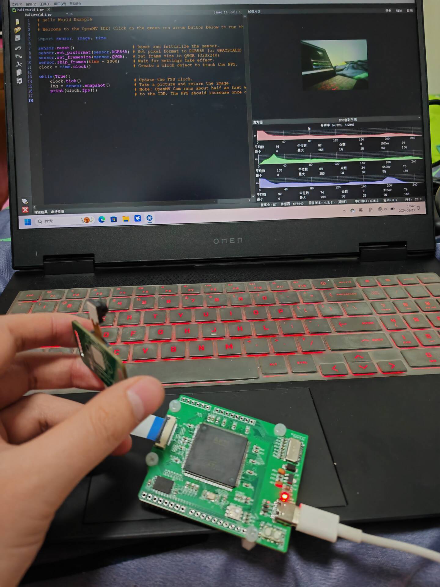

ArduinoMV4-Plus
Arduino-based OpenMV4Plus
This is an Arduino-based OpenMV4Plus board with all pin functions identical to the official OpenMV4Plus. It doesn't use a BGA package; the smallest component is a 0603 package for easy soldering. Both the IIC and SPI interfaces are compatible with the Arduino UNO series development boards. Compared to the Arduino, this development board has a reversed TX and RX layout for the serial ports, allowing it to be directly stacked on top of an Arduino for serial communication as a host or slave device.
Note: The original Arduino analog I/O ports have been replaced with SWD download interfaces. When using it, be aware that

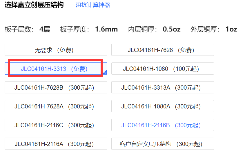

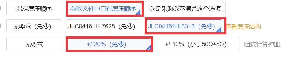

the board is a 4-layer board with DRAM traces controlled to 50Ω impedance. When customizing the board, please select the JLC04161H-3313 laminated structure.
Specific options are as follows.
The two bidirectional TVS diodes before the USB interface are hard to find; they are mostly sold on LCSC's online store. To save on shipping costs, you can skip soldering them. Oh
, and the active crystal oscillator for the camera expansion version does not require soldering. [doge]

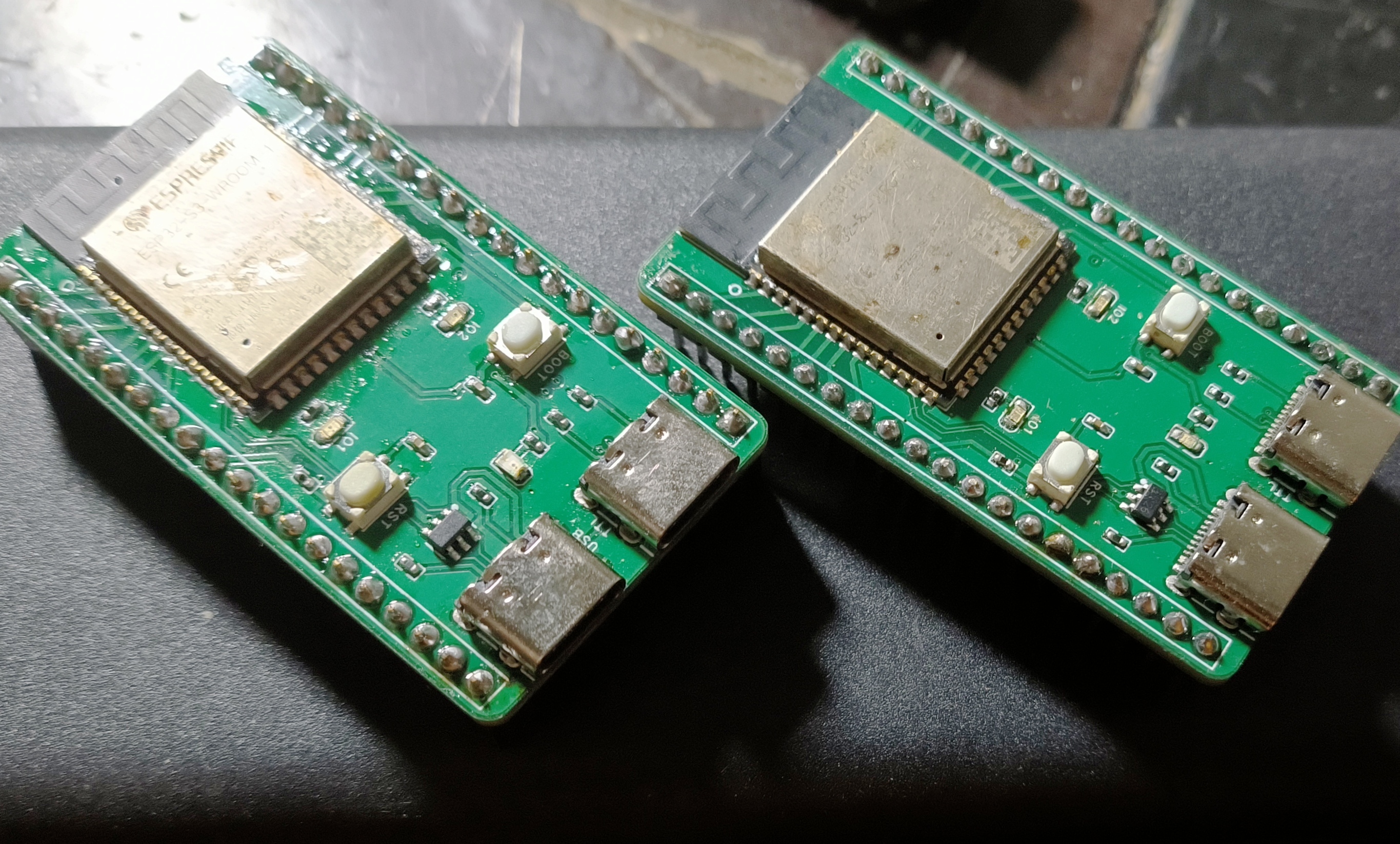

CP2102 serial port module with ESP32 auto-download and dual USB ports
The CP2102 to serial port module features an added ESP32 automatic download circuit for ESP32 serial programming. It also includes DTR & RTS signal lines for general serial port use.
With dual micro USB and Type-C inputs, finding the right cables is no longer a problem.
Essentially, it's a CP2102 to serial port module
with dual micro USB and Type-C inputs (both can be soldered, but only one can be used at a time). It basically works with any available cable
. An ESP32 auto-download circuit is added for ESP32 serial programming
. Separate DTR and RTS signal lines are provided for when the auto-download circuit isn't needed.
It offers 5V and 3.3V power supplies; the 3.3V is provided by an AMS1117, offering strong power rather than the weak 3.3V rectifier inside the CP2102.

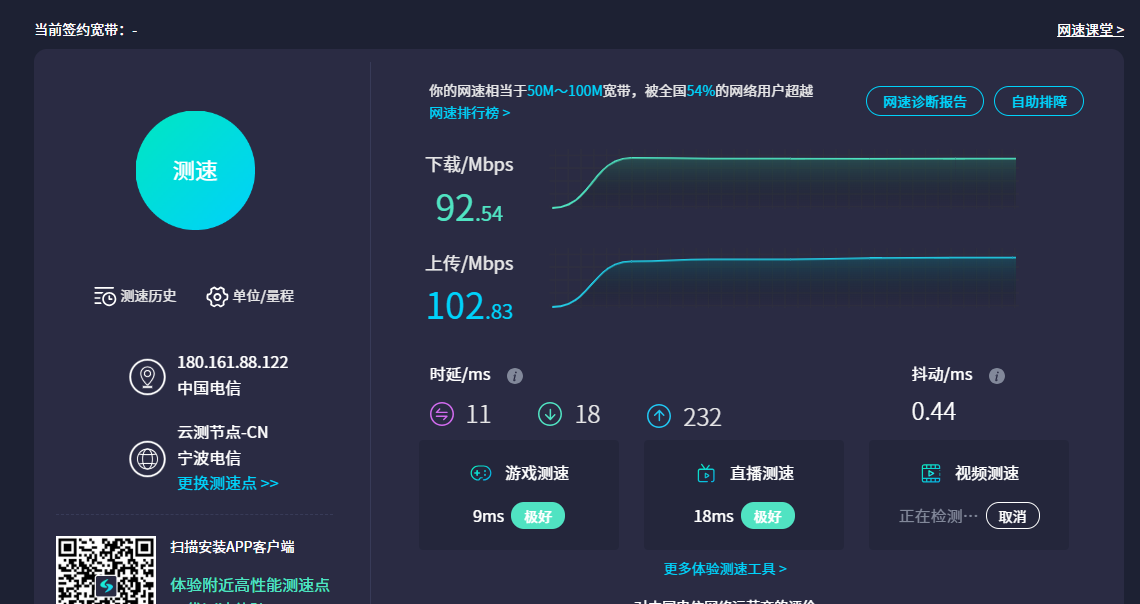

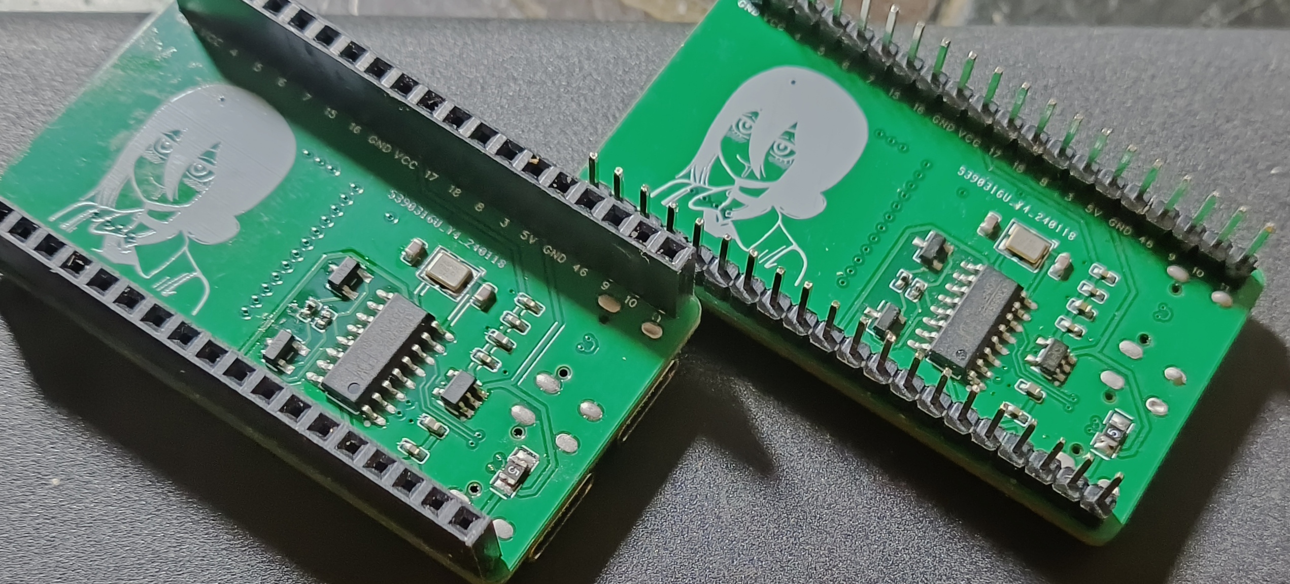

USB network adapter
For a USB 2.0 100Mbps Ethernet card based on CH397A, simply remove the 1000pF capacitor and use a 3.3V power supply chip. ESD protection devices are essential, otherwise it is easily damaged by static electricity.
In some places, you need to check the speedometer; this is the speed measurement result.
