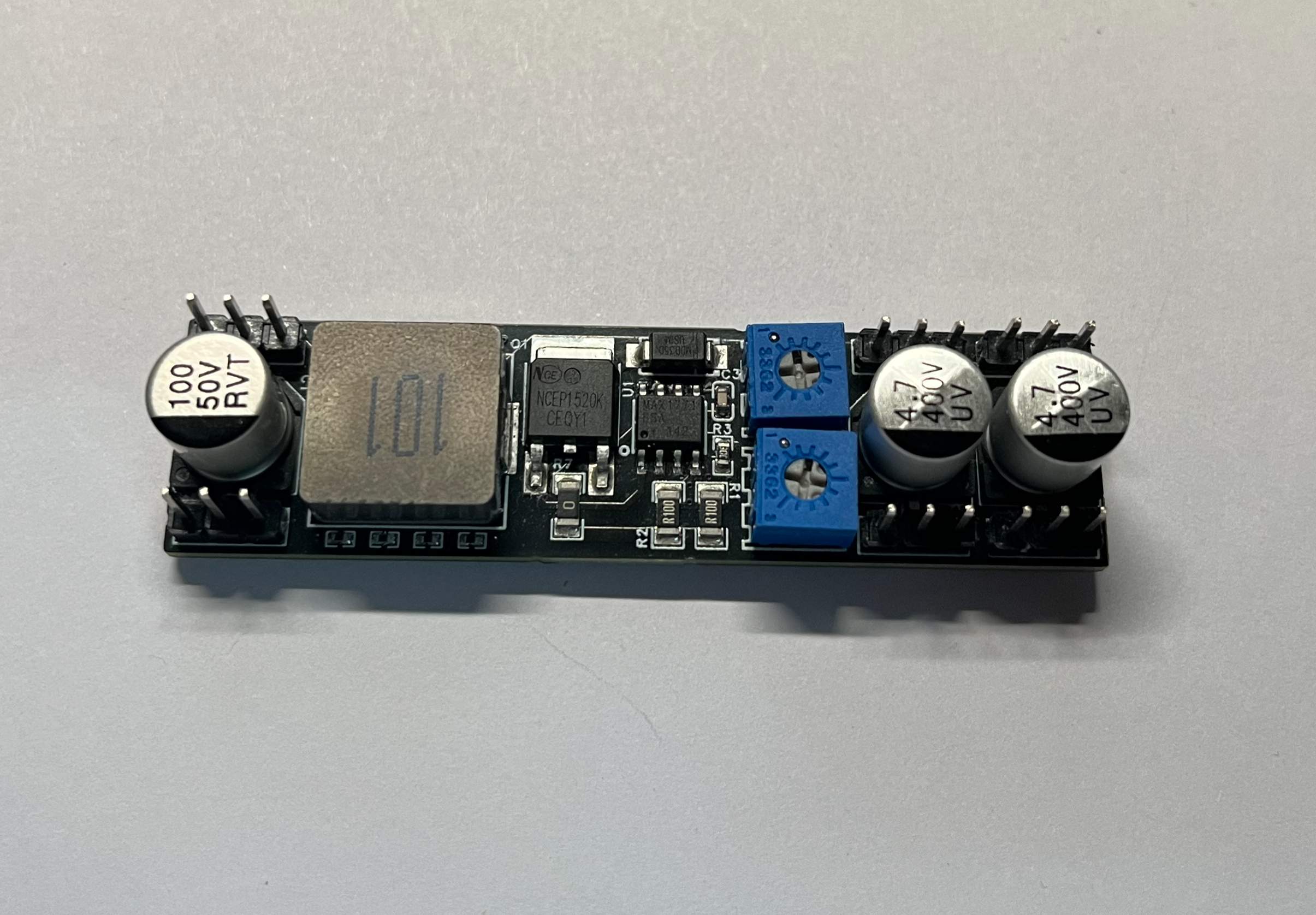

DC-DC adjustable boost module based on MAX1771
Since VFDs require multiple high-voltage drive circuits with different voltages, debugging is quite complex. And DC power supplies that can provide high voltages are expensive. So, I had a sudden inspiration to create an adjustable high-voltage drive board to facilitate debugging in areas requiring high voltage (later I realized that using a 220V autotransformer and rectification would be more convenient). Compared to some fixed-voltage boost modules, this module's efficiency isn't high, and it requires a 12V power supply for output voltages above 100V. However, this module can be flexibly debugged and embedded into projects without the need to design separate test and final circuit boards.
