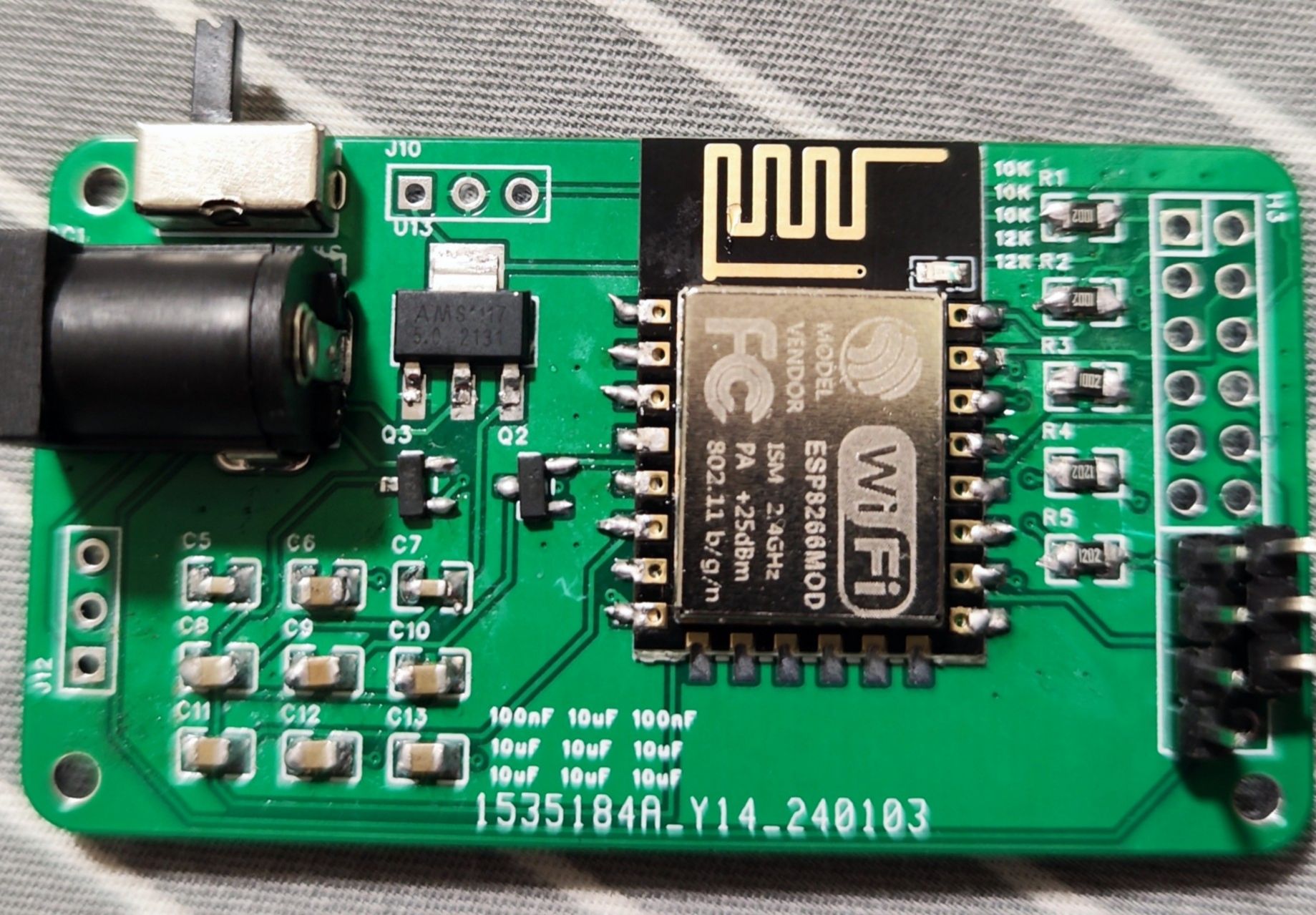

With Chinese New Year approaching, I decided to make a LED strip controller to control LED strips powered by the WS2811 chip.
I used the EPS8266-12E chip, which I'm quite familiar with.
While designing the PCB, I asked my child what to write on it, and he said, "Lights for Chinese New Year." Hence the strange silkscreen.
I connected the SPI MOSI pin of the WS2811 to the LED strip's DIN connector.
The LED strip's power supply is directly connected to an external 12V power supply.
The 12V power is then stepped down to 3.3V by an LDO chip before supplying the chip.
To save costs, I didn't integrate a USB-to-serial chip; only the pins are exposed, requiring an external programmer.
I reserved three sets of buttons connected to the GPIO pins for controlling the light modes. I also reserved
two levels of 3V3/GND/GPIO pins.
Currently, one set is directly connected to a sound sensor, enabling the light to turn on when a voice is called. Because the placement and pin order weren't planned perfectly, I'm currently using jumper wires. Please
ignore my poor soldering skills. Due to my clumsy hands, I intentionally exposed most of the pins to facilitate measurement and positioning after soldering.
For the software, I used part of the FastLED library and also created several effects myself.
The principle is relatively simple: it essentially uses an array of 100 points, each representing the RGB color of a single LED, and refreshes the data in each loop.
Based on the desired effect, I calculated the color of each LED in each loop.
The code is pending open-sourcing.
