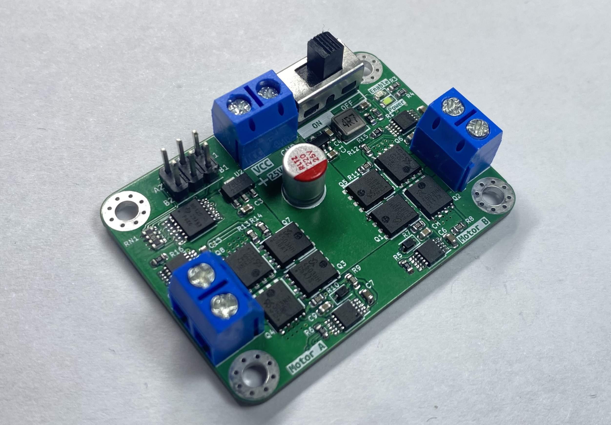

. I. Product Introduction
This is a high-power, high-efficiency dual-channel motor driver designed and manufactured based on the domestic EG5620 gate driver and 5X6 packaged NMOS (such as SM4503/CSD18540, etc.). It can drive most common DC motors. One motor can be controlled using two PWMs.
II. Application Scenarios
: Prototype development for products such as smart cars and drones;
directly applicable to various competitions with high requirements for motor drive power and efficiency;
III. Product Overview:
This product provides a dual-channel motor drive board based on the EG5620 motor drive controller for electronics enthusiasts and prototype verification engineers. It features:
dual EG5620 H-bridges with 5x6 MOSFETs, high power, low internal resistance, and high efficiency;
single-sided components, with a main body size of only 5.1x3.7cm;
two PWM channels control the forward and reverse rotation and speed adjustment of one motor;
an enable button switch can be used to shut down the drive and prevent it from flying off course;

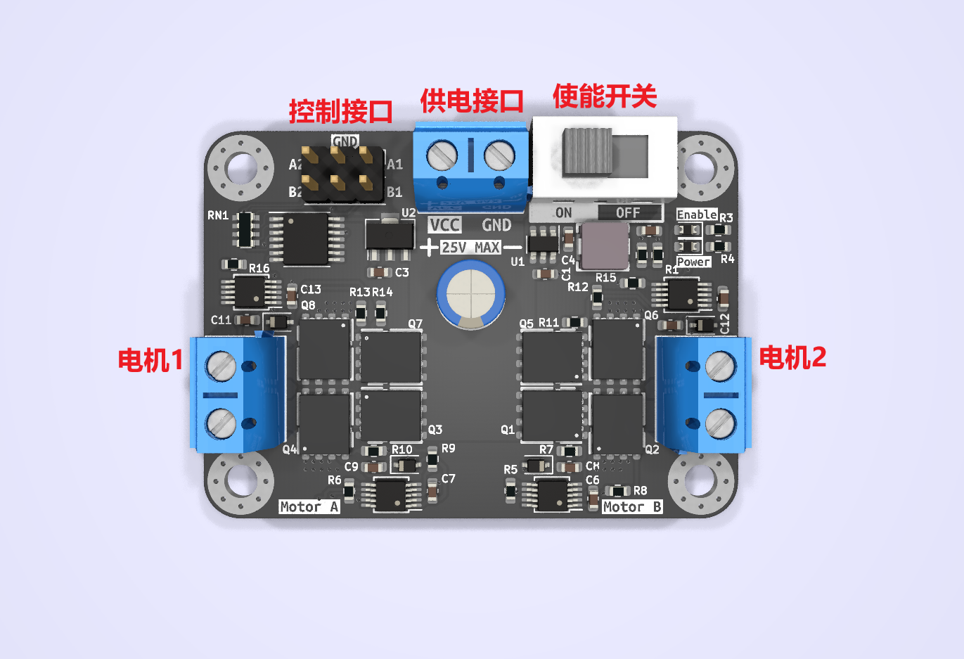

: Interface: Power supply uses blue KF301 terminals; logic interface uses a 2.54mm standard interface; speed can be controlled by connecting a PWM signal;
operating voltage: 5V-25V;
production cost: 15-25 RMB (using SM4503/CSD18540);
PCB Parameters: 5.1x3.7cm, two-layer board design, components placed on one side, interfaces on the front.
V. Instructions for Use :
Power supply 5V-25V (2s-6s recommended) .
One motor uses two PWM controls;
see 3D diagram for connection details

MOSFET Selection Recommendation: SM4503 is used in the video test; CSD18540 can also be used.
