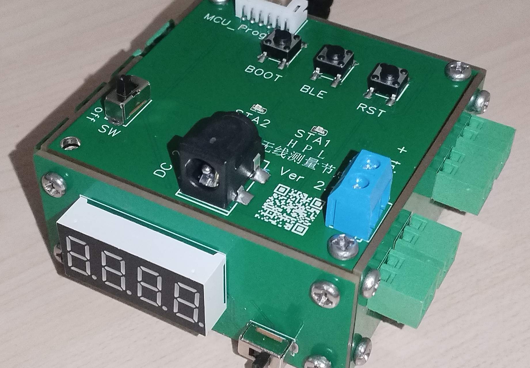

First generation link: https://oshwhub.com/starsky2019/wireless_OC
The second generation operates on the same principle as the first, with modifications to some microcontroller programs, adding functions such as measurement triggering and sampling frequency adjustment.
Demo video address: https://www.bilibili.com/video/BV1ru4y1G7Xt/

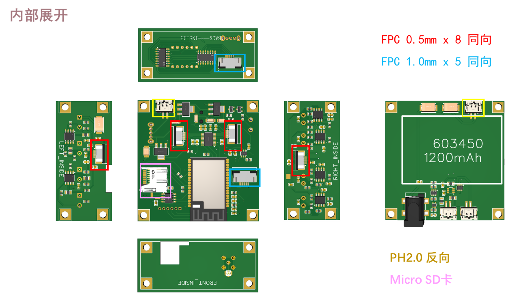

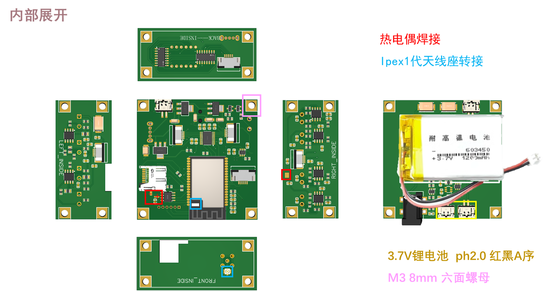

Hardware assembly tips:

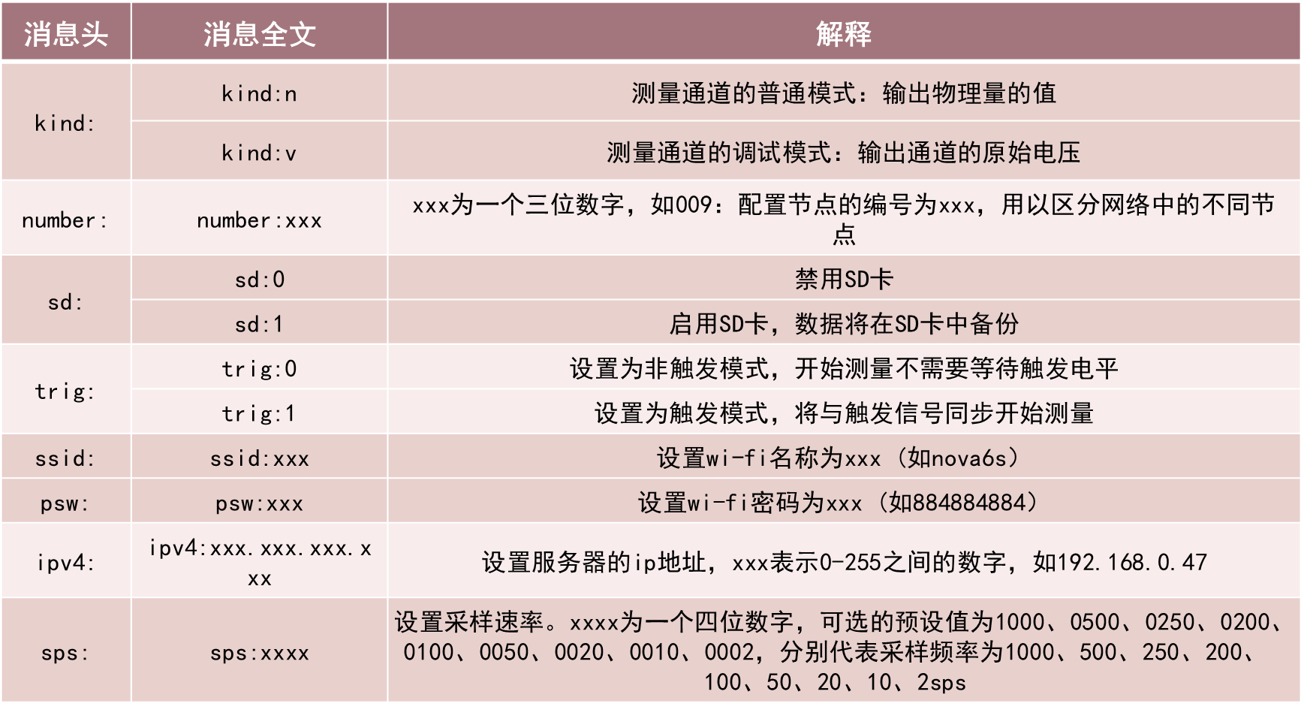

The Bluetooth function has also been modified accordingly. The complete Bluetooth function table is as follows:
        Note: After updating Bluetooth, please restart the microcontroller immediately for the configuration changes to take effect.
