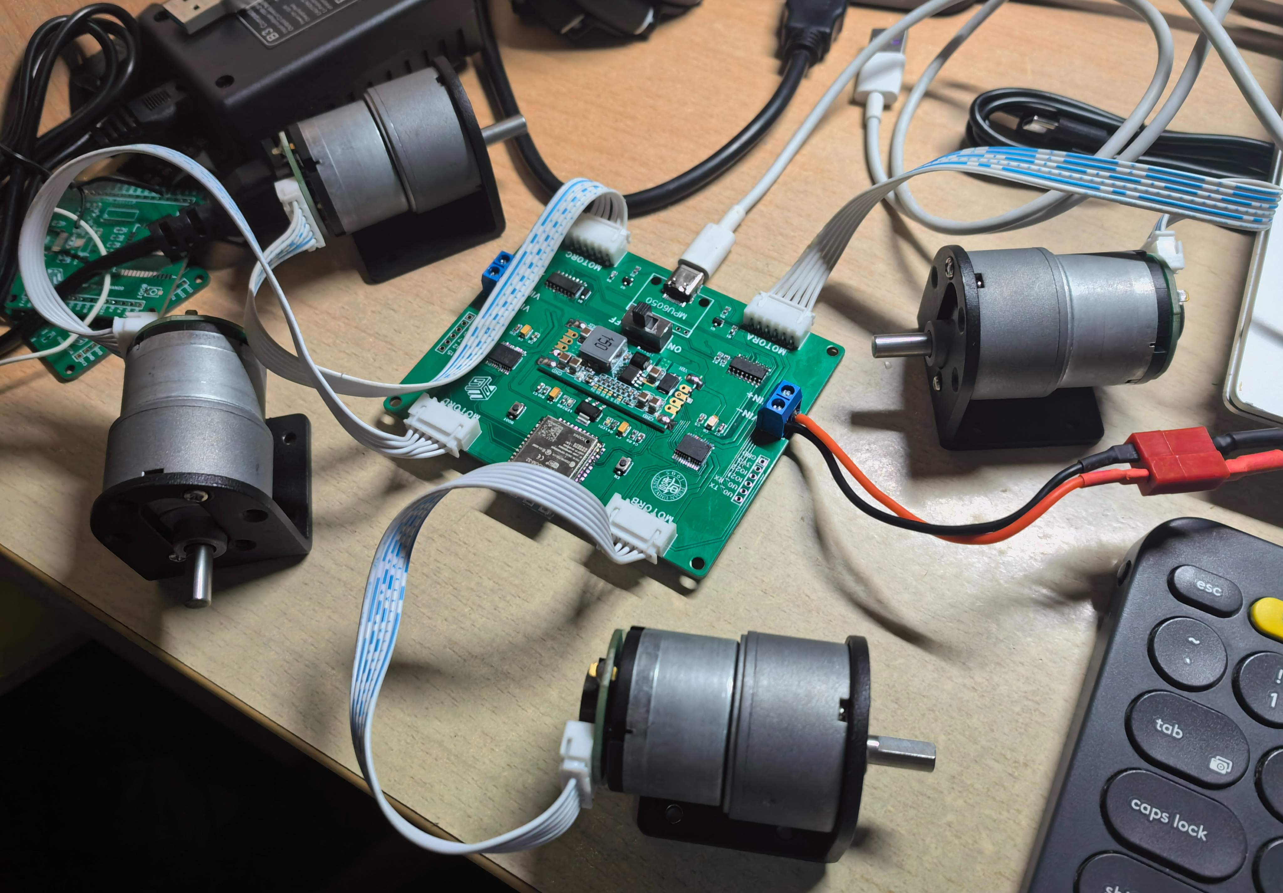

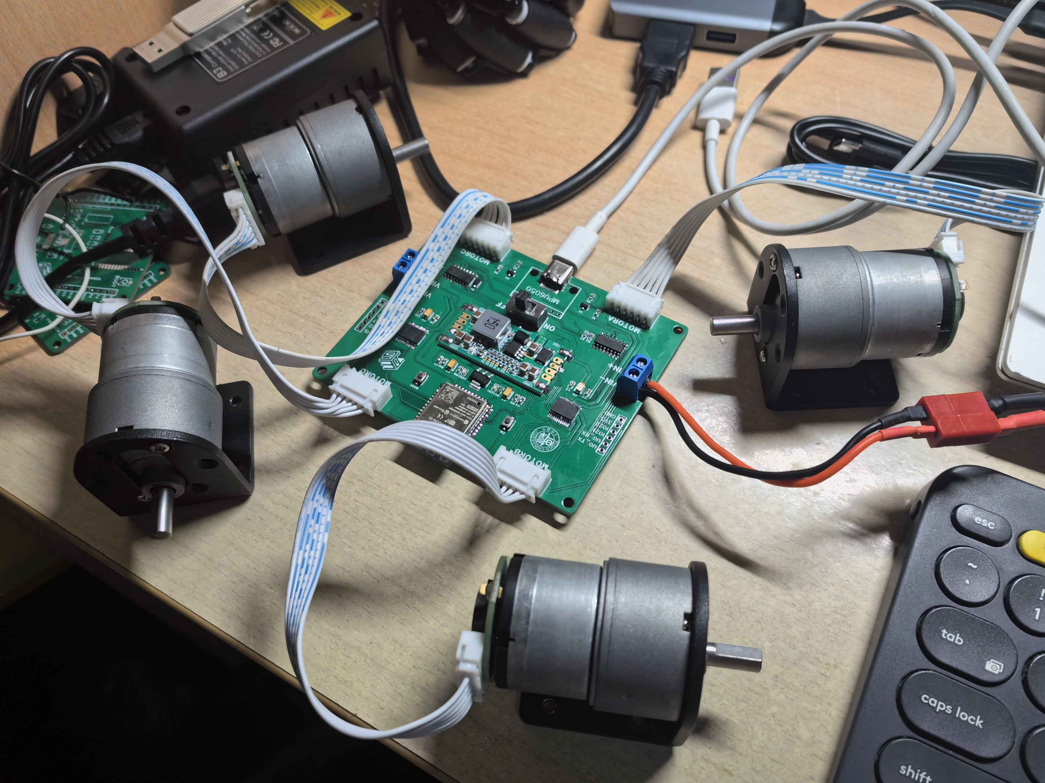

This is
a four-channel motor control board using the ESP32WORK32 as the main controller. It can drive four 513 or 520 motors and has reserved interfaces for UART2, I2C, and MPU6050 modules. A TPS5430 step-up/step-down module needs to be purchased and soldered separately. It is suitable for various competitions, mini-cars, etc.
It has been verified to be usable.

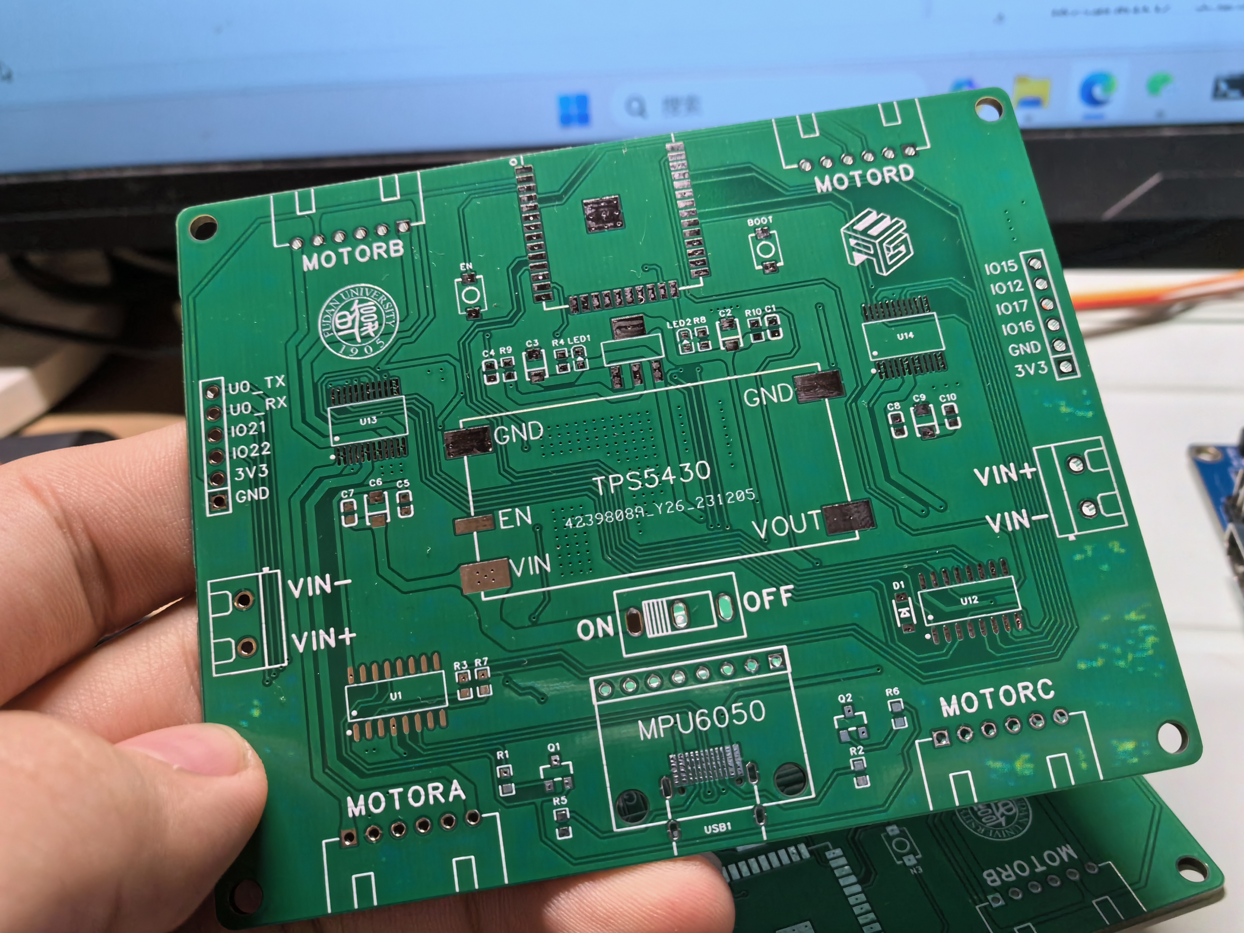

The PCB design layout
uses an almost perfectly symmetrical arrangement due to my personal preference.
The size is 80mm*100mm, meeting JLCPCB's free board-making requirements.
The Type-C interface pads are elongated for easier soldering; a little solder paste and a generous amount of solder flux are applied, and the soldering is done by carefully running a soldering tool along the surface.
The TPS5430 module has a custom package design, which can be modified to accommodate other DC-DC circuits.
The 74HC595D chip uses an SOP-16 package, consistent with the CH340C.
The MPU6050 module covers the Type-C interface, a nod to the 3D stacking technique of placing resistors between two rows of female connectors.

the 74HC595 chip, I recommend purchasing the version with a "D" suffix, as this version has built-in pull-up pins on the output pins. There is a version with an "A" suffix that appears to be open-drain output; since I didn't design an external pull-up pin, it might not be able to drive the motor properly.
The VIN+ and VIN- on the left and right sides are reversed; please pay attention when wiring.
The reference code
is not yet finished; I will update it when it is complete. If there's been too long since the last update, please leave a comment. See the attached video for
a placeholder code demo .
