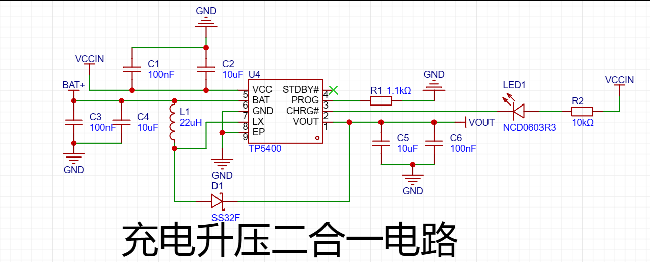

The schematic diagram illustrates
the TP5400, a dedicated single-cell lithium-ion battery charger and constant 5V boost controller for power banks. The charging section integrates high-precision voltage and charging current regulators, pre-charge, charging status indication, and charging cutoff functions, and can output a maximum charging current of 1A. The boost circuit uses a VFM switching DC/DC boost converter manufactured with CMOS technology, exhibiting extremely low no-load current. It features extremely low no-load power consumption (less than 10uA) and a boost output drive current capability of up to 1A. It requires no external buttons and is plug-and-play.

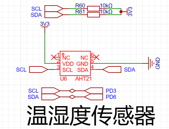

This case study utilizes the AHT21 temperature and humidity sensor. As a new generation of temperature and humidity sensors, the AHT21 sets a new standard in terms of size and performance: it is embedded in a dual-in-line flat no-leads SMD package suitable for reflow soldering, with a bottom surface of 3x3mm and a height of 0.8mm. The sensor outputs a calibrated digital signal in standard I2C format.

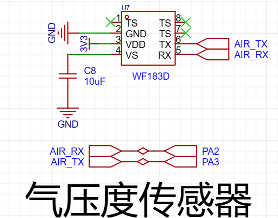

This case study utilizes the WF183D digital waterproof barometric pressure sensor. The WF183D is an economical digital pressure and temperature sensor that integrates a MEMS pressure sensor, a high-resolution 24-bit ΔΣADC, and a DSP. The WF183D provides high-precision, calibrated digital pressure and temperature output via UART, with very simple communication connectivity. For

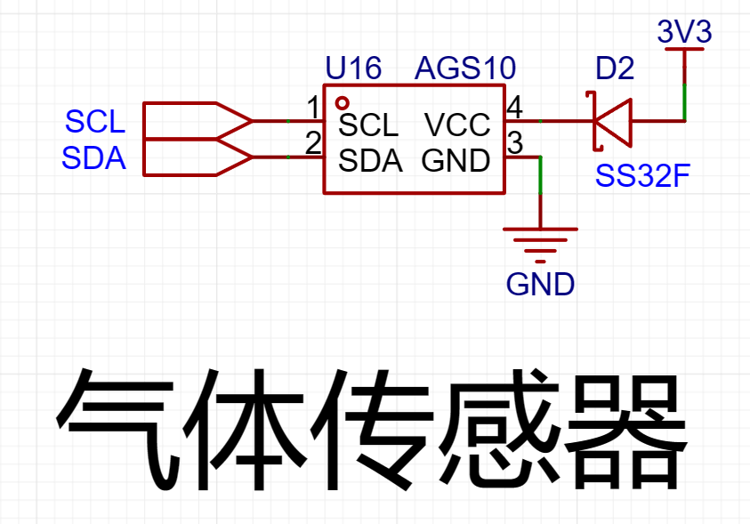

hazardous gases, this case study employs the AGS10 TVOC sensor, a MEMS TVOC sensor with digital signal output. It features dedicated digital module acquisition technology and gas sensing technology, ensuring extremely high reliability and excellent long-term stability, while also boasting low power consumption, high sensitivity, fast response, low cost, and a simple driving circuit.

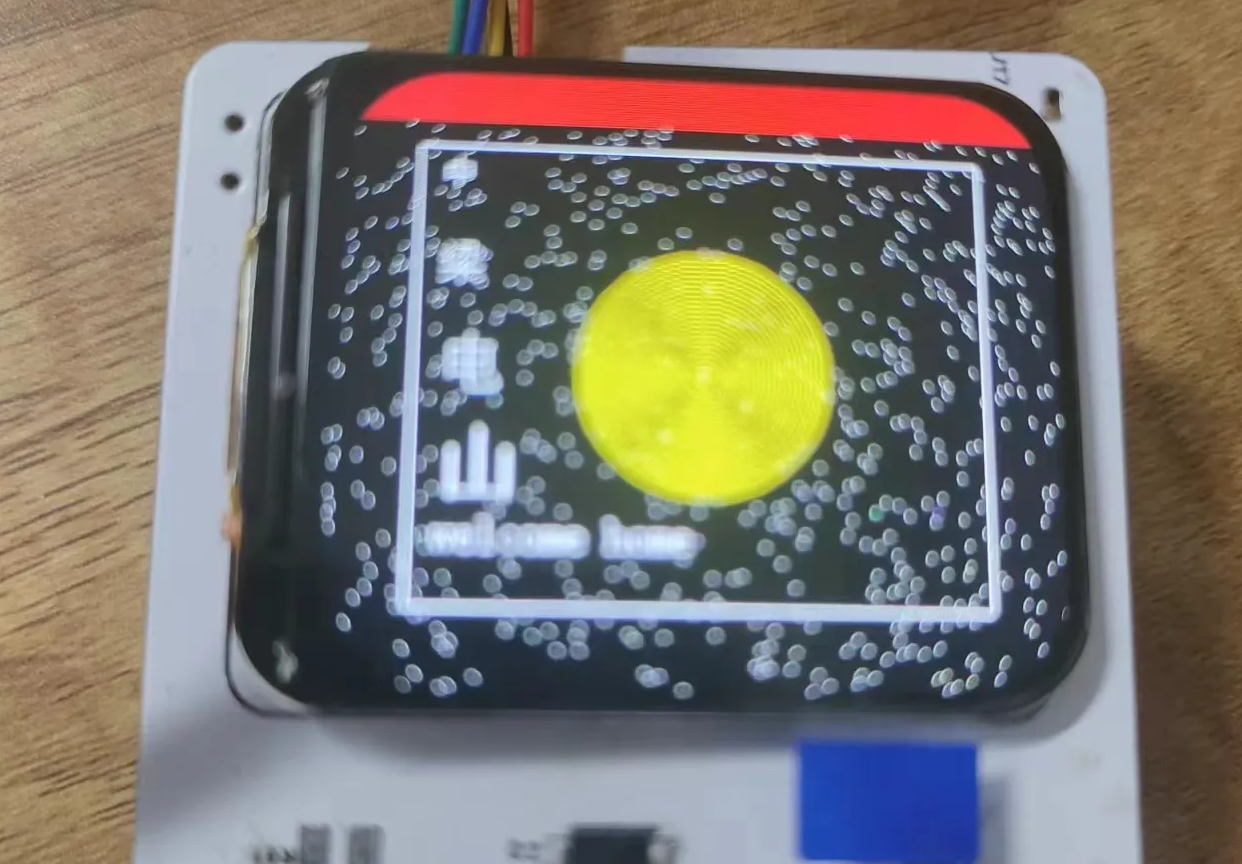

The screen is a 1.69-inch IPS high-definition rounded-corner screen with 240*280 pixels and SPI communication. A 1.69-inch screen is a common small-size display, referring to a diagonal size of 1.69 inches (approximately 4.29 cm). Although relatively small, it still has wide applications and functions in certain fields. This screen offers a higher pixel density (total pixels/size), resulting in finer image quality and fewer control I/O operations, leading to a simpler peripheral circuitry.

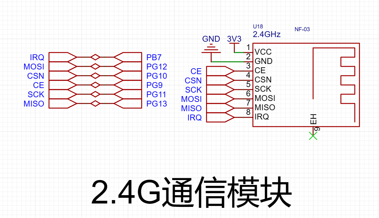

This case study utilizes the NF-03 wireless module designed by Ai-Thinker Technology. The NF-03 is a 5mW 2.4G transceiver module. A 2.4G module is used for wireless communication, enabling wireless data transmission and reception in the 2.4GHz band. This module typically consists of a wireless transceiver and related control circuitry, providing users with a convenient wireless communication solution.
