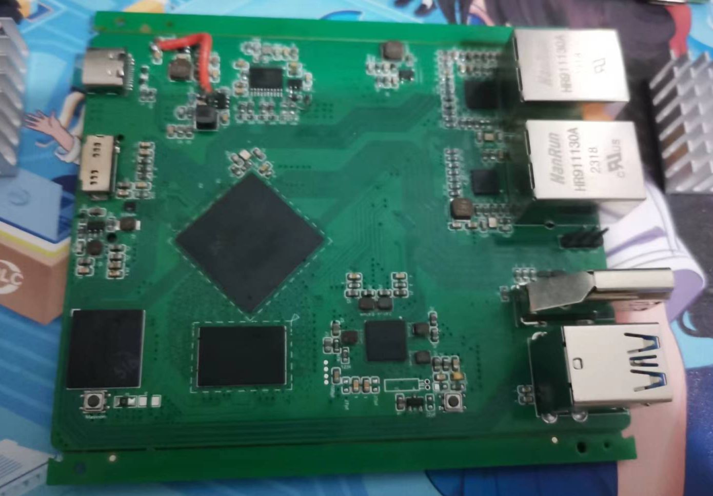

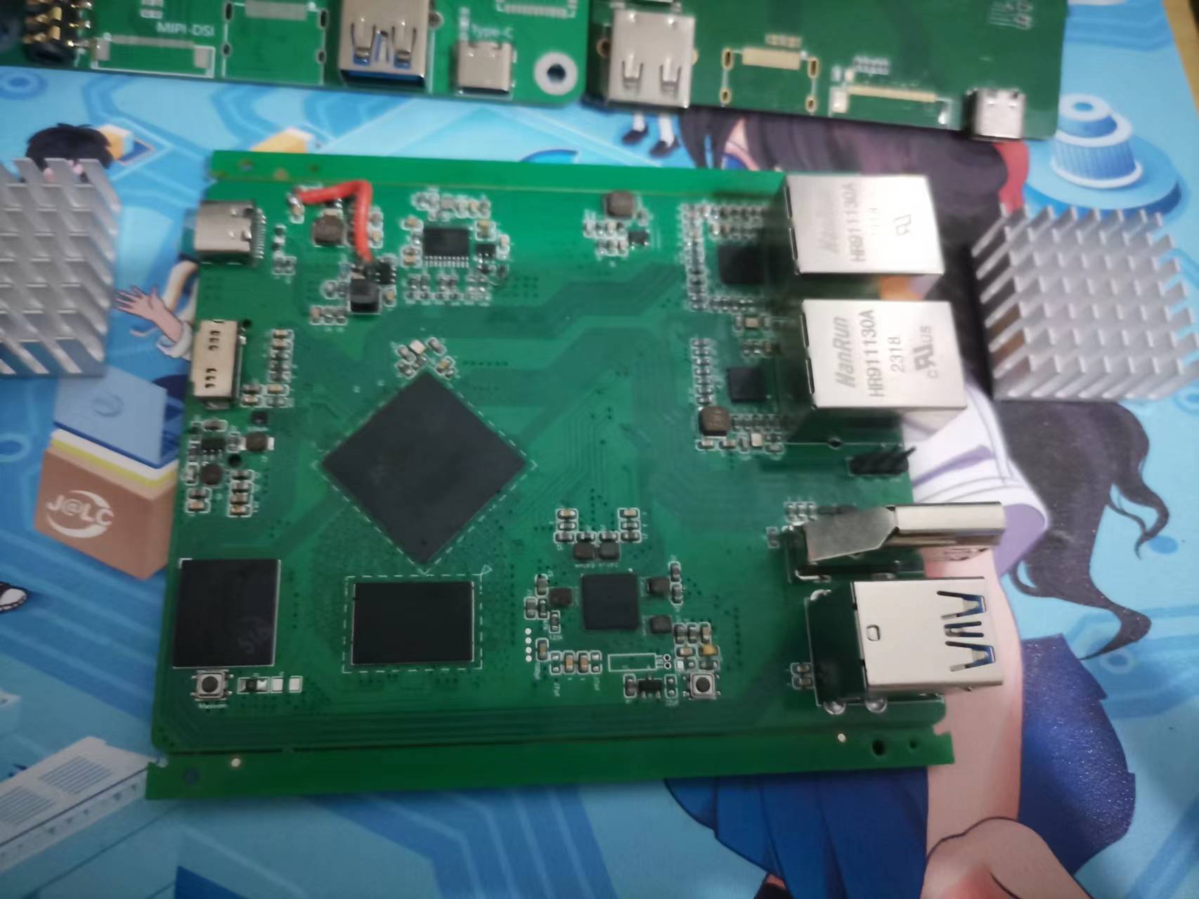

. Any questions? You can join the group. The group owner
has two boards in the project
: V0.3 (dual network card version, one gigabit and one 2.5G), which I have already verified

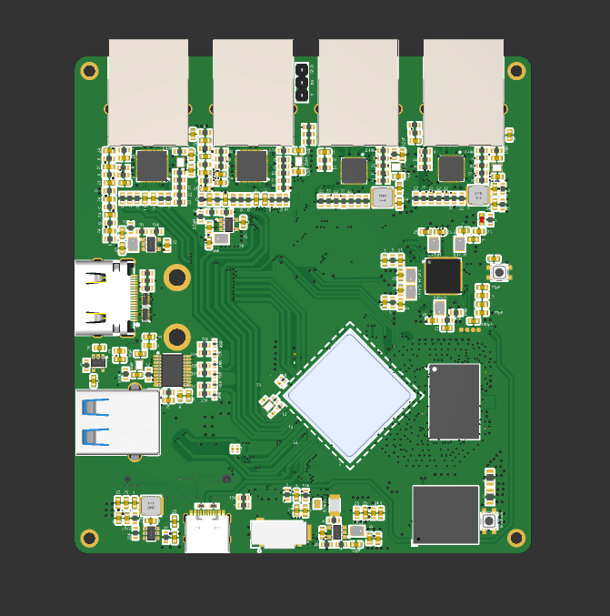

; and V1.0 (4 network ports version, which I haven't had time to verify yet). If any experts have verified it, please provide feedback.
Onboard resources
: CPU: 4*A55;
Memory: 1 LPDDR4 or 1 LPDDR4x;
Display: HDMI 4K;
Network ports: 2 1000M + 2 2.5G;
Interfaces
: 1. USB 1; 2.
PCIE 2.1;
