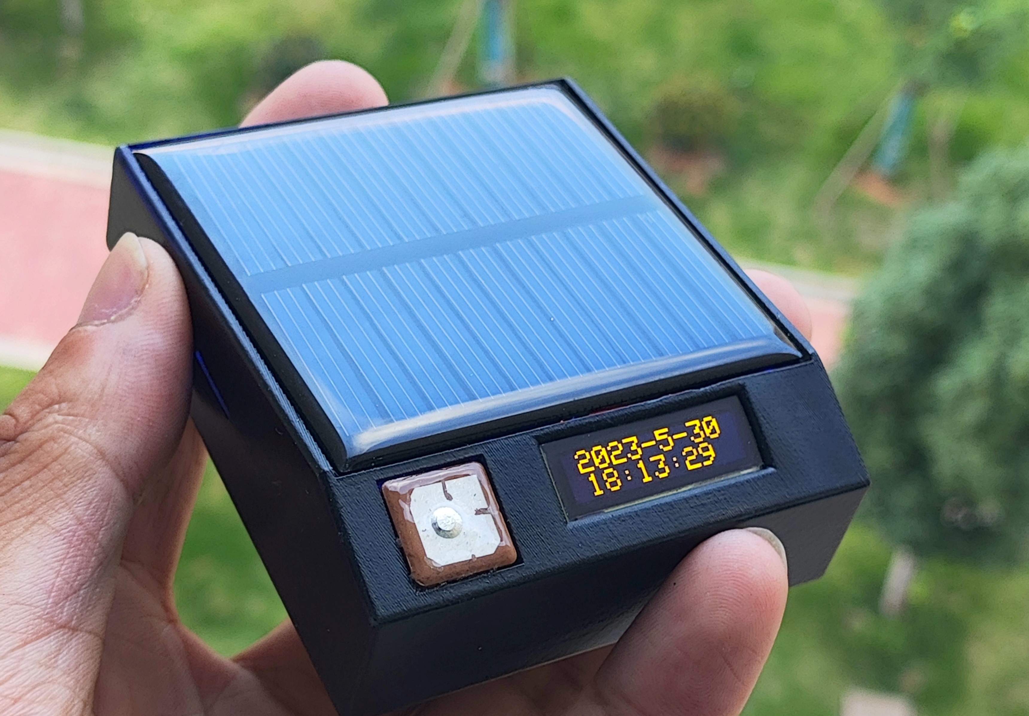

GPS
                        GPS + Electronic Compass Positioning Device Project Introduction: This project was developed to address positioning and navigation in the wild without network coverage. Initially, the STM32F103RCT6 development board was used for overall project development. After comparison and selection, the lower-cost STM32F103C8T6 was chosen as the main controller. An ATGM336H GPS positioning module and a QMC5883L magnetometer are used. The main controller collects information such as time, latitude and longitude coordinates, altitude, speed, and azimuth, and displays it on a 0.91-inch OLED screen. The system adopts a low-power design, with a built-in 320mA/h lithium battery. An external solar panel enables all-weather positioning without an external power source. The system is designed so that a single button connects both the MCU main controller and the DC power chip, allowing for power on/off with a long press and display interface switching with a short press, reducing operational complexity and minimizing the risk of system failure. When used with a paper map, the device can perform functions such as time viewing, positioning and navigation, orientation finding, and altitude marking.
Note: This version was completed in just 7 days from project initiation, so there are still quite a few bugs. This version is for reference only. Wait for the sequel.
