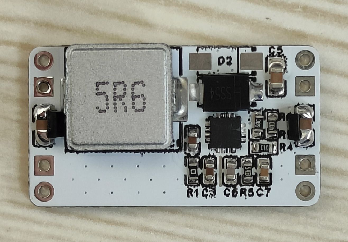

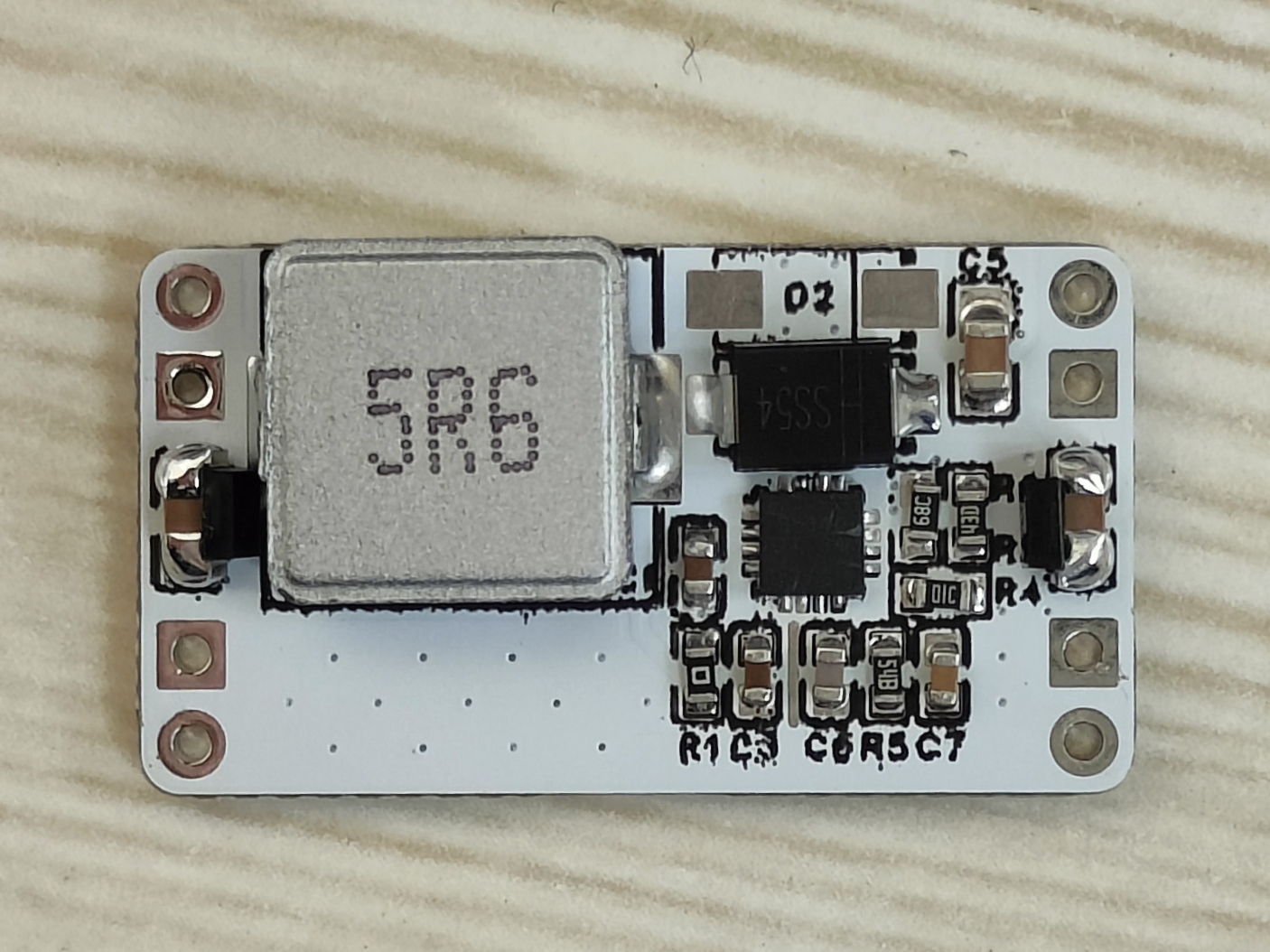

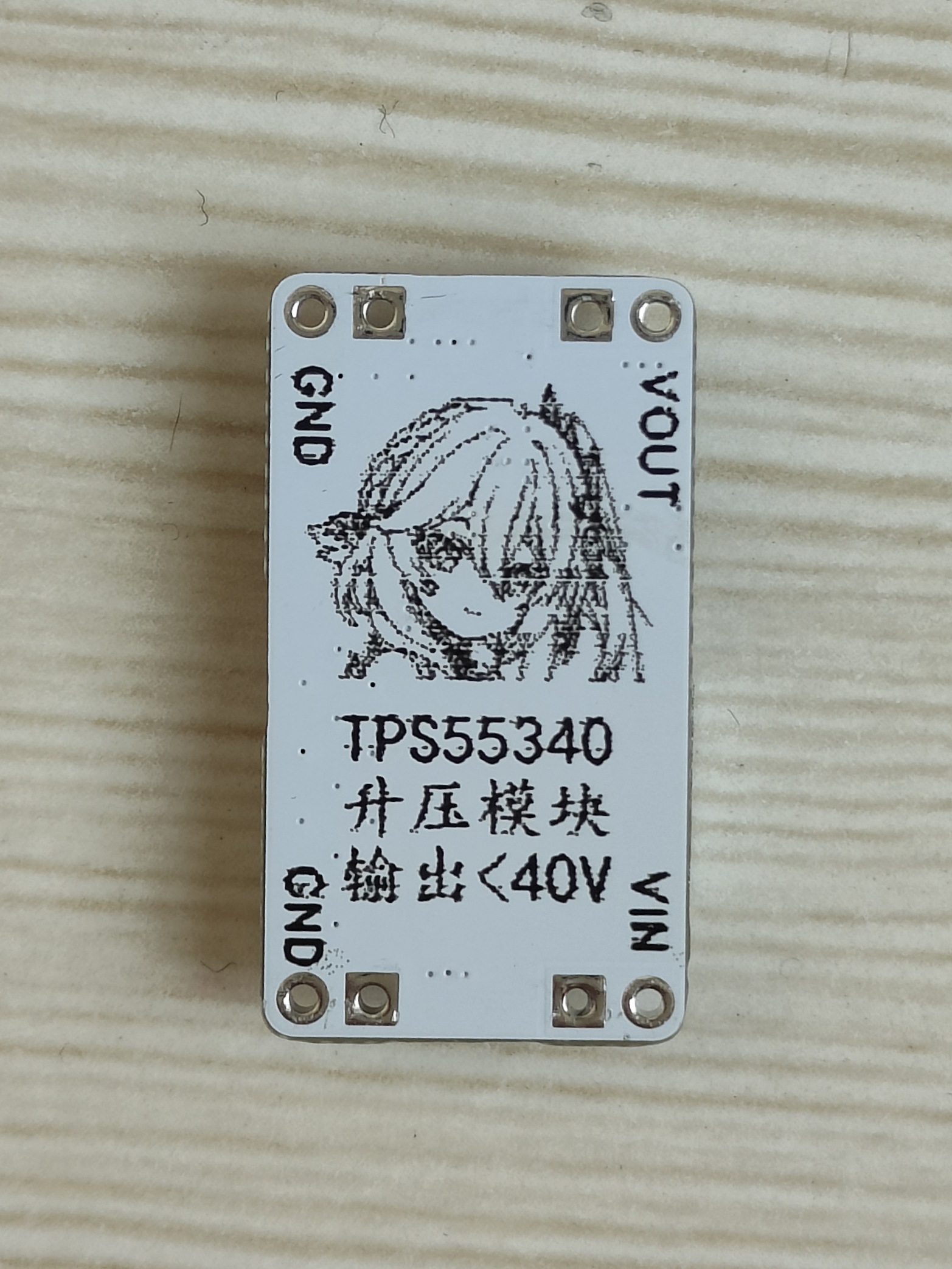

TPS55340 boost module
The
design incorporates a 2S battery with an input voltage of 5.6V~8.4V and an output voltage of 35V.
Using TI development tools, the current output should be fine for extended periods within the specified current range.
The TVS I used is the SMF33CA, which typically has a breakdown voltage of 36.7V, and it worked without issues at 35V output.
Front and
back photos are included.
