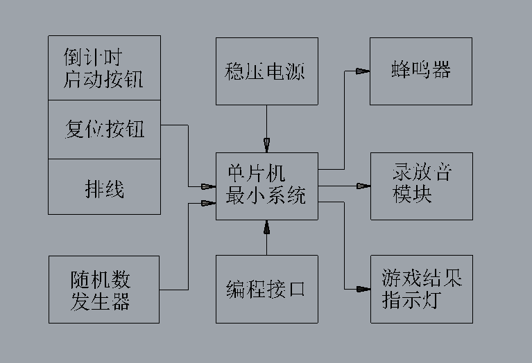

Design Principles
This project includes hardware and software components, enabling human-computer interaction with game participants, game content implementation, and game result presentation. The hardware component primarily consists of electronic circuit boards, composed of STC microcontrollers, analog integrated circuits, 4000 series digital integrated circuits, and basic discrete components. The software component is a microcontroller program written in C51, implementing functions such as random seed acquisition, external switch signal reading, countdown, win/loss logic judgment, and game result presentation. The hardware
component, with the STC microcontroller as its core, mainly includes a power supply, a microcontroller minimum system, a random number generator, external switch and connection status detection, a buzzer sound indicator, explosion sound playback, a game result indicator, and other auxiliary circuits. The system's functional block diagram is as follows:
The descriptions of each hardware circuit are as follows:

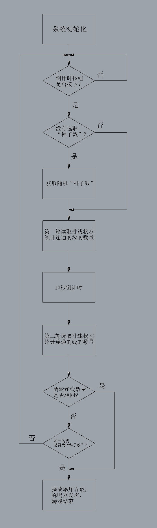

Software Description:
The software section is a program that implements functions such as randomly setting the seed wire to trigger the "explosion," determining the start of the game, reading the disconnection status, determining whether an "explosion" event has been triggered, outputting the buzzer sound, and controlling the recording and playback module. It is a C51 language program written for an STC microcontroller. The microcontroller program for this game console is attached. The software flowchart is as follows:

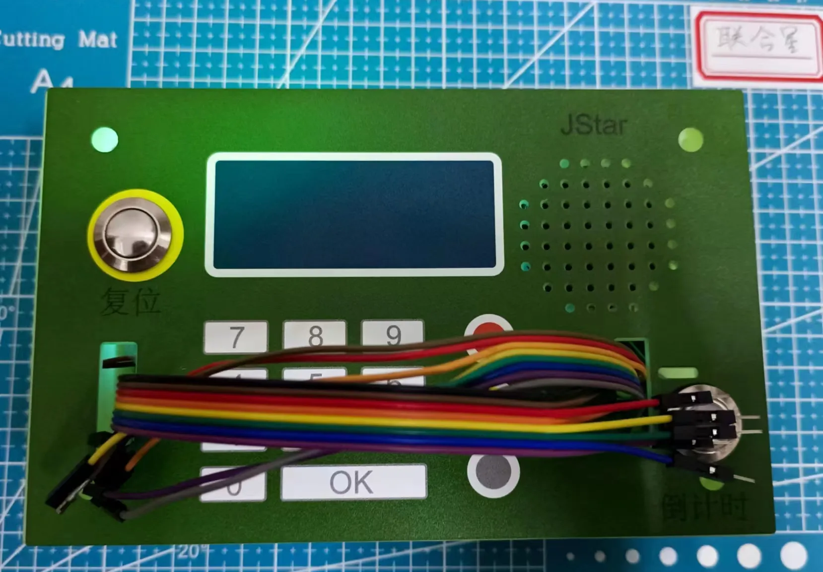

Physical demonstration
of the game console's appearance:

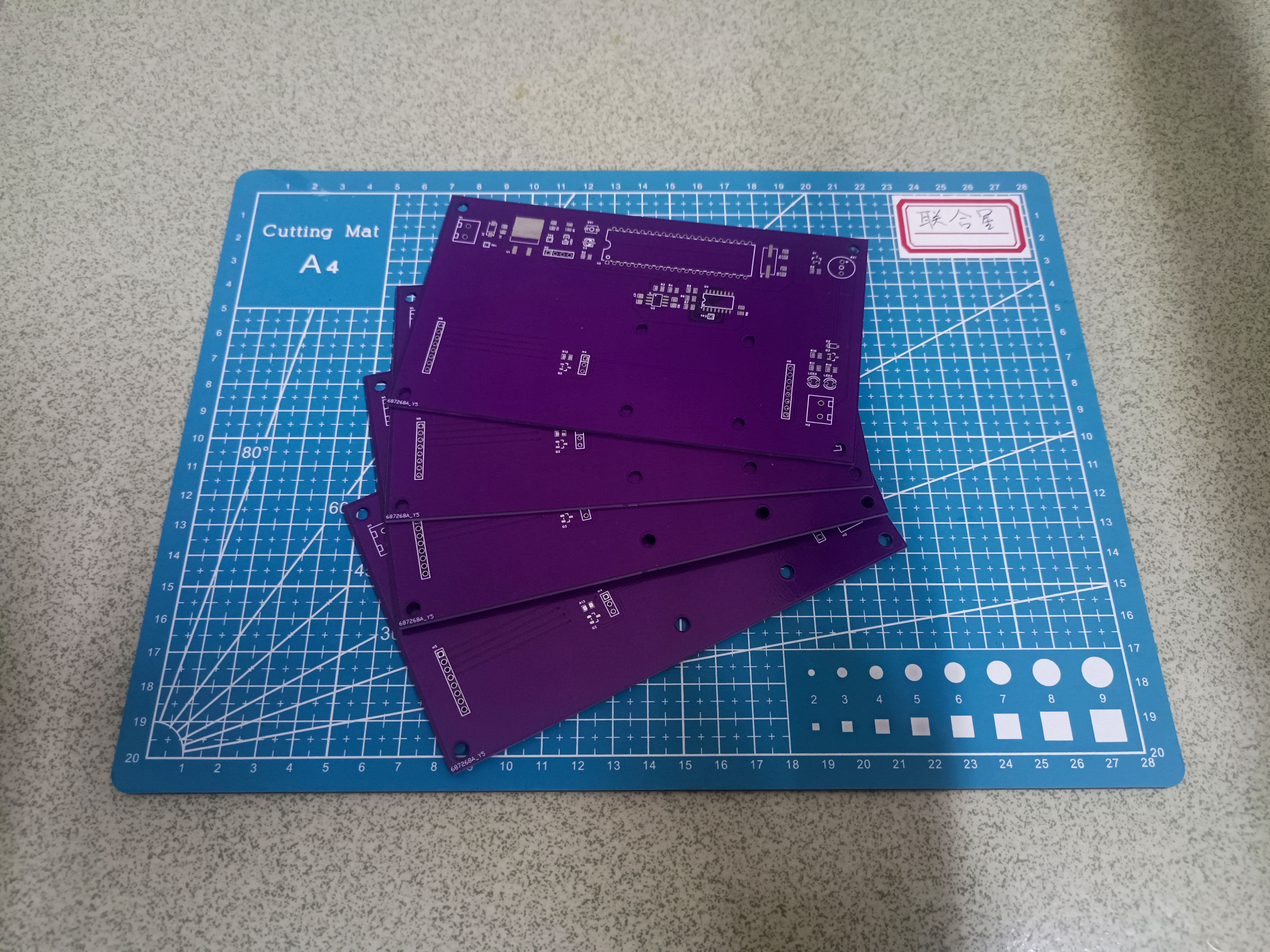

PCBA:

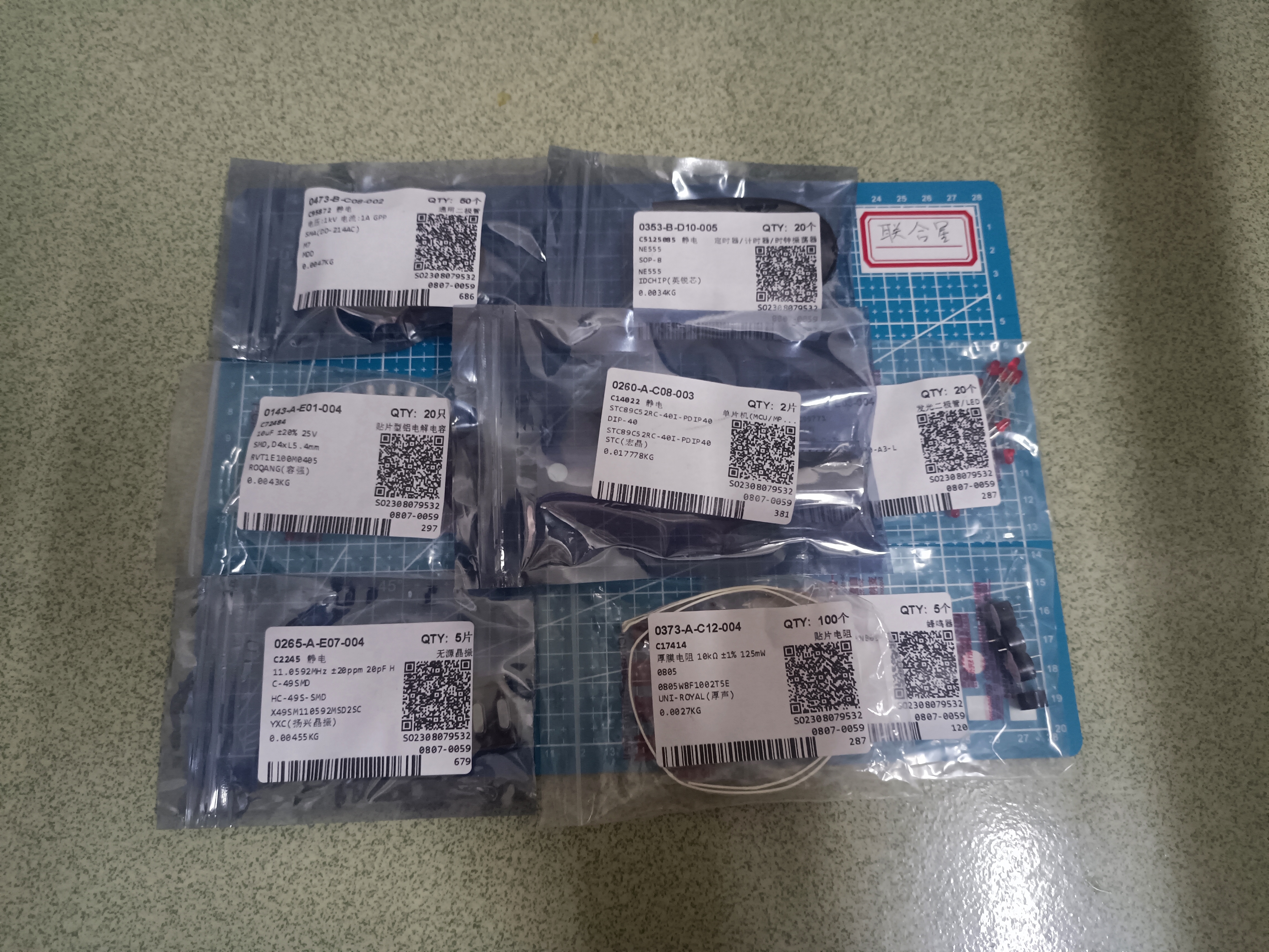

Electronic components:

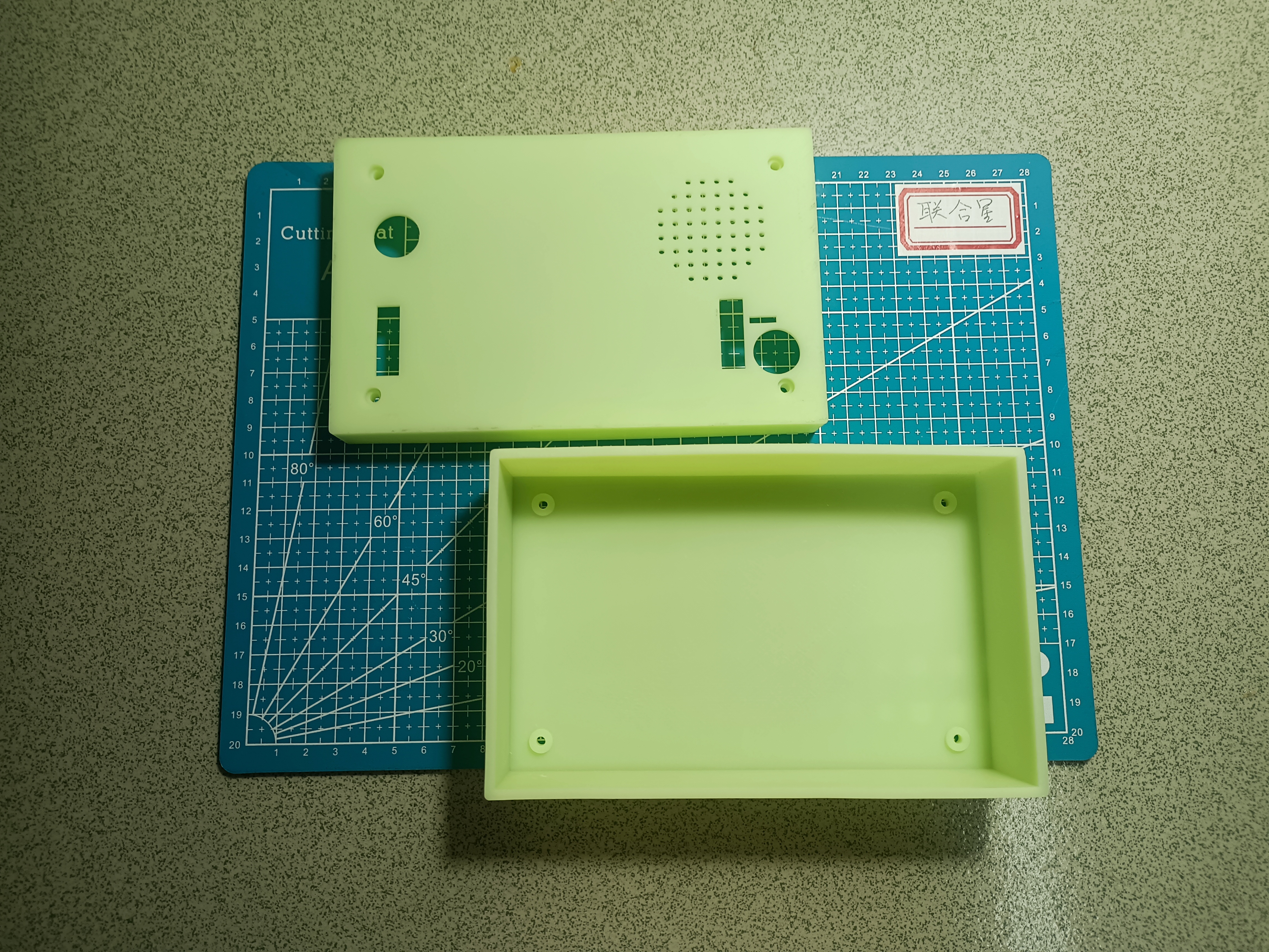

3D-printed plastic shell:

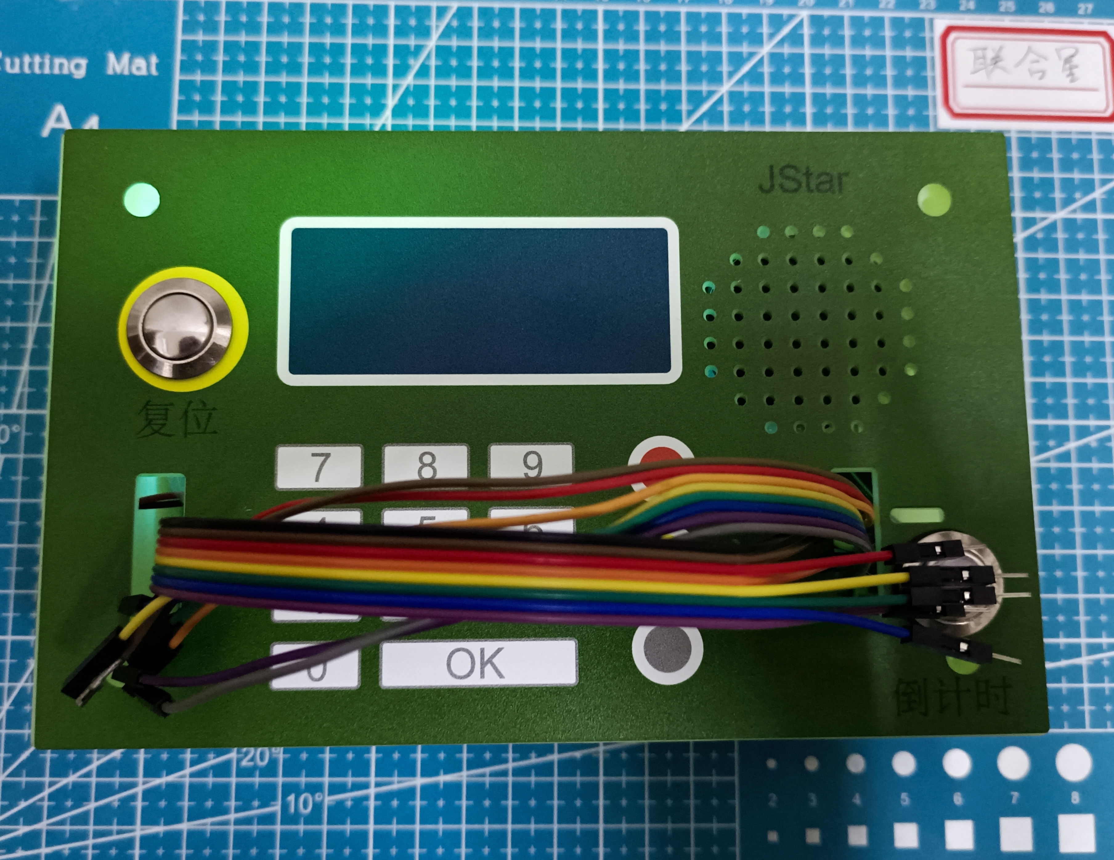

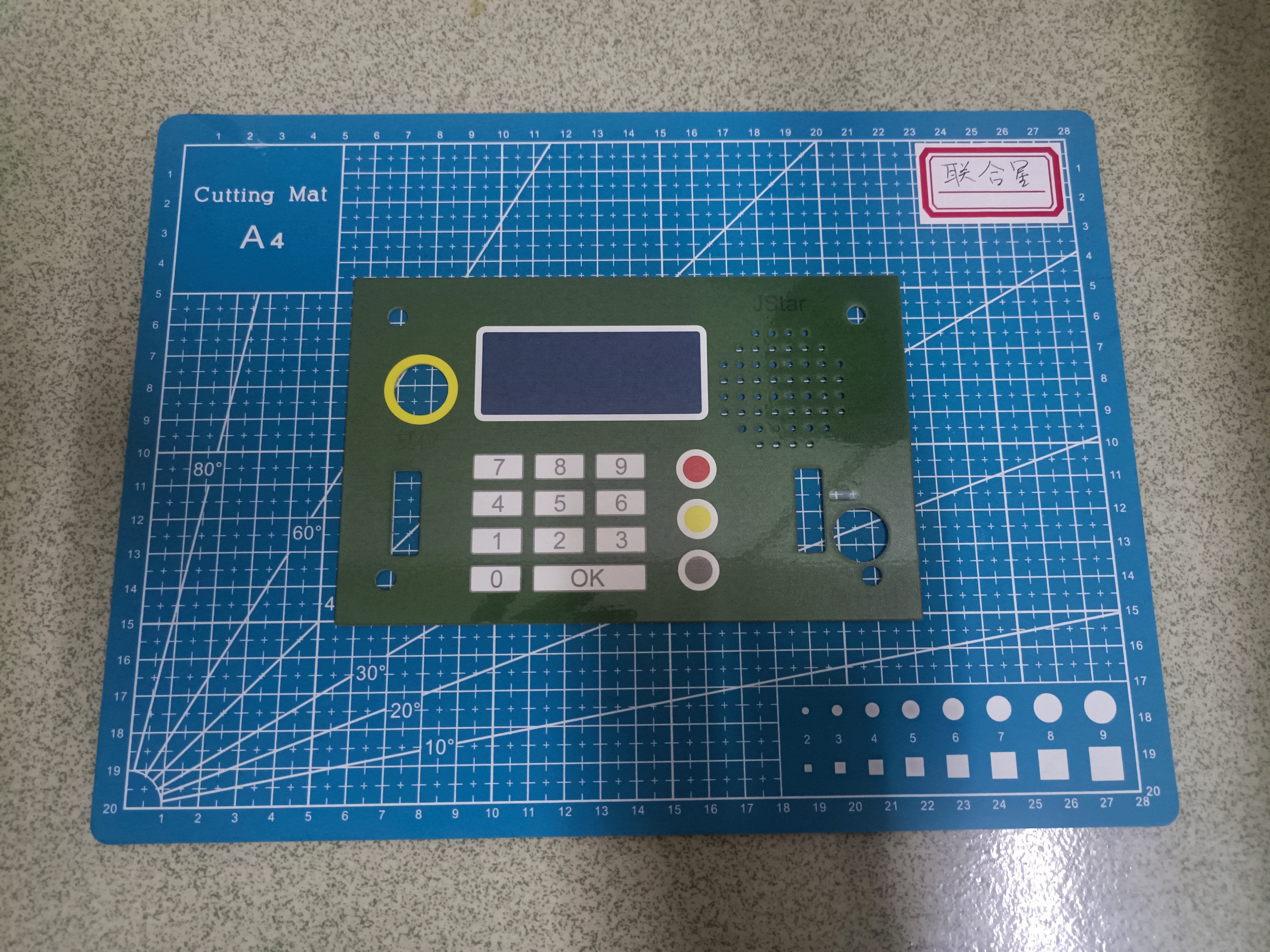

Acrylic panel:
