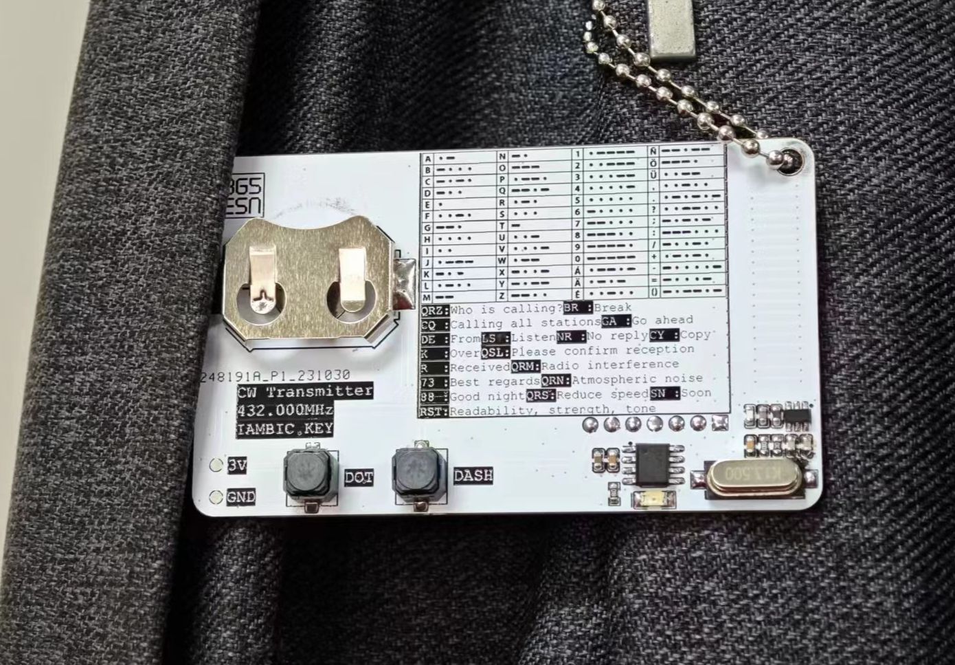

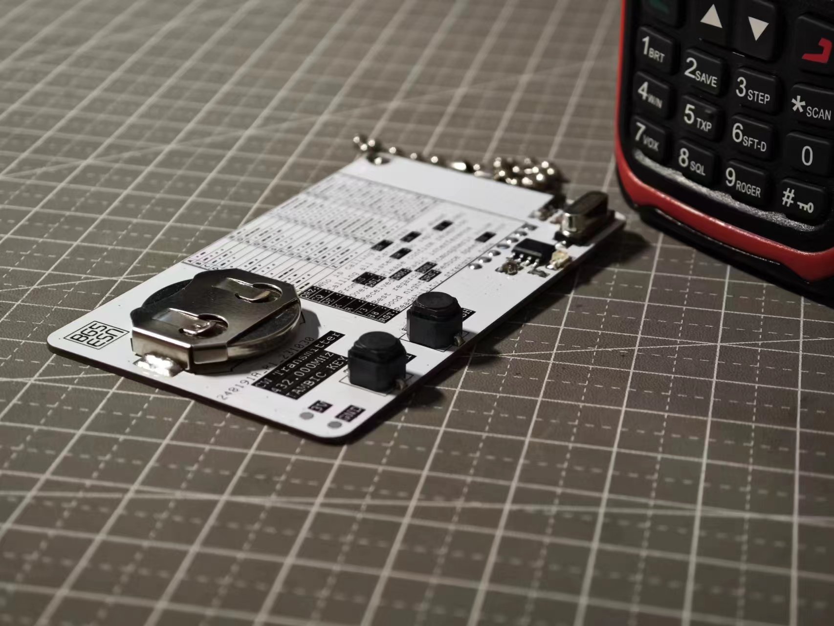

1. Basic Principle:
   Current key chips basically use a crystal oscillator multiplied by 32 to obtain a stable frequency. So, I had a sudden inspiration and created a QSL card based on this.
2. Implementation Method:
   A fixed-frequency PWM is applied to a common 433 wireless chip, which generates a beeping sound on the walkie-talkie side. (Fine-tuning of capacitors may be needed to produce the appropriate frequency.)
Additional Notes:
   Because this is a public version, I removed some personal information, as the original version contained some personal details that are not suitable for direct release. The layout has also been reduced in size for easier PCB fabrication and manufacturing.
   Interested users can easily adjust the appearance to suit their needs.
Below is my graphic design version.

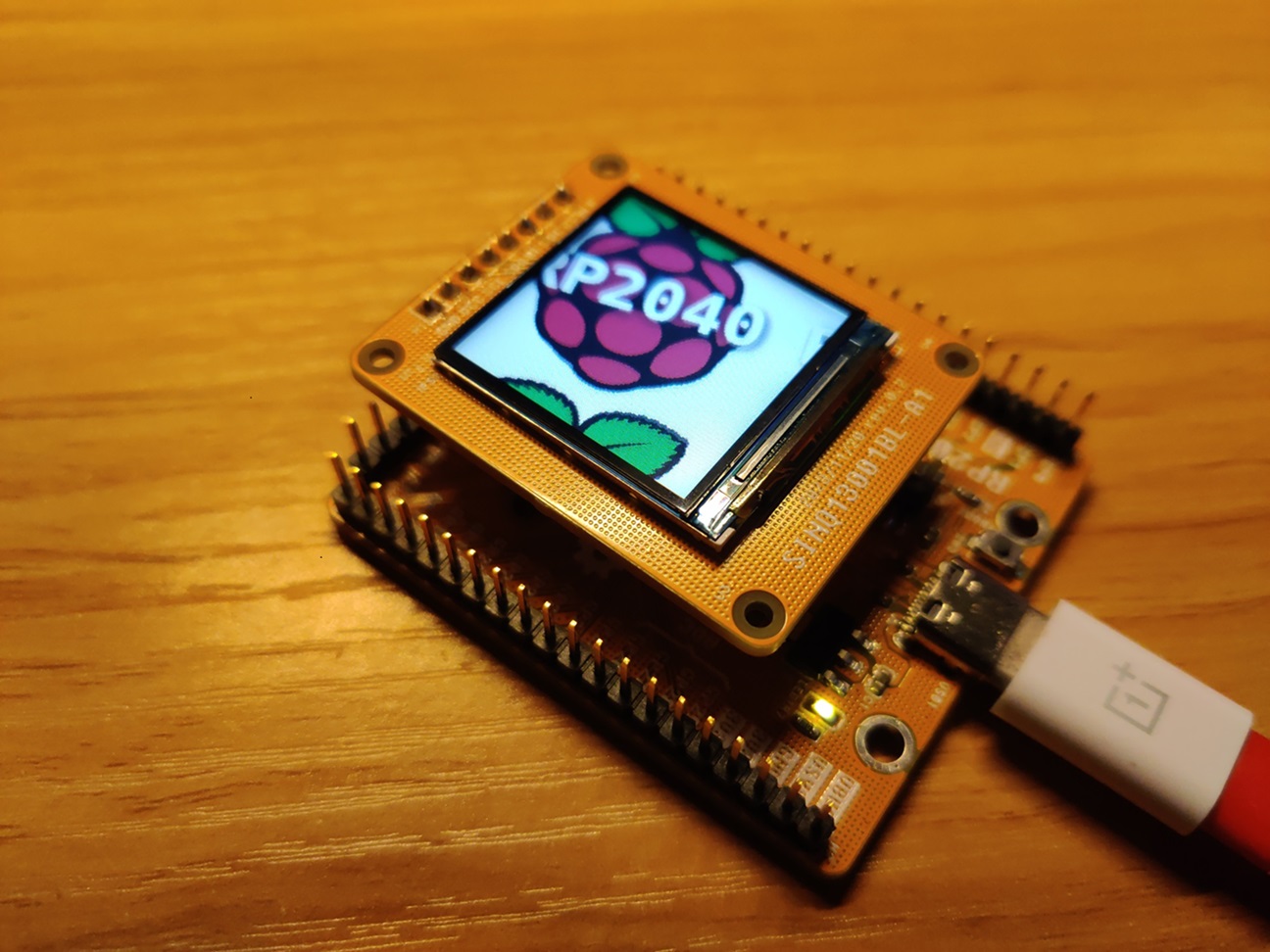

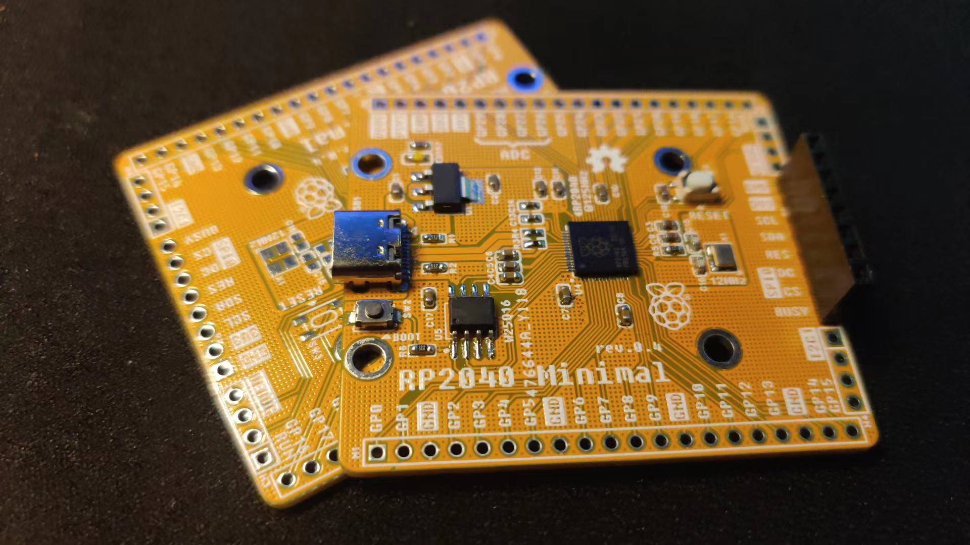

This is an embedded MCU development board based on the RP2040, taken from the official design but with slight upgrades.
**RP2040_Minimal** An embedded MCU development board based on the RP2040, taken from the official design but with slight upgrades.
GitHub repository: [https://github.com/embeddedboys/rp2040_minimal](https://github.com/embeddedboys/rp2040_minimal)
> Due to the different power supply scheme used on the board, the power supply interface is not compatible with **Raspberry Pi Pi**
> For example, **3V3_EN**, **VCC_SYS**
![rp2040_minimal.jpg]
The following interfaces are brought out via pin headers and female headers:
- 8-pin 3-wire SPI TFT interface (SPI0)
- 4-pin I2C interface (I2C1)
- SWD debug interface
Raspberry Pi Pi Chinese website: [https://pico.org.cn/](https://pico.org.cn/)
Official C-SDK reference examples: [https://github.com/raspberrypi/pico-examples](https://github.com/raspberrypi/pico-examples)
Micropython related: [https://www.raspberrypi.com/documentation/microcontrollers/micropython.html](https://www.raspberrypi.com/documentation/microcontrollers/micropython.html)
Rust developer: [https://github.com/IotaHydrae/rp-rs-lab](https://github.com/IotaHydrae/rp-rs-lab)
E-ink screen lvgl sample program source code: [https://github.com/IotaHydrae/rpi-pico-lab/tree/main/epink-lvgl](https://github.com/IotaHydrae/rpi-pico-lab/tree/main/epink-lvgl)
Have fun!

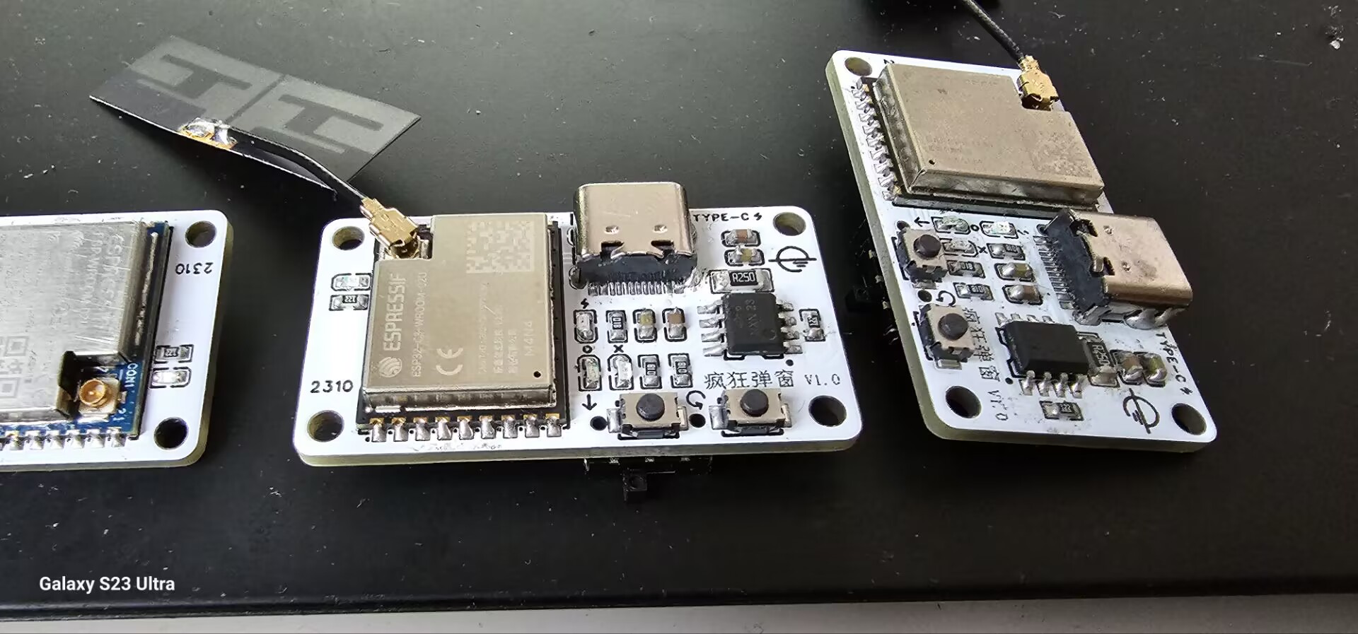

Simulated Apple pop-up window (IPEX external antenna version)
Make your Apple device explode with pop-up ads!!!
This project, the "evil Apple juice" project on GitHub,
is for entertainment purposes only!
Materials:
1) 50mm x 12mm x 30mm batteries - 150mAh (onboard is 300mAh)
2) 8 M2 copper pillars (4 pieces), 8 M2 screws
3) 3m double-sided tape to secure the batteries
4) Antenna selection: IPEX 1st generation cable, 6cm long, 35*11mm (FPC)
V1.0 (2023.10.24):
1) Simplified the ESP32 development board, added a battery management module for easy portability without external power supply;
2) This version has an external antenna;
V1.1 (2023.11.26):
1) Added battery holder;
2) Optimized circuitry;
Note: The performance of the external antenna version is consistent with the onboard antenna version. Weigh the cost and benefits yourself;
Disclaimer: This product is for entertainment purposes only. I am not responsible for any disputes arising from it. Suitable for Apple devices that support pop-up windows.
