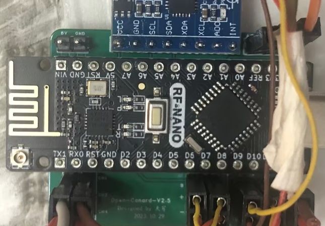

Building a minimal flight controller using Arduino and MPU6050 (with example programs)
The link https://www.bilibili.com/read/cv27782906/
includes a power distribution board; simply plug in the MPU6050 and Arduino ANO to use it. It features one IIC (MPU6050) input pin, one analog input pin (for connecting an angle-of-attack sensor), and three PWM input pins (receiver channels 1, 2, and 4 for pitch, roll, and yaw). It also has four output pins for supplying PWM to the servos (canards, ailerons, and rudder). The servo and Arduino power supplies are independent, with two power ports: 7-12V for the Arduino and 5V for the servos.
