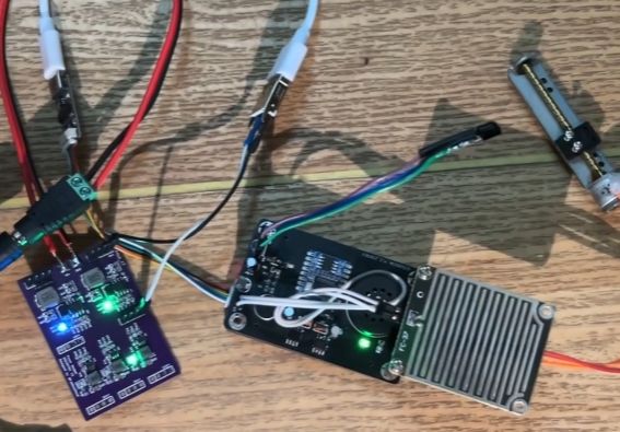

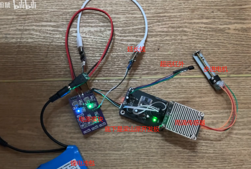

Based on the [LCSC Liangshanpai Development Board] Smart Curtain Project
The video address is attached: https://www.bilibili.com/video/BV1WV411c7qB/?spm_id_from=333.999.0.0&vd_source=0c39eb5086b90936ca8a5d3b0eb06e42.
I have followed the training camp of LCSC development board and completed the PCB and schematic production. The wiring
technology requirements of double-layer board are as follows

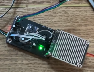

: (1) Raindrop sensor module: used to detect raindrops; (Taobao)
(2) Light intensity sensor module: used to detect light intensity; (photoresistor is fine, Taobao)
(3) Infrared receiver module, used for remote control; (Taobao Youxin ultra-long distance infrared)
(4) Stepper motor module: used for window curtain drive. (It costs more than 10 yuan on Taobao, no need to buy an adapter and just use DuPont wire)
### Technical Specifications
(1) Automatic mode can be turned on or off via infrared remote control and voice setting;
(2) In automatic mode, the curtains will automatically open when the light intensity is high and automatically close when the light intensity is low;
(3) In automatic mode, the curtains will automatically open when a large number of raindrops are detected, which has a higher priority than light detection;
(4) The curtains can be opened and closed at any time via infrared remote control or voice command, and the automatic mode can be turned off;
(5) After the main control chip receives the data, it drives the motor to run, realizing the intelligent curtain window system.

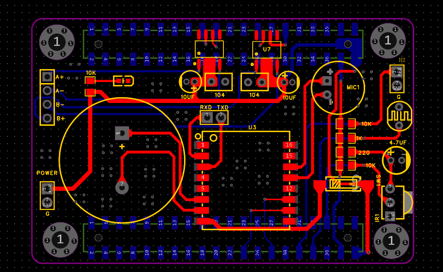

PCB Design Notes:
1. Avoid 90° right angles when routing traces.
2. Before starting the layout, check that all components and modules in the schematic are connected.
3. When routing traces, start with the power supply section, and widen the trace width, especially for motor modules where fill can be used.
4. Vias can be used for heat dissipation. Calculate the spacing between the pin headers on both sides and align them. Learn to use keyboard shortcuts as much as possible.

This ultra-long-range infrared receiver head can be purchased by searching "Youxin Electronics Infrared" on Taobao. Buy the universal long-range one.
Purchase link: https://item.taobao.com/item.htm?spm=a1z09.2.0.0.4be02e8dpoBqfX&id=642594293054&_u=72t4uge55e33
Don't waste money buying one with a slider and converter; just use DuPont wires and solder a couple of times.
Raindrop sensor module: any cheap item on Taobao costs a few dollars and comes with an ADC converter (though it seems unnecessary).
Assembly instructions:
Be careful not to solder the parts backwards when buying; check the orientation. Also, when buying the socket, you can buy surface mount or through-hole components; through-hole components are cheaper. After soldering, test with a multimeter before powering on! Love you!
