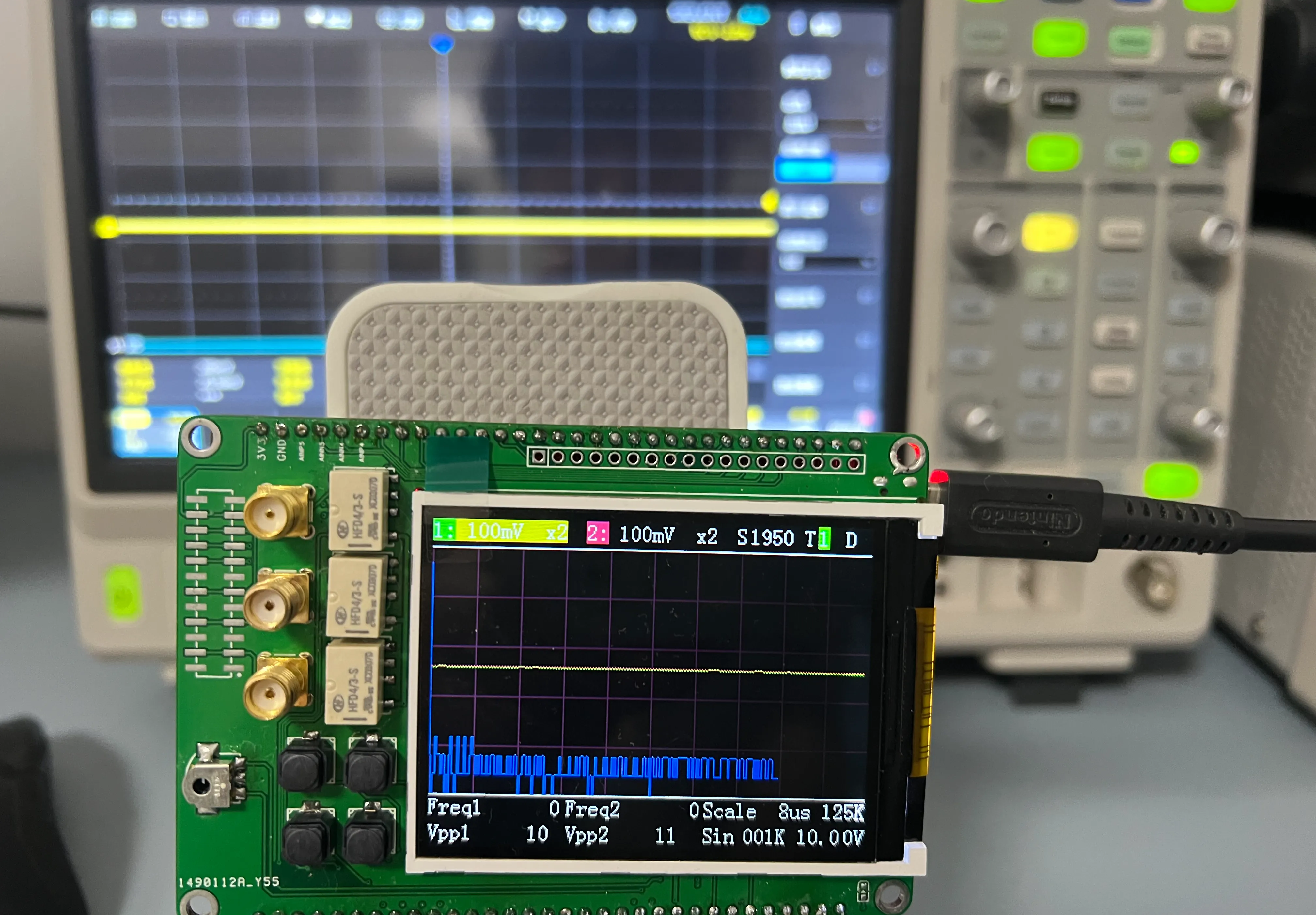

* 1. Project Function Introduction:
A simple oscilloscope. It displays sine waves up to 50kHz and outputs triangular, rectangular, and sine waves via a DAC.

* 4. Hardware Part:
Signal Conditioning Circuit Implementation:
We will first briefly introduce the analog input and output channels on the AFE03 board. We will then discuss the design and calculation methods in detail.
Analog Input Channel Introduction:
This includes signal conditioning implemented with resistor voltage dividers and operational amplifiers, and a square wave output implemented with a comparator (for triggering and frequency measurement).
INA, INB: The oscilloscope's input terminals. The pocket instrument outputs an analog signal connected here. A 1MΩ input impedance is achieved through a series resistor voltage divider, generating two selectable signals: one direct input and one attenuated to 1/20.
Gain: A selector switch that chooses either a direct signal or a signal attenuated to 1/20th of its input to the first-stage non-inverting amplifier. The non-inverting amplifier performs two functions: first, it amplifies the input signal at the non-inverting input by a factor of two; second, it shifts the amplified signal by 1.65V, calculated as Vo = 1.65 + 2*Vi. Therefore, the overall gain of the circuit is either 2 or 1/10.
AnalogA, AnalogB: The amplified and shifted analog signals from the non-inverting amplifier are connected to the STM32H750 development board and enter the H750's ADC.
TrigerA, TrigerB: The square wave signals generated by AnalogA, AnalogB, and the DC reference level (generated by one of the H750's DACs) after passing through a comparator, enter the STM32H750's timer for frequency measurement.
DAC_OUT2: The DC reference level, output through the STM32H750's internal DAC2 configuration.
