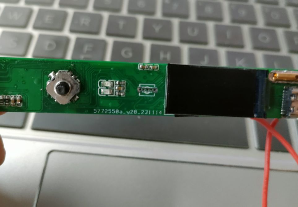

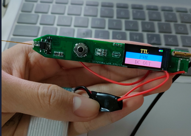

Multifunctional test pen

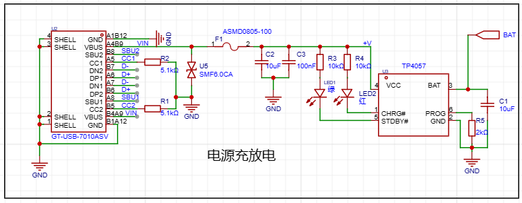

1. Power supply
: A 16-pin Type-C interface is used for charging and discharging. The numerous interfaces increase expandability. The Type-C interface here is not used for data transmission. Because this is a test pen, it needs to measure voltage.
If a large voltage is accidentally applied, it may damage the device. To prevent dangerous voltage transmission, it is not used.
A 5.1K resistor is used as a pull-down resistor (CC1, CC2).
The TP4057 is a commonly used battery charging chip. This design is based on a typical case (BAT is my 3.7V lithium battery power supply).
The component's datasheet contains a lot of information about it, including its typical applications.
We will use it frequently in our future learning and application, so we need to learn how to read its datasheet.

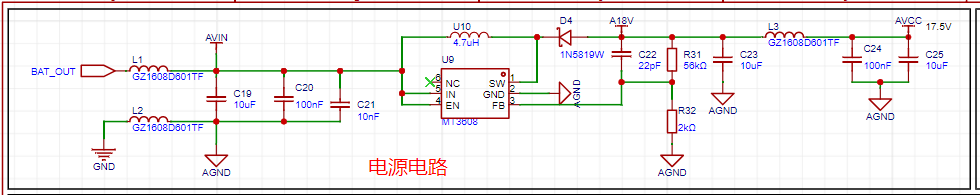

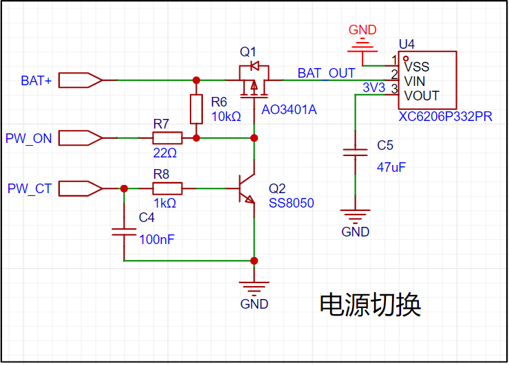

2. Power control and voltage regulation
conversion uses a P-channel linear regulator (
BAT+). As mentioned earlier, it uses a 3.7V lithium battery.
When there is no Type-C power supply, the lithium battery is used for power supply, switching using the P-channel regulator.

The button control section uses a five-way joystick switch (4-way + center button), which is a button with five switches.

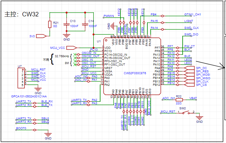

5. Main control chip configuration: The main
control chip is a CW32F030C8T6, connected to a small header for program download. This header only uses one pad and does not need to be connected to a pin header. A
high-precision clock and low-speed crystal oscillator are not needed for timing, so this part of the circuit is omitted. The unused interfaces of this circuit are marked.
I have drawn the circuit diagram for this part in another schematic diagram of this project.
The reset button here is connected to the header port, so the button will be soldered after the program is burned.

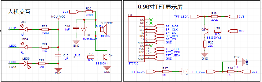

6. Human-Computer Interaction:
The current-limiting resistor in this circuit can be changed according to your needs
. Two LEDs (choose two different colors) are used to display the high and low levels of the measurement.
An additional LED is used for illumination, placed at the front of the PCB board for easy detection in low-light conditions.
The display screen is a 0.96-inch TFT color screen used to display the measured values.
A buzzer was also used for indication. The schematic diagram uses an electromagnetic buzzer, but I used a voltage-type buzzer during soldering to reduce power consumption.

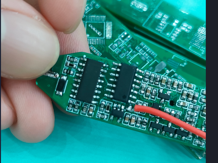

7. Bluetooth
uses BLE Bluetooth for wireless transmission with the computer. I chose the KT6368A to save space.
Wired data transmission might cause the floating ground of the test leads to become grounded, which could easily burn out the circuit.
8. Analog power supply
(Here I divided this schematic into two schematics, one for digital circuitry and one for analog circuitry.
    The digital circuitry is divided into many modules; the analog circuitry is connected together, which allows for a more intuitive analysis of the analog front end).
To reduce power supply interference, a series resistor and capacitor can be used to form an RC circuit to further reduce interference in the low-frequency band.
The MT3608 chip was chosen

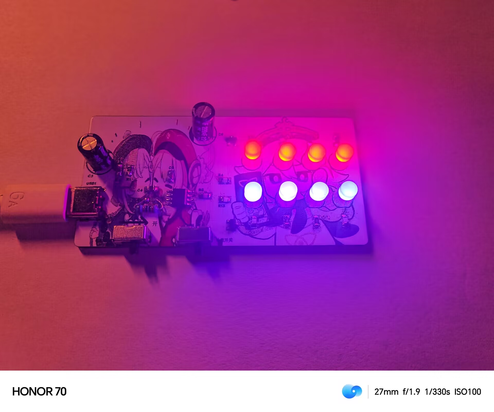

[Color Silkscreen Printing] Genshin Impact Transformation Device [Voice Playback]
Genshin Impact Transformation Driver
The Genshin Impact transformation device
is now complete . The design is inspired by the Kamen Rider transformation device and incorporates its features. The pattern is from the official badge stickers released by miHoYo; other patterns can be used as needed. It uses the reprogrammable chip WT588D-20SS, which is readily available and easy to use (but has been discontinued due to its age and inability to be driven after downloading). A nine-core NV400F chip has been replaced. Single-piece and four-piece prototypes were created within the project. The four-piece prototype requires manual cutting but is more cost-effective. Printing is optional. The board features a pure bottom-layer layout with no vias. To ensure a complete top surface soldering, the positioning posts for the Type-C port, switch, and buttons need to be cut off. The images below are from the old version; the new PCB has been redrawn. Operation: Pressing the top button produces a sound effect. The board is only designed for single-button operation, but multi-button operation and programming are possible; modifications can be made if needed. The burning tutorial and software file are too large to upload. They have been uploaded to Baidu Cloud via this link: https://pan.baidu.com/s/17g81MBAu6D0OjQcWWzcYtQ?pwd=td40 Extraction code: td40. The official TTL burning tutorial verification failed; an offline dongle is used for burning. The dongle needs to be purchased separately. [Offline Dongle Copying] The audio conversion software in the package converts MP3 audio to FLA format. Import all audio files and command txt files into the offline dongle. The key command is "down". The format must start from 000, otherwise it will not be recognized . Due to space limitations on the PCB , various coil types were tested. A single coil can be recognized, but after adding a battery, the coil cannot be recognized because the battery shields the operation. Neither of the two PCBs in the project could be used, so a self-made coil was finally used. The phone can recognize the device after adding a battery in the project. The outer shell is made of 3D transparent 8001 stainless steel. The version shown in the project is without chamfering and logo. The STL file in the link has been refined; you can choose to print it yourself. Fasteners: 3 M2 screws , 6 M2 knurled nuts (just align them). Battery: C5182591 , size 402030. You can purchase this yourself. For the project, you can choose a smaller battery from LCSC. Speaker: C530539 GSPK151035PN-8R0.5W-L35-1.25T chip, can directly drive an 8R0.5W speaker. You can purchase this yourself. Other power ratings like 1W and 0.7W can also be driven. Video: https://www.bilibili.com/video/BV18N411u7Hr/?spm_id_from=333.999.0.0
