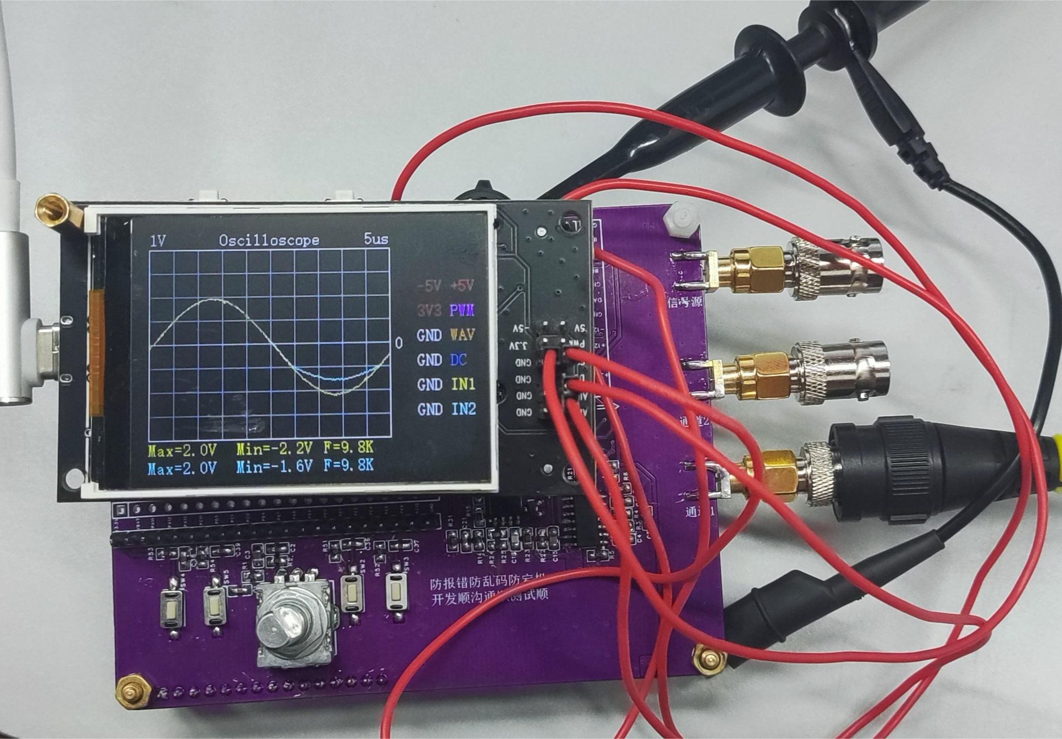

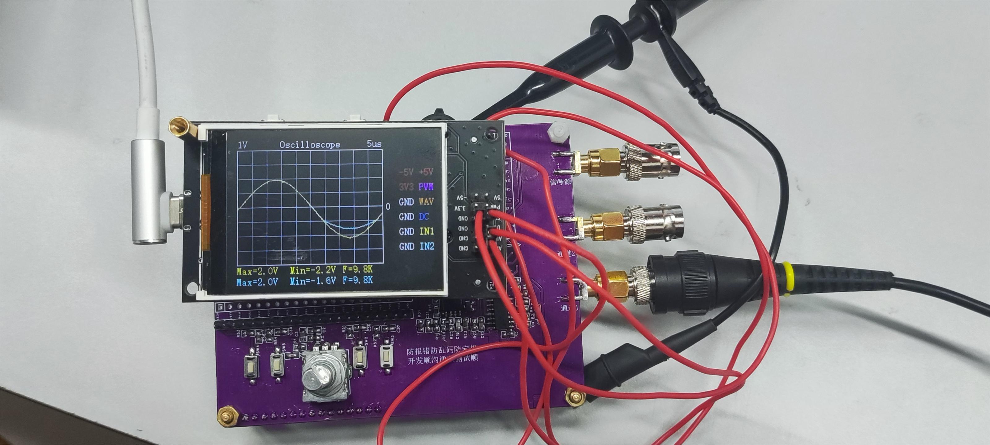

Instruments and meters (oscilloscopes)
Unlike the official example, the board doesn't have a slot for the screen cable. The Zhengdian Atom H750 has a dedicated adapter board,
making it easier to operate with the screen on the same side as the buttons and knobs.
The dual-channel signal input
has a separate charging/discharging module, outputting 5V2A.
The first version was sent, and the second version works, but requires jumper wires (doge).
VID_20231120_171834.mp4
VID_20231120_171741.mp4
PDF_Instruments (Oscilloscopes).zip
Altium_Instruments (Oscilloscopes).zip
PADS_Instruments (Oscilloscopes).zip
BOM_Instruments (Oscilloscopes).xlsx

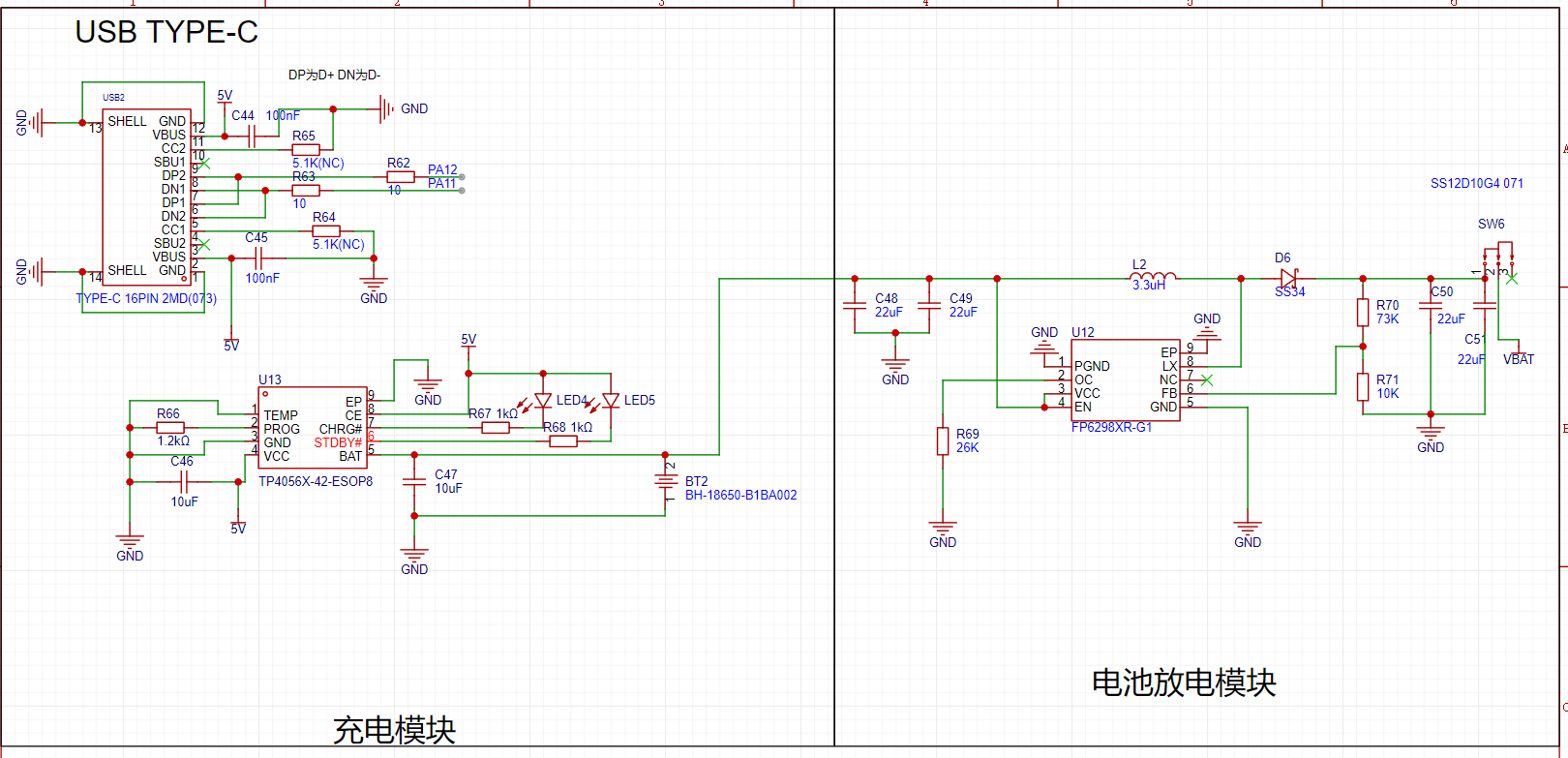

1. Power and Battery Management
1.1 Charge and Discharge Management
In the charging IC section, I chose the commonly used TP4057 as the main controller. The power input uses the most common Type-C interface. Although a 6-pin interface would be sufficient for this project, a 16-pin interface was chosen for scalability. The SBU1 and SBU2 pins of the Type-C interface were used for expansion board connections. D+ and D- were not used as expansion lines because the device's output signal might cause the charger to misinterpret the signal, resulting in an incorrect voltage and potential danger. This needs to be considered in the design. In
the circuit diagram, you can see that CC1 and CC2 of the Type-C interface are connected to 5.1K pull-down resistors to ground. This is to ensure that the charger accurately identifies the device when using the CC line. If the AC line is used, resistors R2 and R3 do not need to be soldered.
The main parameters of the TP4057 charge and discharge chip can be found in the figure below. In my design, the setting resistor for the PROG programmable constant current charging current setting terminal is 2K, indicating a relatively aggressive charging strategy.

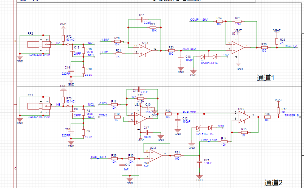

3. Analog Front End
As we all know, the analog front-end is the analog circuit that precedes the digital circuit (something seems off, but it makes some sense). Okay, enough joking. By definition: AFE (Analog Front End) processes the analog signal from the signal source and digitizes it. Its main functions include: signal amplification, frequency conversion, modulation, demodulation, adjacent channel processing, level adjustment and control, and mixing.
Now that you know what the analog front-end is, let's build a 10G oscilloscope (
3.1) . While this project isn't about building a 10G oscilloscope (and I can't build one right now), the basic
design principles for analog front-ends are similar: what kind of signals will I be acquiring, and what kind of signals will my device be acquiring? To illustrate, imagine I can hear English, but I only understand Chinese. Therefore, I need a translator, which is what we call an "analog front-end."
Returning to the test pen project, my system design goal is to acquire signals from 0 to +15V and output signals from 0 to +5V. That's the most basic goal, quite simple, isn't it?
However, this project has a special case: I want to achieve all input and output functions on a single probe (I'm clearly a demanding client), which requires consideration of input, output, and other factors. Switching is then necessary. At this point, some clever developers might immediately think of a relay. Yes, relays are indeed very useful in this scenario, but they bring another problem: size. Since this project is a portable test pen, I naturally don't want to make the device too large (it's inconvenient to use). Therefore, relays are not suitable in this situation. Thus, we need to introduce another switch: an analog switch.
Analog switches have existed since the early 74 circuits. They have relatively high internal resistance (this description might not be entirely accurate; more precisely, they are on-resistance). However, with increasingly sophisticated devices, low-resistance analog switches have emerged, with internal resistances as low as mΩ. In this project, because the input voltage is relatively high, and the through voltage of low-resistance analog switches is relatively low, the relatively "old" 4053 chip was chosen. It is an SPDT, 3 The channel analog switch, with an operating voltage of up to 20V, perfectly meets the requirements of this project. At this point, some observant students may notice its relatively high internal resistance, reaching 200-240Ω. Will this affect the system accuracy? The answer is yes, but as this project is a simple portable testing tool, the impact of the analog switch's internal resistance is negligible. Furthermore, the DC bias introduced by the analog switch itself can be corrected through calibration (this project does not include advanced functions such as multi-point calibration, but it does include short-circuit calibration, emphasizing simplicity and ease of use).
3.2 The analog power supply
we selected, the HT4053A, has a maximum operating voltage of 18V. To allow for some margin, I designed the system voltage at 17.5V. Since the front-end voltage is directly powered by the battery (approximately 4.2V~3.5V), we need a boost converter to power the analog front-end.
For chip selection, I chose the commonly used MT3608 chip. Its 2A output current is sufficient, and its relatively high switching frequency of 1.2MHz also helps with subsequent filtering. The boost inductor is a 4.7μH inductor in a mini SMD252010P package (2.5*2.0*1.0mm), which helps save PCB area (and looks better). Despite its small size, it has a rated current of 1.6A and a saturation current of 2A, which is sufficient for the system. While the voltage divider resistor configuration may seem arbitrary, there are certain considerations. An inappropriate configuration will affect the power supply's output voltage ripple and load regulation performance, but due to space limitations, this will not be discussed further here. Further details are omitted; interested students can consult relevant materials for further study.
It's important to note that this project does not use dual power supplies; there is only a positive power supply and no negative power supply. Therefore, the test pen can only input/output positive voltage signals. If a negative signal input is required, the subsequent circuitry will need modification. Due to size considerations, a single power supply solution was ultimately chosen for this project.
Since switching power supplies introduce interference, and analog circuits are also subject to various types of interference, a ferrite bead was used for isolation between the digital and analog power supplies. This also facilitates single-point grounding.
The red box shows the analog front-end power supply circuit, providing an AVC test point for quick voltage measurement. The left side of the diagram above shows the analog front-end; above the middle button is the power circuit; below the middle button is the button debounce capacitor; and the right side shows the digital circuitry. The copper foil on the ground plane is slotted for isolation, and the current return path has been optimized.
The ground plane and return path design can be seen in the diagram above (front of the PCB).
3.3
Are you feeling sleepy after reading so much about the signal input circuit ? Don't worry, the main course is just beginning: Signal Input Conditioning Circuit:
The diagram above shows the most basic signal input circuit. First, a bidirectional TVS diode protects the subsequent circuitry. Then, the signal can be selected as either input or output mode via analog switch 3 (COM3 and NC3, NO3) (default output mode). Analog switch 2 allows selection of whether the input signal is attenuated. The analog front-end design is inspired by an oscilloscope, with an input impedance of 1MΩ. Like an oscilloscope, it allows selection of X1 and X10 ranges, with X10 selected by default. This design maximizes the safety of the subsequent circuitry, acting as if there were an independent... When storing a multimeter with a power button, the range should be set to "AC voltage, maximum range," similar to how
the TVS diode (highlighted in red in the image above) should be placed closest to the input during PCB layout (if other protection devices are present, the PCB layout needs to be carefully considered) to better protect subsequent circuits. The
signal then passes through a voltage follower for impedance matching, a low-pass filter to filter high-frequency noise, and finally a clamping diode (OUTA_0 network) for voltage limiting protection before being input to the microcontroller's on-chip ADC.
It's important to note that it's not recommended to directly connect capacitors to the operational amplifier output, as this can easily cause... Due to oscillations and other factors, a small resistor is needed. Although the resistor and capacitor together form an RC low-pass filter, based on my RC selection, its single-stage cutoff frequency at a 6dB descent rate is calculated to be 723.7985kHz, therefore it will not affect the normal measurement of the test leads.
The diagram above shows the clamping protection circuit. The designed clamping voltage is obtained through power supply voltage division, and then a voltage follower is used to give it the ability to absorb voltage. It should be noted that because the diode has a forward voltage (typically 0.35V for this protection diode), the voltage of the voltage follower should be appropriately lower than the protection threshold voltage. In this design, a voltage of 3V is used, plus the 0.35V of the diode, to reduce the protection threshold voltage. The protection threshold is set at the maximum input voltage of the microcontroller's ADC, 3.3V (in fact, the CW32 microcontroller generally won't be damaged even with a 4V input ADC when operating at 3.3V).
The analog input voltage, after attenuation, is split and fed into this comparator. The comparator's threshold voltage is obtained by converting PWM to DC (see the "Signal Output Circuit" section for detailed circuit analysis). To prevent oscillations, a large resistor is essential to construct the hysteresis comparator. Through this circuit, we can perform simple frequency measurement and digital analysis on the input signal.
This completes the signal input processing chain. The remaining step is to input the processed signal to the microcontroller's ADC for measurement and processing.

Principle Part:
Signal Conditioning Circuit:
Analog Input Channel Introduction:
Includes signal conditioning implemented by resistor voltage divider and operational amplifier, and square wave output implemented by comparator (for triggering and frequency measurement).
INA, INB: Input terminals of the oscilloscope. The STM32H750VBT6 outputs analog signals that connect here. A 1MΩ input impedance is achieved through a series resistor voltage divider. Direct connection or 1/20 attenuation can be selected.
gain: Selector switch, choosing
