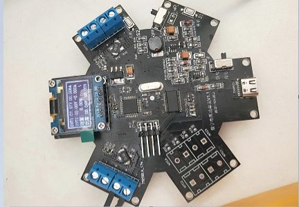

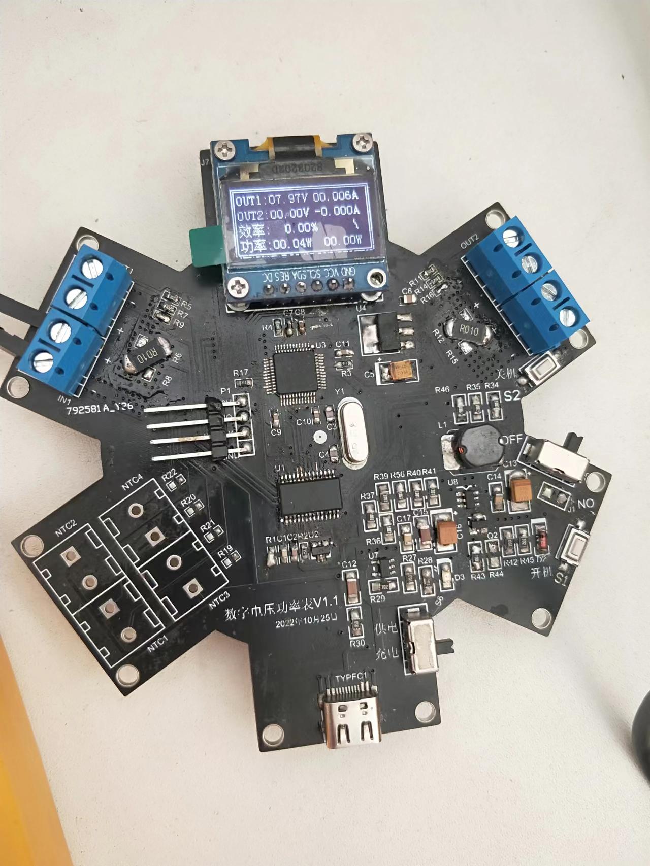

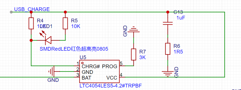

1. Lithium Battery Charging Circuit:
This circuit uses the LTC4054 battery management chip to charge the lithium battery. The LTC4054 is a lithium battery charging chip manufactured by Linear Technology, specifically designed for charging single-cell lithium batteries. Only a few external components are needed; no dedicated heatsink is required. The charging current can be adjusted via the 5-pin resistor, supporting a maximum charging current of 800mA.

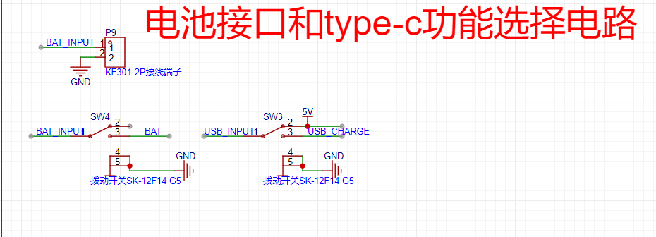

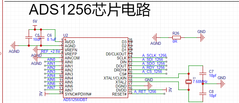

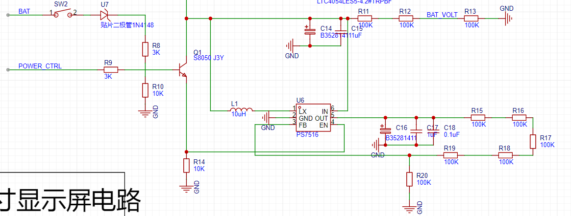

2. PS7516 Boost Circuit, Voltage Detection Circuit, and Soft-Start Circuit:
 Since the ADS1256 requires a 5V power supply, the PS7516 boost chip, which can be turned off, is chosen to control the output of the boost circuit.
An external 3.7V lithium battery can be connected to power the entire circuit board, or a Type-C power supply can be used. The Type-C interface can also be used to charge the circuit board. The specific circuit diagram is shown below.

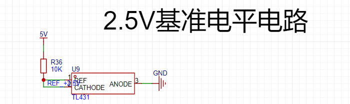

4. 2.5V Reference Circuit:
This uses the TL431 power supply chip to provide a reference for the ADS1256. Other basic voltage chips can also be used.

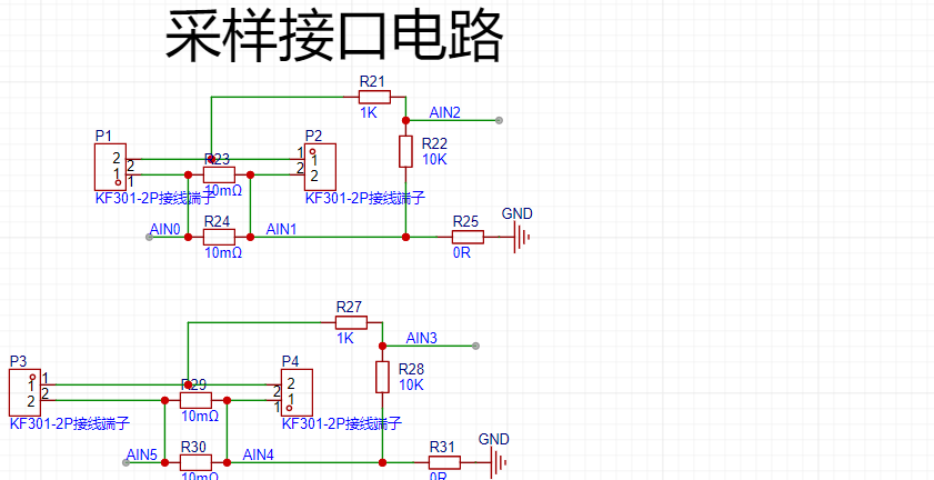

5. ADS1256 Sampling Circuit and Peripheral Circuit

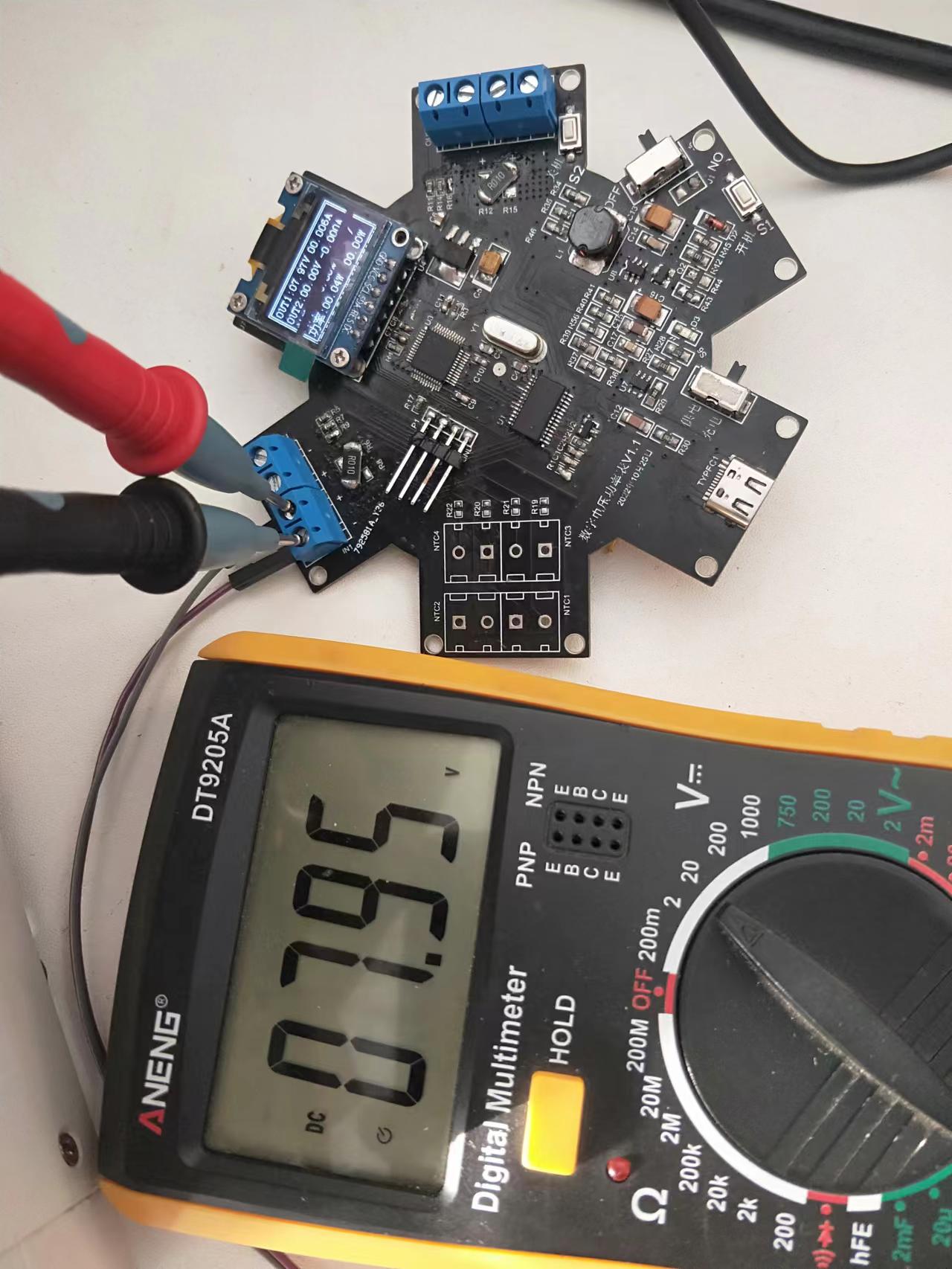

#LCSC EDA Instrumentation Training Camp# CW32 Point Crystal Multifunctional Test Pen
This is a multi-functional crystal testing pen designed with the CW32F030C8T6 as the main controller.
The pen's functions include: 1. Voltage level measurement; 2. Circuit continuity measurement; 3. PWM signal output; 4. Diode detection, etc.
It's a compact and portable crystal testing pen, making it a useful measuring instrument!
Following the LCSC training camp's replica of the PointChip CW32 multi-functional test pen
: I. Main Controller: CW32F030C8T6.
Vcc, GND, DIO, CLK, and REST are brought out separately for easy programming. A reset button is also included; this button doesn't necessarily need to be soldered on, but can be reset by shorting REST and GND with tweezers.
II. Signal Output Circuit:
        The signal output circuit can output DC signals or directly output PWM signals. Essentially, it directly outputs signals from the microcontroller. The DC output level is achieved by adjusting the duty cycle of the PWM (the set signal frequency is 20kHz; for other frequencies, the DC calibration value needs to be modified), and then converting it into a "DC" signal through two stages of low-pass filtering.
        However, since the output voltage of the PWM-to-DC converter is lower than the high level of the PWM, it can only output voltages from 0 to (+3.3VX), which does not meet the 0-5V target I proposed in the design. Therefore, an operational amplifier was added to double the voltage output, ultimately allowing an output voltage from 0 to 6V, meeting the target requirements. The amplified output voltage, after passing through a low-pass filter, yields a more ideal DC signal. (This uses a positive proportional amplifier circuit, amplifying the signal transmitted from the front end by a factor of 2.)
