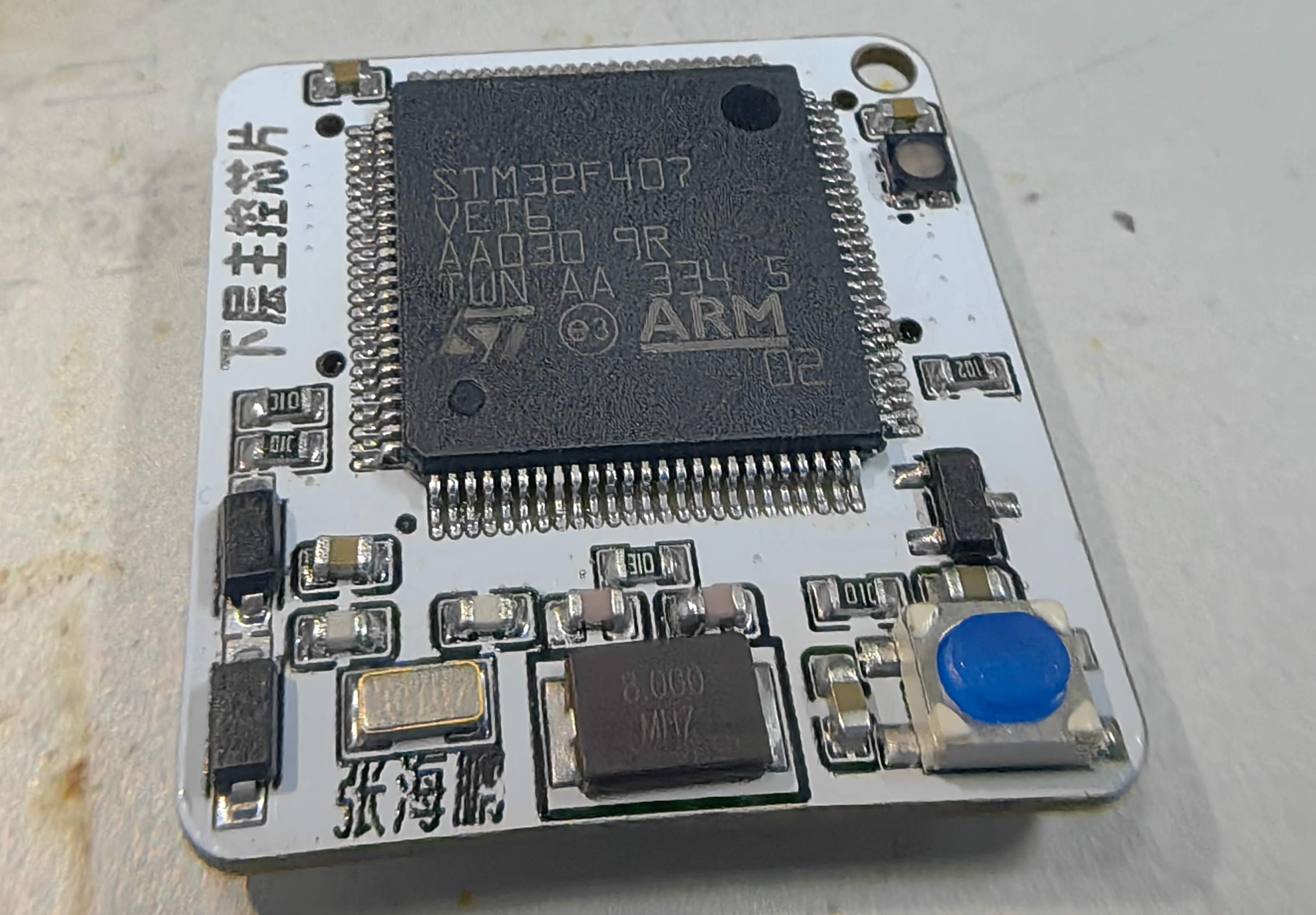

The core board breaks if you disassemble it, so I made my own. This way, I can disassemble it whenever needed, and it can be reused on new boards.
For the 3.3V step-down module, make sure to check the model before purchasing
; it works perfectly after testing.
I chose Xingkun connectors; the gold plating makes them stable and easy to solder. I used a hot plate soldering machine, but if that's inconvenient, a soldering iron with a blade tip works just as well.
I'll make a prototype first to check the results .
