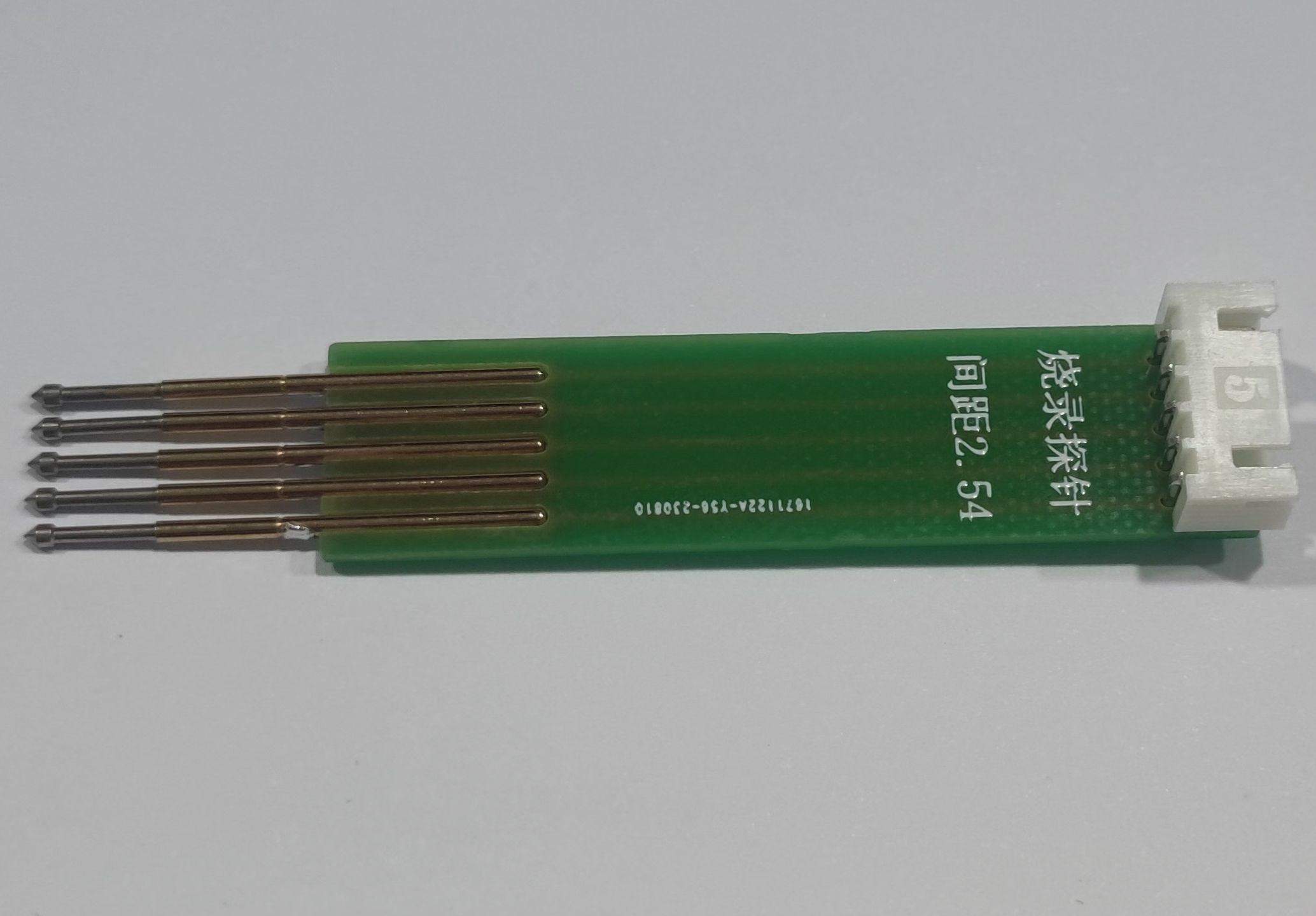

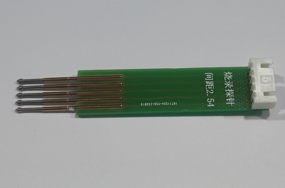

Recently, updating programs has been a hassle, requiring constant soldering. I decided to create a programming probe to simplify the programming process!
Below, I'll describe the drawing, materials, soldering, and manufacturing process:

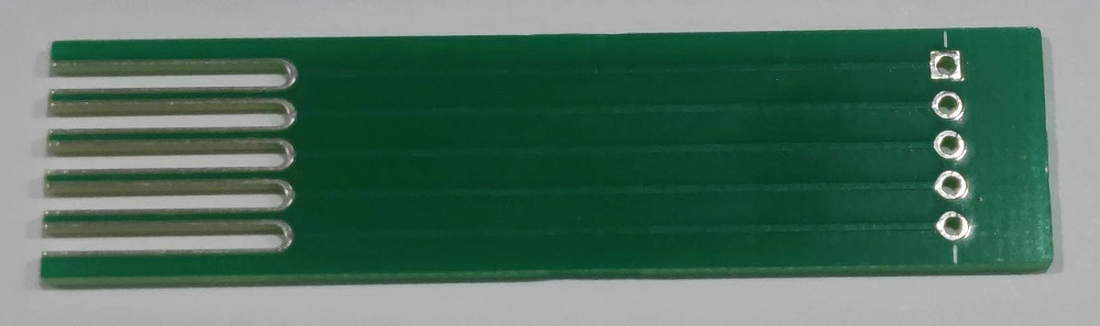

1. Schematic: Haha, this board only has 5 wires, so a schematic isn't necessary, right?
2. PCB: On the left, I drew 5 pads, which I modified into 16*2mm oblong shapes with 1.38*15mm drilled holes.
                The 5 wires in the middle connect to the terminals on the right; 1mm wire diameter is recommended.
                The right side uses 2.54mm pitch angled terminals, which are common and easy to find.
3. Probe: I used P100 probes, a common and inexpensive type.
4. Terminals: 2.54mm 5P terminals
. 5. Finished Product
: The assembly is simple; just add heat shrink tubing. It's still on its way; I'll add pictures when it arrives.
