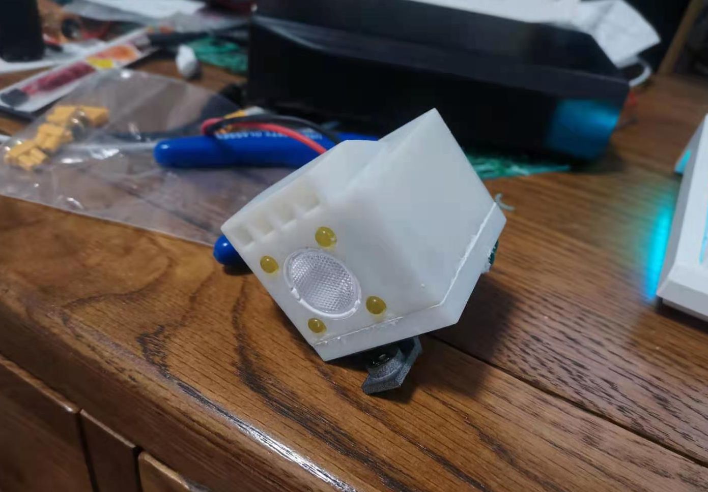

High-brightness cycling lights
Foreword: There's a slight issue with the handlebar connector in the 3D file, and the program may have some bugs. Everything else is safe to use; it has been verified
. 1. Description:
This product is a lighting fixture primarily used for front lighting while cycling, as well as other general lighting applications. It includes active cooling, temperature control, and waterproofing for use in harsh environments. It supports both analog input and digital control.

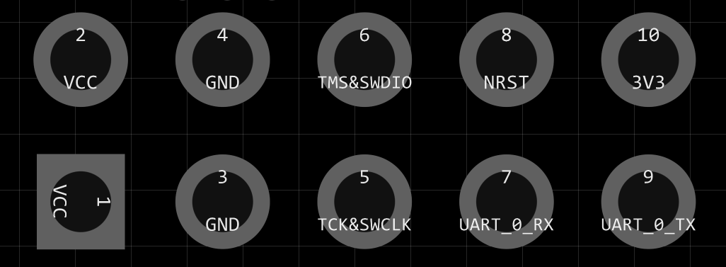

2.1 Pins
2.2 Pin Descriptions
Pin Number
Pin Name
1, 2
VCC
Main Power Supply
3, 4
GND
Power Ground
TCK&SWDIO
Internal Microcontroller TCK&SWDIO, used for debugging
TMS&SWDIO
Internal Microcontroller TMS&SWDIO, used for debugging
UART_0_RX
Internal Microcontroller Serial Port RX, connected to TX if using CNC, otherwise left floating
NRST
Internal Microcontroller NRST, pull-low reset, includes a 10K pull-up resistor and a 100nF capacitor
UART_0_TX
Internal Microcontroller Serial Port TX, connected to RX if using CNC, otherwise left floating
3V3
Directly connected to the internal 3.3V power supply, can be output externally. During debugging, it can be powered by this.

4.1 Lighting:
Utilizes 5050 packaged LED beads, with a maximum power consumption of 10W and a maximum brightness of 990lm.
4.2 Temperature Control and Heat Dissipation
: This product features temperature control and active cooling. The fan starts at 50℃ and increases in speed as the temperature rises, reaching its maximum speed at 60℃. Output power begins to decrease at 65℃, reaching its lowest point at 70℃. If the temperature exceeds 70℃, the output is forcibly shut down. The fan's operation can also be forcibly controlled; see 4.3 Control for details.
