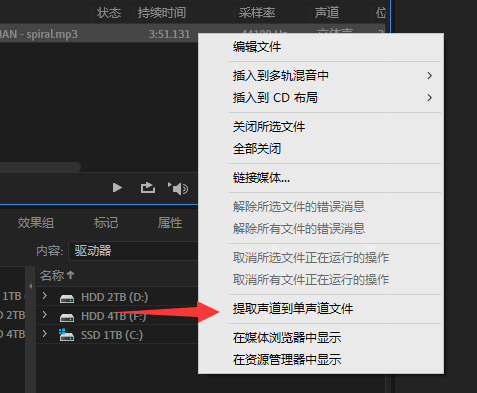

If you don't have a PCB but can use AU for theory, it's simple.
First, import an audio file, then separate its left and right channels
into L/R.

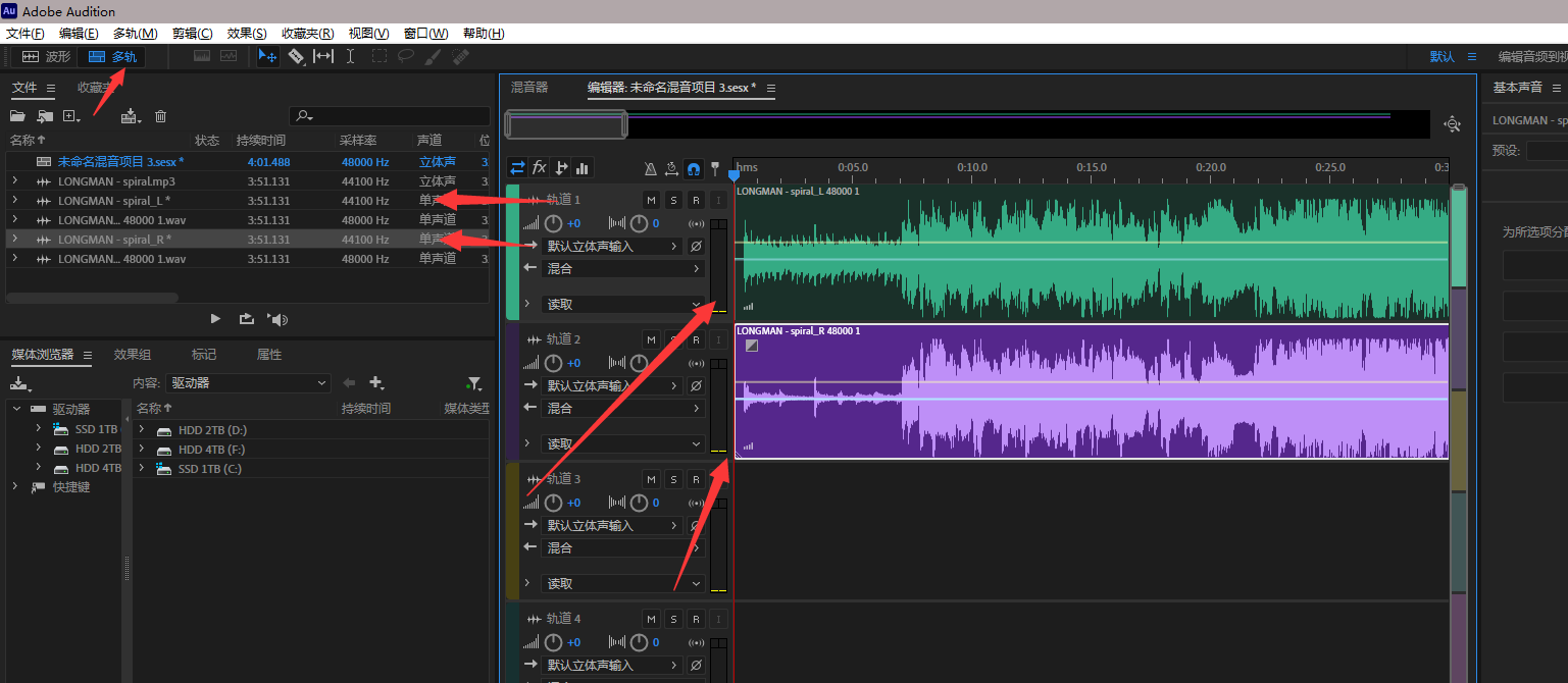

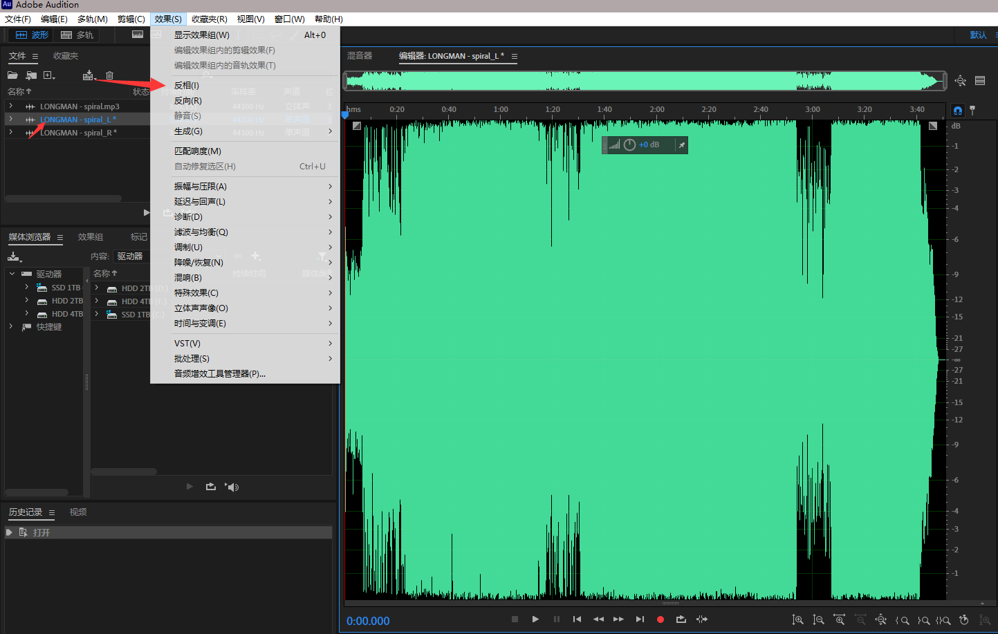

Then, open one channel and use the phase inversion effect (not reverse, but the L channel).
Then, create a new multitrack and mix the inverted L channel with the separated R channel.
The result will be a sound without vocals, only the accompaniment and harmonies.

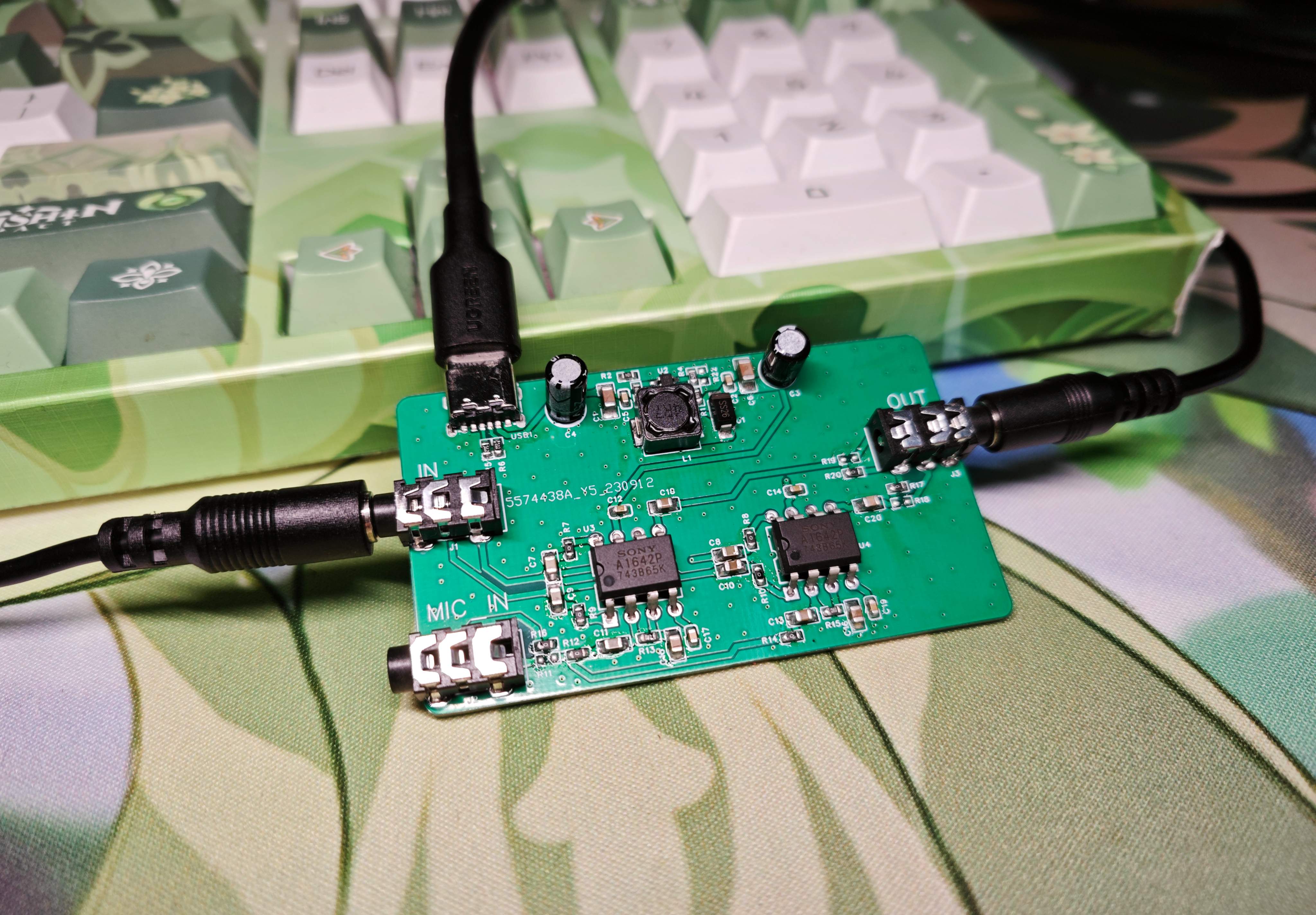

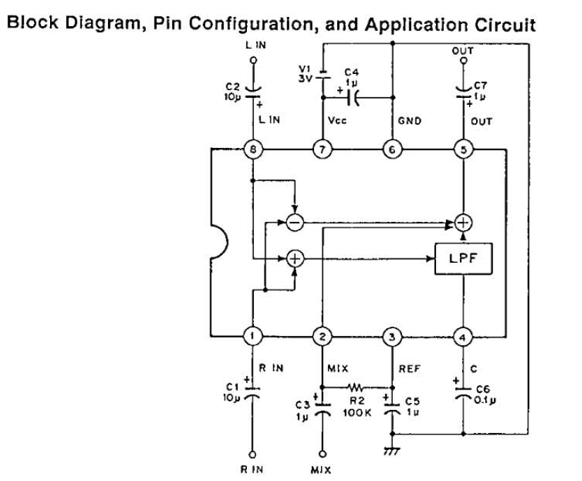

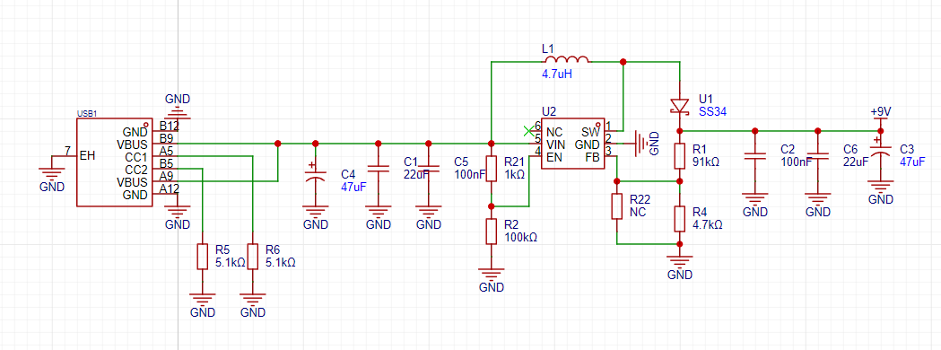

4. Circuit:
As mentioned in the previous sound cancellation method, this method will eliminate elements with similar properties to vocals, such as drums and bass in the accompaniment, which are low-frequency instruments.
Therefore, we only need to create a low-pass filter on one channel of the original music to obtain the bass, and then mix the music with the bass after the vocals have been removed to better preserve the low-frequency part.
The CXA1642P has already integrated this function internally.

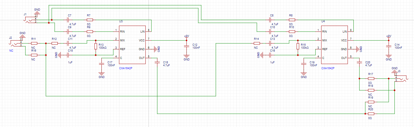

The drawback also mentions that the noise-removed output is a single-channel mixed music;
the left channel is inverted and mixed to the right channel, resulting in the right channel accompaniment. Therefore, by adding another channel, inverting the right channel, and then mixing it with the left channel, a stereo accompaniment can be produced. Thus, two CXA1642Ps are sufficient.
However, since it is a stereo effect produced by mixing two mono channels, the stereo effect is weak or almost non-existent.
A 5V to 9V boost circuit was previously commonly used, such as the SX1308

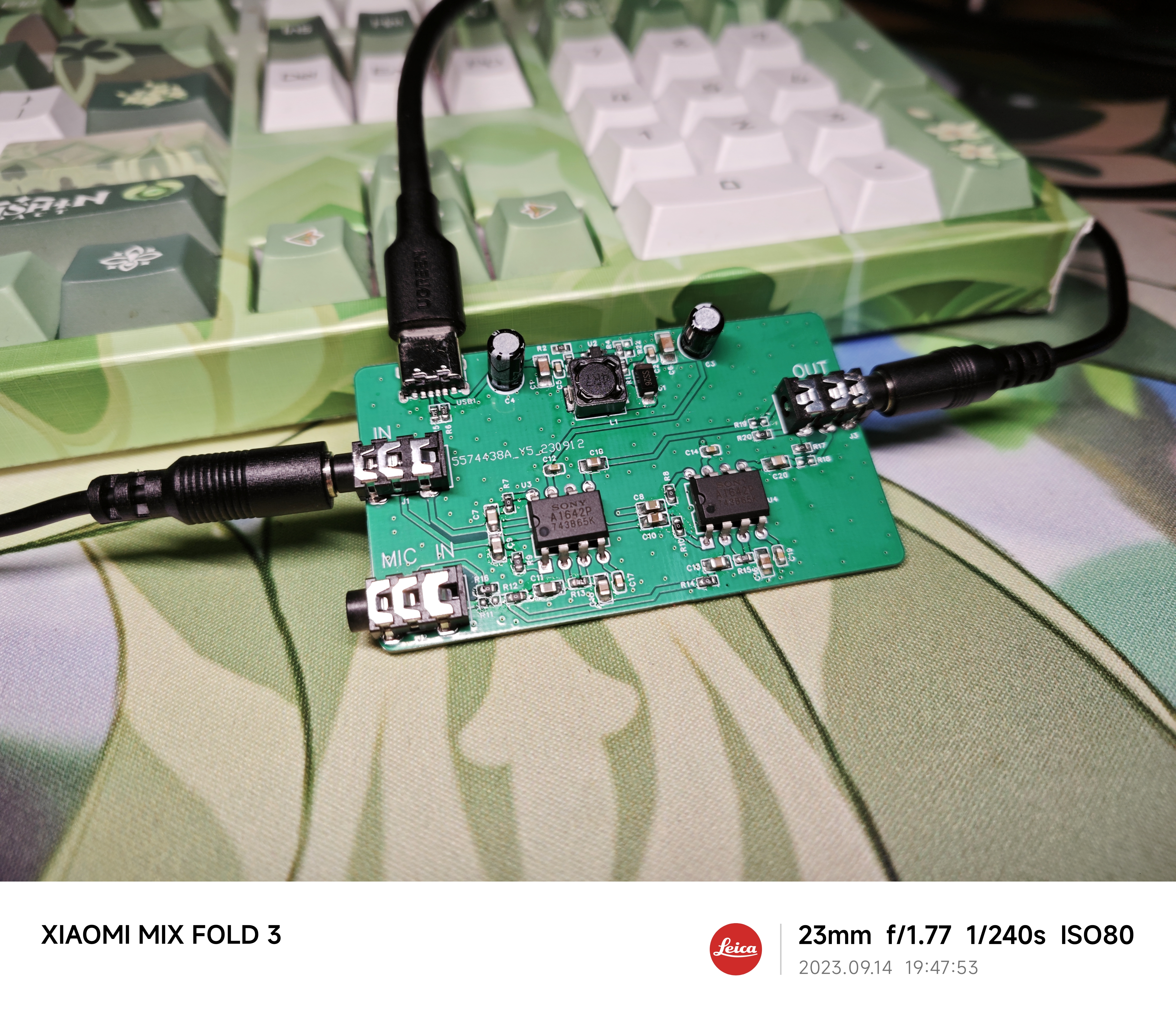

. 5. The actual effect
is playing "The Tower of Flowers," noise-removed,
with microphone effects and reverb: https://oshwhub.com/aknice/pt2399
