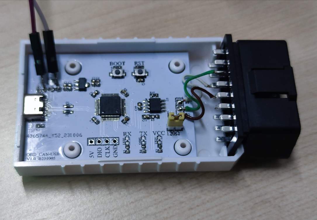

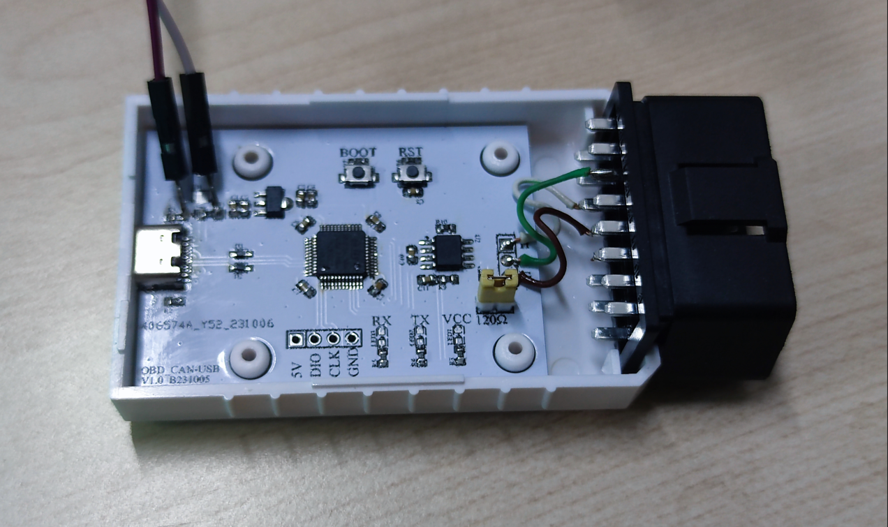

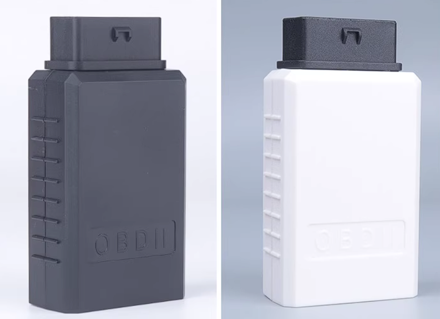

The board in this link: USB-CAN is the same, only the shape is different. It can be installed in a case with an OBD interface.
After installation, you need to cut a hole for the Type-C port. My plastic case is quite soft, so I used a utility knife to carefully cut it out, being careful not to cut myself.
After installation, you can test
the known issues:
1. The data transmission indicator light does not illuminate;

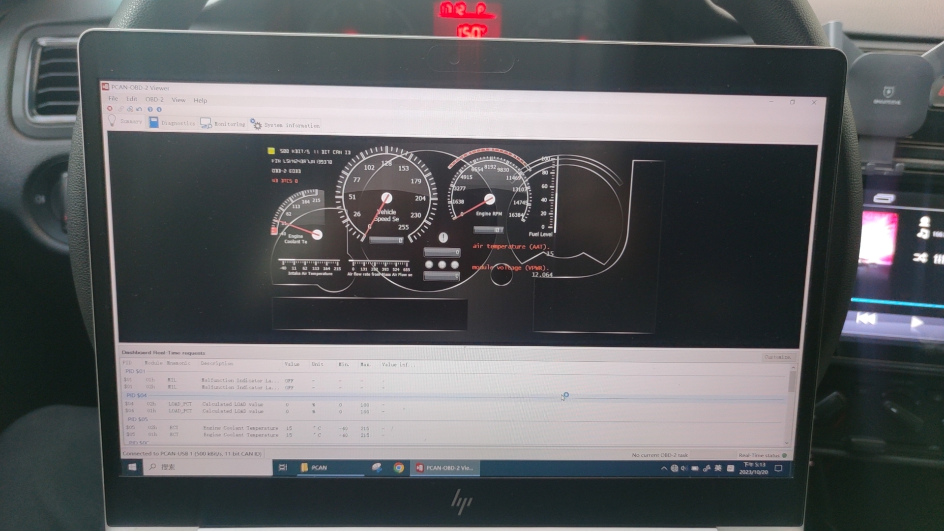

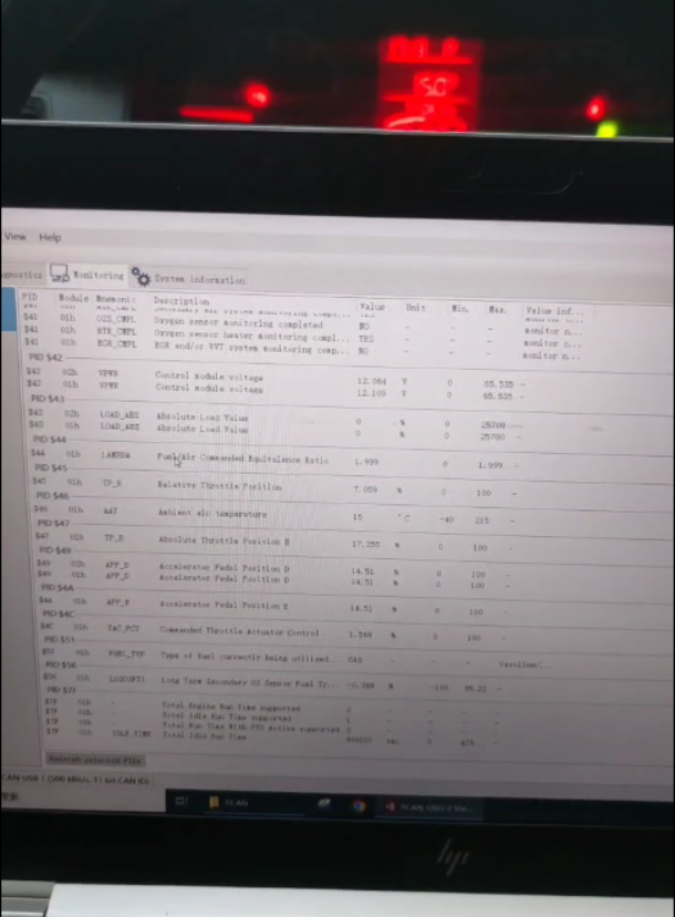

2. When plugged into the car and tested with POBD2View software, some data can indeed be read, but the data only changes once during connection and the connection is unstable, not always connecting to the ECU. I wonder if there are other host computers that can read ECU data.
