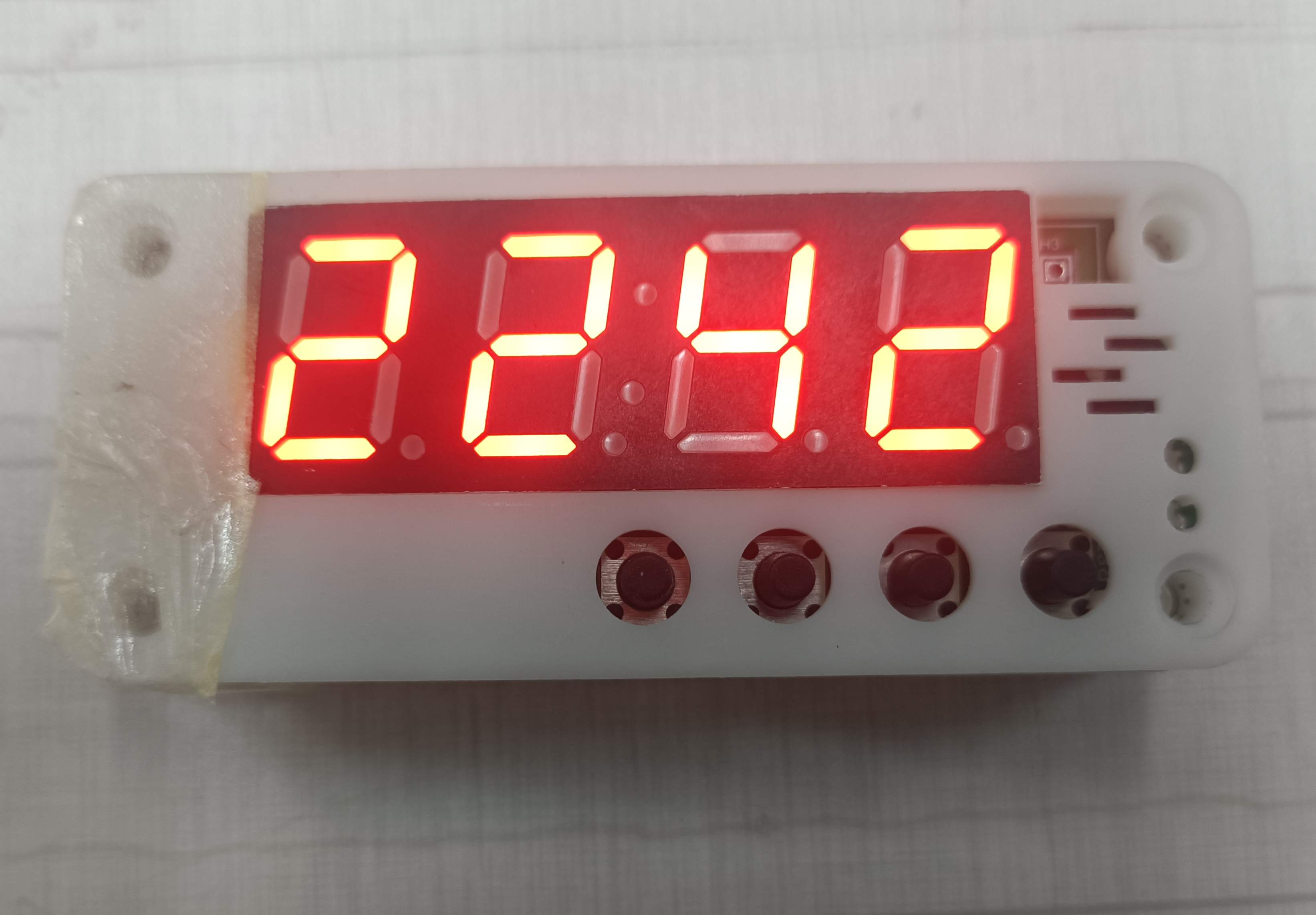

* 1. Project Functionality:
A desktop clock displaying time, date, etc., powered by an external battery, utilizing hardware-based solutions whenever possible.

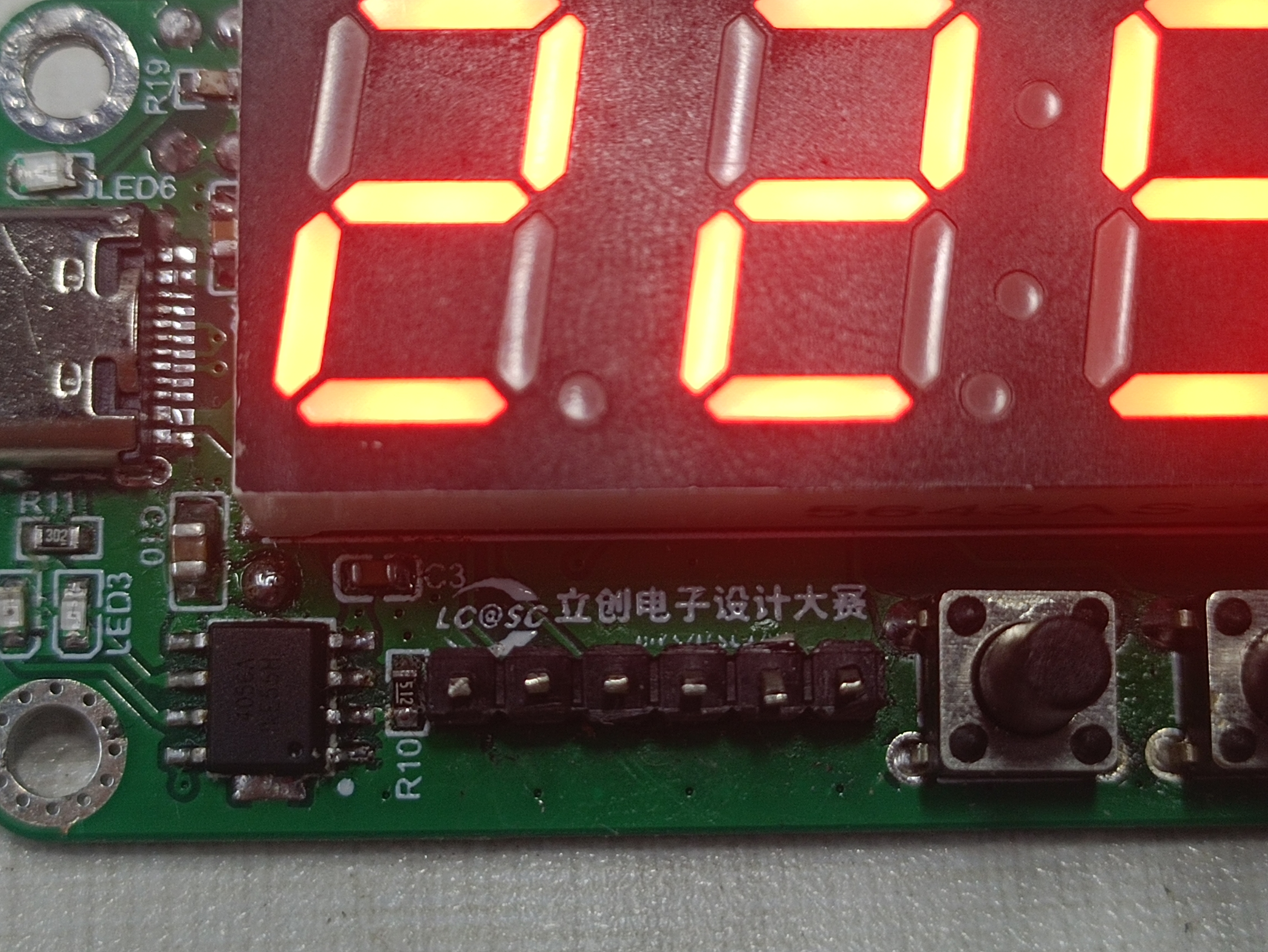

*4. The hardware
uses the original schematic, but the lithium battery charging chip has been changed. An onboard CH340 programmer has been added, allowing for direct programming via USB without a traditional programmer. The programmer uses a separate self-locking switch for easy firmware updates.
The PCB is a four-layer board, using my casing. The PCB thickness is 1.2mm. The battery size and
touch buttons use my custom 6x6mm touch buttons. If you don't have a suitable alternative, you'll need to modify the touch point openings.
Regarding the casing: the openings on the DHT11 are too small, causing the buttons to protrude after installation; the front button openings are too large and need to be adjusted to fit your desired button size.
