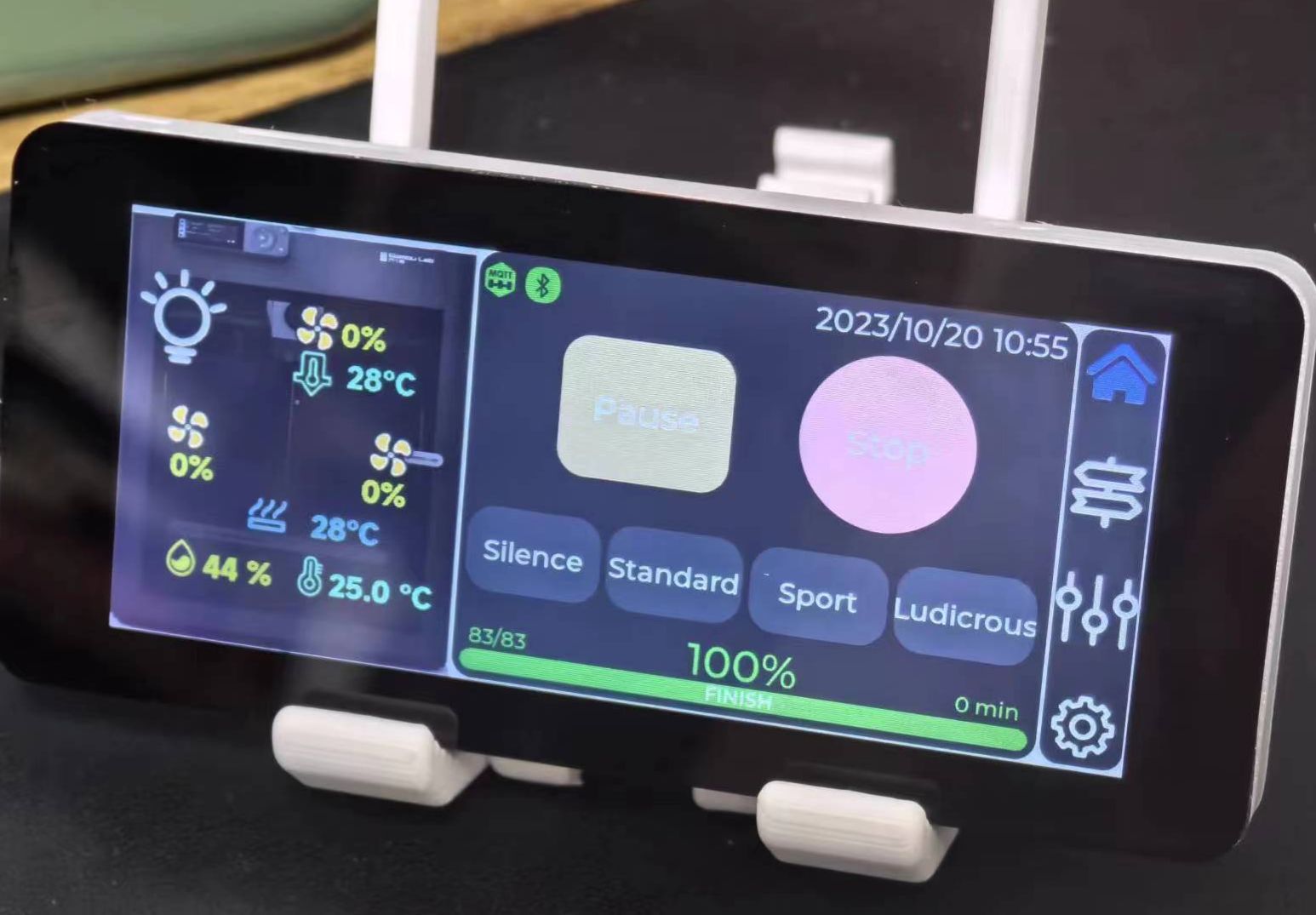

Solution Summary:
1) Uses an ESP32S3 as the main controller for Wi-Fi and Bluetooth connectivity.
2) Interacts with the Tuozhu 3D printer via MQTT to display device status and control the device.
3) Connects with a Xiaomi temperature and humidity sensor via BLE to display sensor data.
4) Uses a 3.99-inch Huaxian screen.
Program Highlights:
1) Developed using PlatformIO + LVGL.
2) The LVGL interface is developed using Squareline Studio.
Bilibili Discussion: https://www.bilibili.com/video/BV18w411C7WE/?vd_source=2d0391dce6e52ab32733253b9cd095f0
Note: The program is not yet fully completed!
