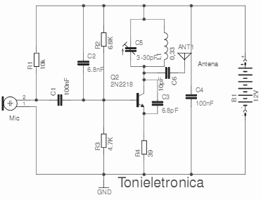

This low-power FM transmitter can transmit over 1 kilometer under good conditions. Modulation can be done via a microphone or audio source. The power FM transmitter circuitry is built around a 2N2218 transistor. The transmitter coil is a 5-turn 22 AWG enameled wire, 1 cm in diameter, without a magnetic core. Note that the capacitor should be ceramic. The antenna length should be 15 to 40 cm. For transmission, place an FM receiver (radio) close to the transmitter, turn the volume to half, and on an idle frequency (without other stations operating), use a wooden or plastic key to rotate the screw of the variable capacitor (CV) to capture the transmitter's frequency.
If installation is difficult, remove the coil and rewind it, with varying numbers of turns. Refer to the pinout of the 2N2218 transistor. Mic1 is a dual-ended electret microphone; resistor R1 is used for microphone bias and may need adjustment to suit your microphone; values from 1k to 10k are acceptable. A fiberglass board is preferable, as it is suitable for high frequencies. For better frequency stability, the antenna may need to be placed on the second turn of the coil; solder the antenna piece to the second turn of coil L1.
Below is one of the schematic diagrams for an FM transmitter circuit.

5% 1/4 W resistor:
R1 = 3 to 10kΩ (black, black, orange, gold)
R2 = 6.8kΩ (blue, gray, red, gold).
R3 = 4.7kΩ (yellow, purple, red, gold).
R4 = 39Ω (orange, white, black, gold).
ceramic capacitors
C1 = 4.7 nF (472 or 4n7 or 4700)
C2 = 2.2 nF (2200 or 2n2 or 222)
C3 = 4.7 pF (4p7 or 4.7)
C4 = 100 nF (100n or 0.1 or 104)
C5 = Fine-tuning capacitor CV 3-30 pF.
transistor:
T1 = 2N2218 or equivalent model number.
other:
L1 = See text
B1 = 9-volt alkaline battery.
Mic1 = electret microphone.
Other = Printed circuit boards, antennas, boxes, etc.

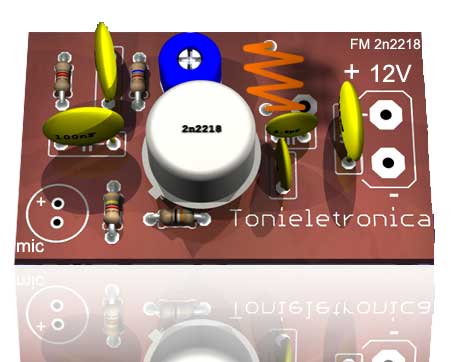

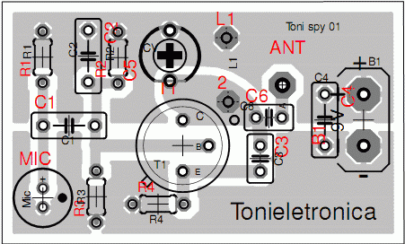

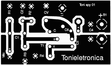

FM transmitter circuit board copper ratio 3:1
FM transmitter circuit board component side
