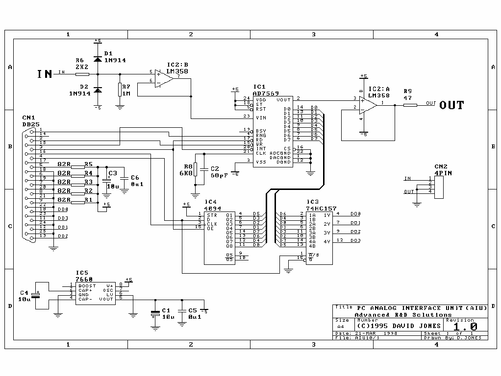

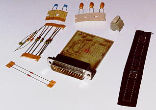

Simple PC data acquisition circuit
If you need to add simple data acquisition capabilities to your PC, then look no further; the Analog Interface Unit (AIU) is your best choice. An AIU is a simple circuit that connects to the PC's parallel port, allowing you to sample and output 8-bit analog signals under software control.
Here are some features:
* 8-bit analog-to-digital converter (ADC) and digital-to-analog converter (DAC)
Power supplied from the parallel port
* 1 megohm input impedance.
* Software-selectable +/-1.25V or +/-2.5V input and output ranges.
