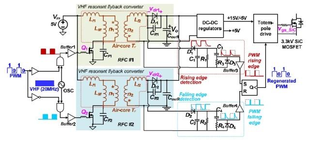

    Schematic diagram

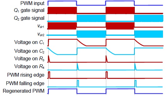

    Figure 2 shows a schematic diagram of the proposed solution. On the primary side, the PWM signal is modulated with a VHF signal (20 MHz) to generate gate signals for two RFCs. The first RFC is active when the PWM signal is high (1), while the second is active when the PWM signal is low (0). Regardless of the PWM duty cycle, the output voltage VO of both stages maintains a constant DC value. Therefore, the power received by the secondary side is independent of the PWM duty cycle.
    On the secondary side, two envelope detectors connected to the anodes of diodes DR1 and DR2 detect the on/off state of the RFC. These edge-detected signals are then buffered as PWM rising and falling edges and sent to the RS bi-stable, which regenerates the PWM signal. A non-isolated DC-DC regulator connected after RFC 1 provides the required +5V, +15V, and -5V drive voltages for the secondary-side signal processing circuitry.

    Figure 2: Schematic diagram of the proposed GD solution
    The relevant waveforms are shown in Figure 3.

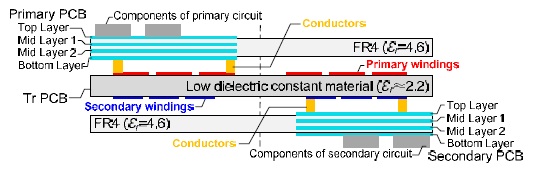

    transformer
    The PCB-based air-core transformer design, shown in Figure 4, offers the advantage of eliminating core losses and potential insulation issues between the windings and the core. It utilizes a stacked PCB structure, comprising a primary PCB, a transformer (Tr)-PCB, and a secondary PCB. The transformer windings have a spiral shape to simplify the design. The Tr-PCB has only two layers, with the primary and secondary windings located on the top and bottom layers, respectively. With this solution, insulation is entirely provided by the Tr-PCB's dielectric material (typically low-cost FR-4).
SiC MOSFET isolated gate driver with PCB based transformer
    Figure 4: Structure of a PCB-based transformer
    To increase the dielectric breakdown voltage and reduce the coupling capacitance, materials with high dielectric strength and low dielectric constant can be used. The authors used Arlon-DiClad-880 material, which has a dielectric constant of 2.2 and a dielectric strength greater than 45 kV/mm. The simulated coupling capacitance determined using the Ansys Q3D extractor tool was approximately 5 pF for several transformers.
    The creepage distance between the coated primary and secondary windings is greater than 30 mm × 2. This ensures an insulation voltage of 15 kV RMS according to IEC-61800-5-1-2007.

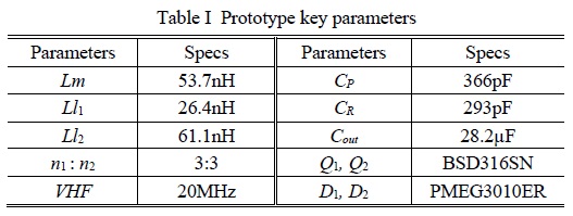

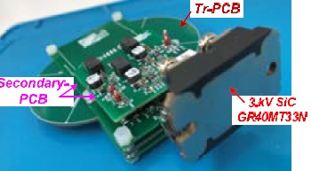

    Figure 5 shows a schematic diagram of the prototype used for testing, which was built in the laboratory using the components listed in Table I.
    Table 1: List of components used in the prototype

    Figure 5: Prototype diagram

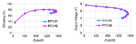

    The RFC's maximum output power was measured at 1.5W@17Ω resistive load, sufficient to drive a 3.3kV SiC MOSFET (GR40MT33N). A graph of efficiency and RFC output voltage (VO) is shown in Figure 6. Both RFCs maintain stable output characteristics across the entire load range (0.12W-1.5W).
    Figure 6: Efficiency and RFC output voltage

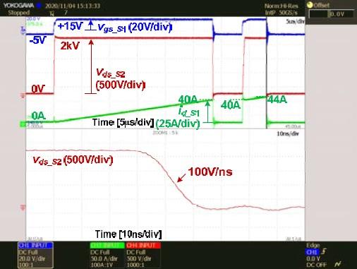

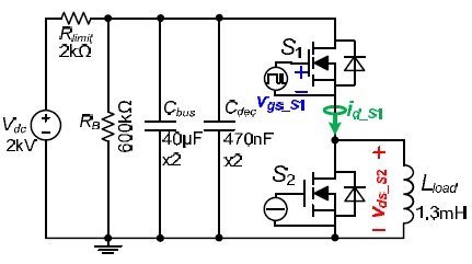

    In addition, a double pulse test (DPT) is implemented to evaluate the performance of the proposed GD. The schematic diagram of the DPT test bench is shown in Figure 7.
    Figure 7: Schematic diagram of the DPT test bench
    The GD drives switch S1, requiring high isolation voltage and noise immunity to high dv/dt. Figure 8 shows the DPT waveforms for Vdc = 2kV, id_S1,max = 44A, Lload = 1.3mH, and Rgon/Rgoff = 2.2Ω/5Ω. It can be seen that the maximum dv/dt achieved by the 3.3kV SiC MOSFET corresponds to a safe value of 100V/ns. The same GD solution can also be used for other high-voltage SiC MOSFET devices.
    Figure 8: Experimental waveform
