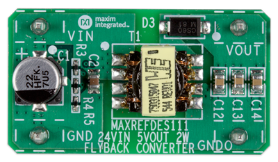

MAXREFDES111# is a high-efficiency flyback topology 24V input, 5V/2W output (0.4A) power supply design. The design uses the MAX17498B, a peak-current-mode converter with an internal n-channel MOSFET switch. The entire circuit uses a 36mm x 20mm (1.4in x 0.8in) circuit board.
functional isolation
Compact and flexible
Minimal number of external components
Works reliably in harsh industrial environments
5V 400mA, 20% overload current range
±5% output accuracy
