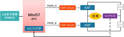

Single-burner stove/double-burner stove
  • An Introduction:
    • Arm® Cortex®-M0, up to 48 MHz, can quickly detect, adjust power and safety protection in real time
    • Built-in 12-bit 6-channel ADC, 2 comparators
    • Multi-channel accurate detection: grid voltage, current, IGBT temperature, wire reel temperature, pot bottom temperature, zero-crossing detection, etc.
    • Built-in 48 MHz 16-bit 6-channel PWM (complementary with dead zone)
    • Efficiently control IGBT switches to improve efficiency and extend service life
    • Adjustable dead zone, compatible with a variety of IGBTs
Nuvoton Single-head stove system schematic diagram_SC
  • Security protection mechanism:
    • Over-temperature, over-voltage, over-current, surge and other output protection
      (external signals can switch PWM on and off and set the output state to achieve fast protection)
    • Centralized control and coordinated distribution of total power
Nuvoton Single-head stove system Safety protection mechanisms_SC
