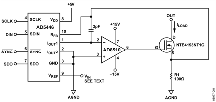

Each circuit has two levels. The first stage is the input stage, which is composed of DAC and operational amplifier. The second stage is an N-channel MOSFET transistor output stage (Figures 1 and 2), which provides current in response to the digital word sent to the system.
As shown in Figure 1, the input stage of the circuit consists of a current output DAC (AD5446) and an operational amplifier ( AD8510 ). It converts the command word and drives the transistor, in addition to modulating the voltage applied to the single resistor. Command words are sent through the SPI interface.
The output stage consists of an N-channel MOSFET transistor ( NTE4153N ), which can provide higher current than the op amp and single resistor output. Single resistor R1 produces current when voltage is applied to its pin. A transistor regulates this current.
The load current is:
CN0151_image1
where D is the decimal representation of the digital word loaded into the DAC. However, R DAC >> R1 (R DAC is nominally 9 kΩ), so the load current can be approximately expressed as:
CN0151_image2
When R1 = 100 Ω and V IN = 5 V, I LOAD is programmable from 0 mA to 50 mA with a resolution of 3 μA (1 LSB at 14 bits). The output supply voltage is approximately 20 V, limited by the MOSFET transistor breakdown voltage. The ADR425 is a low power 5 V precision reference that is ideal for this circuit.
