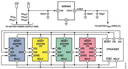

The circuit shown in Figure 1 provides a high dynamic range 4-channel simultaneous sampling system with high crosstalk isolation and flexible sampling rates, requires few external components, and can be easily connected to a DSP or FPGA. This circuit uses a daisy-chain configuration of four AD7765 Σ-Δ ADCs , so the number of connections to the digital host is minimized. The AD7765 fully integrates differential input/output amplifiers and reference buffers, significantly reducing the number of external components required.

Figure 1. Four AD7765 ADCs daisy-chained for simultaneous sampling (schematic diagram, decoupling and all connections not shown)
Circuit description

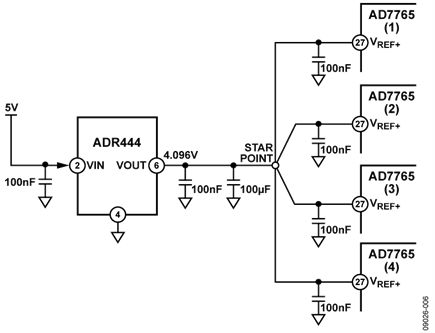

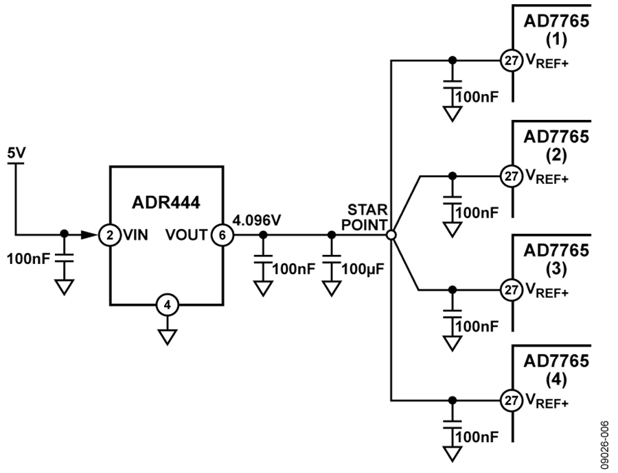

Each AD7765 is clocked using a common sample clock (MCLK), synchronization signal ( SYNC ), and reset signal ( RESET ), as shown in Figure 1. The 4.096 V common reference voltage provided by the ADR444 (using the circuit shown in Figure 5) is applied to each AD7765 in a star single-point configuration (each ADC has a built-in reference voltage buffer).
A RESET pulse is applied to all devices at power-up (the minimum low time of the pulse is 1 × MCLK period). The rising edge of RESET (which takes the ADC out of reset) is applied to each AD7765 to synchronize with the falling edge of MCLK. A SYNC pulse (minimum low time 4 × MCLK periods) is then applied to all AD7765 devices, which gates the AD7765's digital filter (when it is logic low). On the first MCLK falling edge after SYNC returns to a logic high level, the AD7765's digital filter begins processing samples internally.

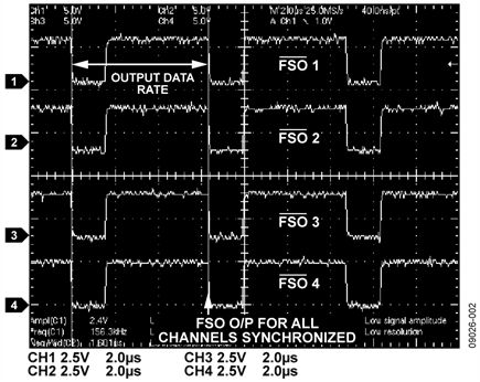

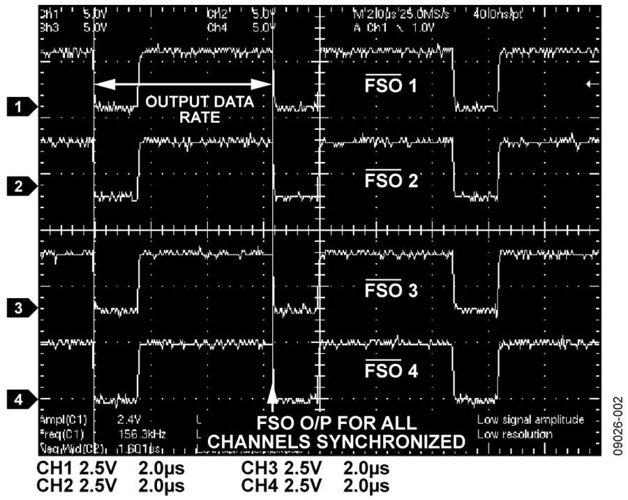

    2. Ensure that the data output of each device's SDO pin is synchronized ( the FSO falling edge of each ADC is synchronized), as shown in Figure 2.
    Once all devices are synchronized, all ADCs can be configured. Daisy chain operation requires all ADCs to use the same decimation rate (controlled by pin 18) and power mode (controlled by writing to control register address 0x0001) settings to ensure synchronous data output from each device.
    Figure 2. Oscilloscope plot of FSO for each AD7765 channel, simultaneously sampled at an output data rate of 156 kSPS.

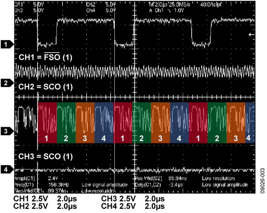

    Only one FSO (Frame Sync Out) signal is applied to the digital host as an interrupt for reading data from the daisy chain ( FSO (1)). This signal is the frame signal for all four channels. The data format read back from the digital host (FPGA or DSP) is shown in Figure 3. The conversion data and status bits of AD7765 (1) are output first ( FSO (1) is active low during this period ), followed by the conversion data and status bits of AD7765 (2), (3), and (4). Note that FSO (1) is logic high when data results are output from the remaining converters in the daisy chain .
    The next time FSO (1) transitions from logic high to logic low, it indicates that the next set of sample points for all four channels is available for readback. The digital host needs to start the readback on the falling edge of FSO (1) and read back 4 × 32 bits, or 128 bits, from the SDO (1) serial output. The data output on SDO (Serial Data Output) is synchronized with the SCO (Serial Clock Output).
    Figure 3. Daisy chain: reading data. Digital interface from AD7765 (1) to FPGA. The data of each channel is represented by color and number. Output data rate is 156 kSPS (1/128 decimation)

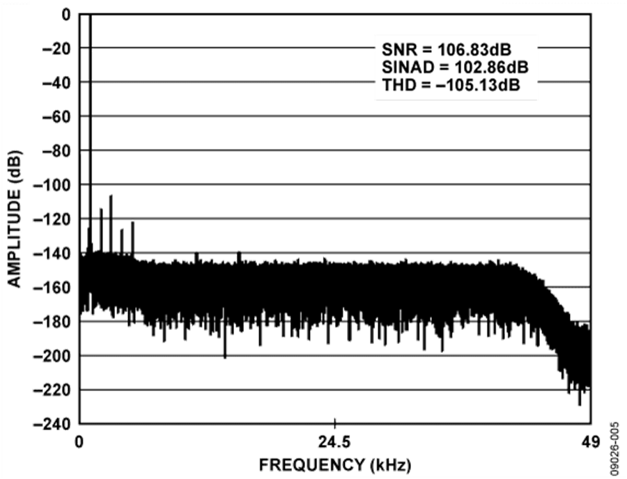

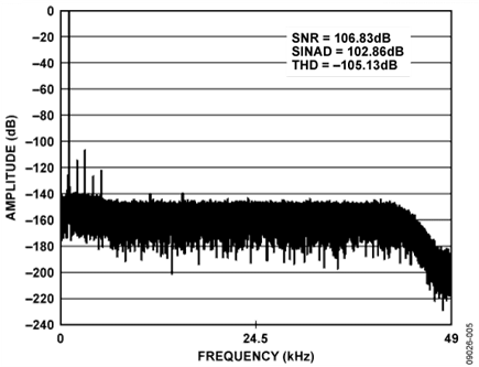

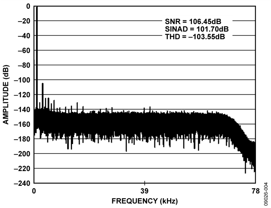

    The AD7765 daisy chain circuit allows the user to simultaneously sample up to 4 channels at an output data rate of 156 kSPS. The output data rate can be changed by reducing the MCLK frequency or changing the decimation rate of the AD7765. After changing the decimation rate, it is recommended to resynchronize these ADCs. Figure 4 shows the output FFT of the AD7765 (3) operating at a maximum sampling rate of 156 kSPS and a MCLK frequency of 40 MHz. A −0.5 dBFS input signal is applied to the differential amplifier input of the AD7765 at a 1 kHz input frequency.
    Figure 4. FFT output of 1 kHz input signal: 156 kSPS sample rate, 40 MHz MCLK, 100 μF reference star single-point capacitor, 131,072 sample points

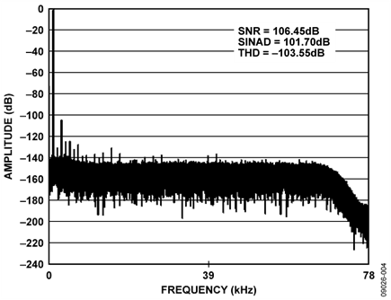

    Figure 5 shows the output FFT of the AD7765 (3) operating at a sampling rate of 97.65 kSPS, a MCLK frequency of 25 MHz, and an input signal of 1 kHz (−0.5 dBFS). Table 1 lists the performance of the AD7765 in 40 MHz, 30 MHz, 25 MHz, 20 MHz, and normal power modes.
    Table 1. Performance versus reference voltage star single point capacitance. AD7765 uses 1/128 decimation rate, normal power mode, −0.5 dBFS 1 kHz input signal

    The signal source is Audio Precision SYS2522 analog output, balanced GND, 7.699 V pp output, 40 Ω output impedance, high precision mode. The analog inputs are applied directly to the AD7765's integrated differential amplifier. The number of FFT sampling points is 131,072.
    Figure 5. FFT output of 1 kHz input signal: 97.65 kSPS sample rate, 25 MHz MCLK, 100 μF reference star single-point capacitor, 131,072 sample points

    Reference voltage configuration
    The ADR444 provides a 4.096 V reference voltage for each AD7765 device in this circuit. One of the advantages of the AD7765 is the on-chip integrated reference buffer, which isolates the user from the internal reference sampling circuitry. This means that when multiple devices share the same reference voltage, no external buffer is required. The star single-point configuration shown in Figure 6 allows the reference voltage to be applied to each ADC from a single point through parallel traces. This is a best practice to minimize potential interactions between ADCs. The reference voltage is tapped serially to each device from a common reference voltage trace. Additionally, an on-chip reference buffer isolates the internal dynamically switched capacitive load from the single point of the star.
    Figure 6. Test conditions for reference voltage configuration
