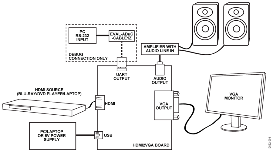

During board evaluation, use the UART connector EVAL-ADuC-CABLE1Z to display the evaluation board's programming information, debugging information, and the EDID content of the VGA monitor. EVAL-ADuC-CABLE1Z is an RS-232 level converter that allows interface between LVTTL and RS-232 logic levels.
The test requires connecting the cables shown in Figure 3 (VGA, HDMI, audio out, and USB) and pressing the reset button.
Consumer video players (DVD or Blu-ray) generally do not support VESA video resolutions such as XGA, SXGA or UXGA. During testing, these sources output standard VGA.
The Dell E6520 laptop can be used as a video source, it natively supports the VESA standard and correctly reads back content provided by the HDMI2VGA converter. It outputs 1280 × 1024/60 Hz to a Dell 1908FP monitor, or 1600 × 1200/60 Hz to a Dell 2007FP monitor.
Both video players can provide LPCM audio content for EDID and can decode and output data from the audio codec normally.
Figure 3. Test setup block diagram
